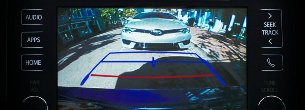

    Anyone know how to get program or zero the guildlines on the screen while backup? Seems my isn't perfectly aligned. My truck is always in angle while i use the guildines to park.

    I don't think there is any way to adjust those lines on a stock head unit.

    If you remove the tail gate cover you will be able to adjust the camera. It will be able to move side to side so you can fine tune it. It will be a bit of in and out of the truck checking the screen and then making adjustments to the camera. You can line up some items on the floor as a guide to get as accurate as possible.
