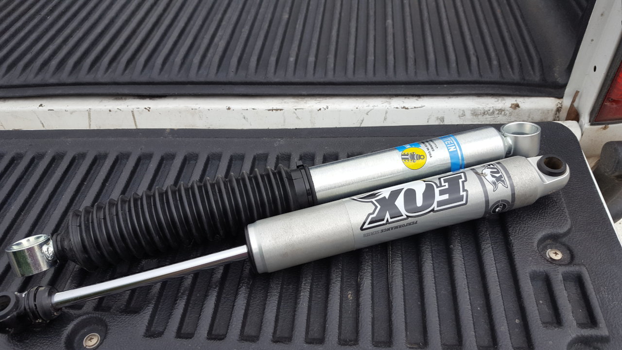

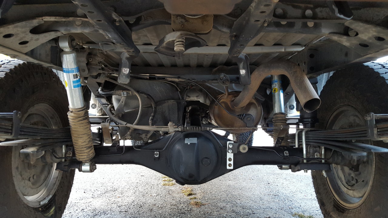

    Did you get the correct Fox rears for your truck?
    There are a few variants that fit, yet some are valved for heavier trucks.
    When I installed my Fox 2.5 fronts and 2.0 rears, I felt exactly what you are experiencing. However I knew this going in because I opted for longer-than-Tacoma length shocks for the added travel.
    For that reason, I bought a set of 5100's as well to throw on during light loads.
    Here were the Fox in the rear -
    And the weight on my truck -
    When that weight came off, I'd throw on the Bilsteins -
    This is how light I'd run with them -
    The shocks side by side -
    Didn't bother me to swap them since I would really only run the Fox when I needed to load heavy and be gone for several days.
    Only takes like 5 minutes to remove and replace rear shocks anyway.
