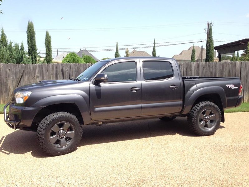

    I currently have Bilstein 5100s (set at 1.75") with stock coils up front and stock setup in the rear (with Firestone ride rite airbags and TSB 4-leaf springs) on 265/70/17 BFG KM2s.
    I've been thinking about setting the Bilsteins to 2.5" to gain a little more lift in the front and then adjusting the rear airbags accordingly to level out the truck.
    Currently, I run about 20-25psi in the bags and it seems to do the trick as far as leveling out the truck.

    Keep your billies, set them at zero with OME 885's. $170 and you're done. Ride will be better than what you have now and you'll be at 2.5". Shouldn't need UCA's but wouldn't hurt if you've got the funds.
    Not sure about the airbags being used for lift though :notsure:
    Truck looks sick man!

    So, OME 885 springs with the Bilsteins set at zero will give me the 2.5" lift I'm looking for?
    I'm not sure about the airbags being used for a lift also, but I've been running them at 20-25psi since I installed them, and they gave me about an extra inch lift in the rear. Also, I already have the TSB rear leaf pack.
