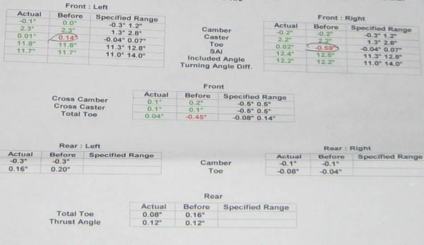

    I have been fighting my steering wheel for some time now. My truck pulls to the right and its very annoying. My old tires wore out prematurely. The inside edge of the right front tire was worn flat and the outside edge of that tire had good tread left.
    I after getting new tires I had Sears align it. They gave me a print out and told me they adjusted the toe (adjusted tie rod ends).
    Driving away I notice that the truck still pulls to the right. Same as before! Sears employees keep telling me that they cannot make any more adjustments because all of the numbers are within specs. If they adjusted camber or toe it would be out of alignment.
    After reading this article I have determined the problem to be the negative camber. The picture of the "Camber wear Pattern" looks exactly like my old right front tire. Maybe on a lift at a shop I don't have neg. camber but on the road at highway speed, I think I do.
    Is there any way to correct my negative camber at home?
    Here is a copy of the printout they gave me at Sears.

    If an allignment shop can't adjust it, ....you're not gonna be able to do it at home.
    I would start looking for some mechanical issues - worn parts, etc.
    What kind of tires are you running? How many miles do you have on them?
    If it pulls to the right, I'd start looking at the right side suspension & steering components. Jack the truck up and do some investigating.

    Your tires wearing could also be due to a toe issue. Pulling usually persists with the caster. The best thing to do would be to take it to a different alignment shop. Stay away from the big places like sears. Find you an older shop that the guys have been doing it for a while.

    So you do have new front tires just to be clear correct? A slightly warn tire that is unevenly warn can cause these issues even when the alignment is dead nuts. I recently did 5100's on my truck to lift the front and level it. The camber was off and when I took it to be aligned the guy said afterword he had to take it off the rack three times to drive the truck and let the suspension settle. Perhaps they didn't drive it and then re-check. Take it somewhere else and hopefully you'll have better luck. Cheers

    A good alignment tech should know what a correct alignment needs to be with out a computer telling it certain specs. Sounds like you have negative Camber on that tire. The vehicle will pull in the direction of more positive camber. Since only one tire is having wear problems then it is a camber issue and not a Toe issue, Toe will wear both tires equally. Go to a better Alignment shop. Toyotas are a piece of cake to align.

    Ok I just went over your print out again. Your Alignment looks great. Your truck should be driving straight down the road with no tire wear issues. Considering that. I think you have another issue. Possibly a bad ball-joint or a Sticking caliper. Something that would cause it to pull to the right and make you counter it with steering to the left. Which will cause tire wear. Shake down the front end for play in the ball joints or bushings, and make sure you dont have a caliper that is dragging.

    Thanks for the advice. I checked the front brakes, both sides have the same amount of pad left. After 10k miles of dragging I think I would see a difference if this was the problem. Ball-joints and bushing have no "visible" problems. But just looking at it doesn't mean much...
    I guess I just have to find a mechanic I trust. I have never taken my truck to a mechanic or the dealer (other than the Sears alignment and tire install). I have always done everything myself.
