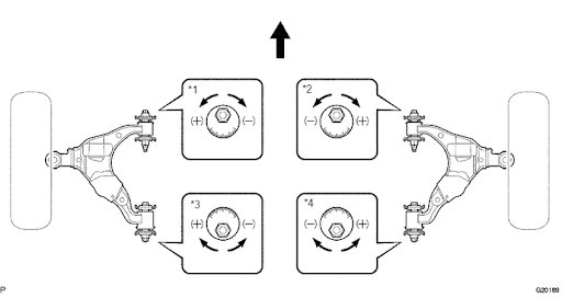

    Hey sorry if this has been answered on a different thread. I'm trying to fit some 35s on my 3rd gen, and I have billet icon UCAs and total Chaos race series LCA. I know the ICONs are adjustable but will I be able to adjust caster on my LCAs as well? Thanks in advance.
  2. Feb 4, 2020 at 1:24 PM
    FinnJ
    FinnJ Well-Known Member
    Sep 22, 2016
    #197981
    688
    Finland
    2007 FJ Cruiser 6M/T
    TRD SC, UCON, CNG conversion, RC 6" (lifted 4"/3" air suspension) w/FOX 2.5, 315/70R17 Duratracs, RECARO seats, etc.

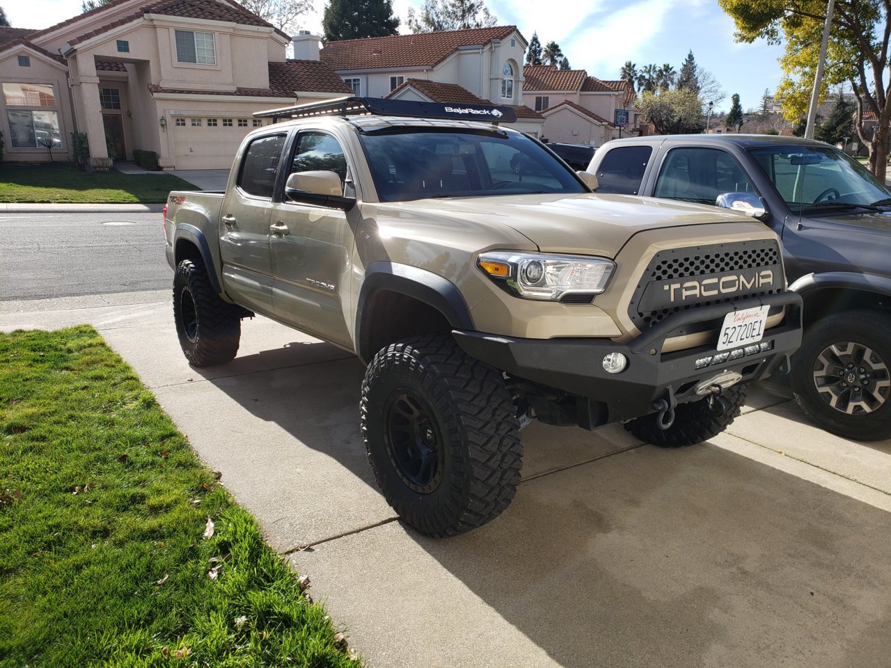

    Already done. Just making sure I dont rub when I flexing it out offroad

    Nice. Love to see a pic

    Bro that’s nice!
