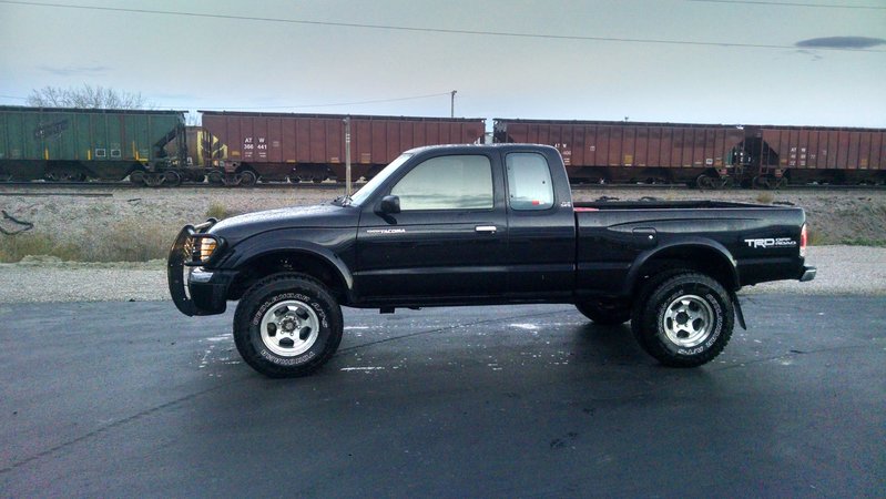

    I have the same lift on my 98. Front anyways. Bought it with the AAL in the back. I measured my hub to fender height and I get this. 22" approximately in front. I have a diff drop as well. I have Napa CV axles. They have wide spaced ribs and never touch. If I go up another 1/2 on the threads of my coilovers it rides pretty stiff. Rides perfect right now. A little rake to it but oh well

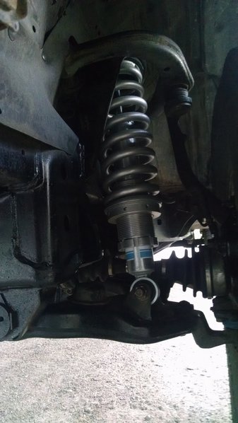

    Oh man, adjust I did. A couple times. There are three rings on the 5100 shocks. I contacted toytec and they recommended to leave the c clip on the bottom ring for maximum shock performance. So I did that. I had to assemble them and buy stock strut top cap and some rubber bushings. I have 32" tires so I need a little lift to clear the tires. I like the ride quality a lot. Now if I could get the rear end to ride as nice...

    Best way to adjust is take wheels off. Jack up first of course. Let the suspension fully sag down. You will need to use both spanner wrenches from toytec. You'll have to use some ingenuity to figure that out. If

    I have about 1-13/16" of thread showing. Measures 23" from center of hub to fender. Rides and sits nice.
