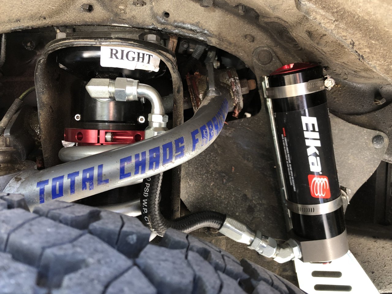

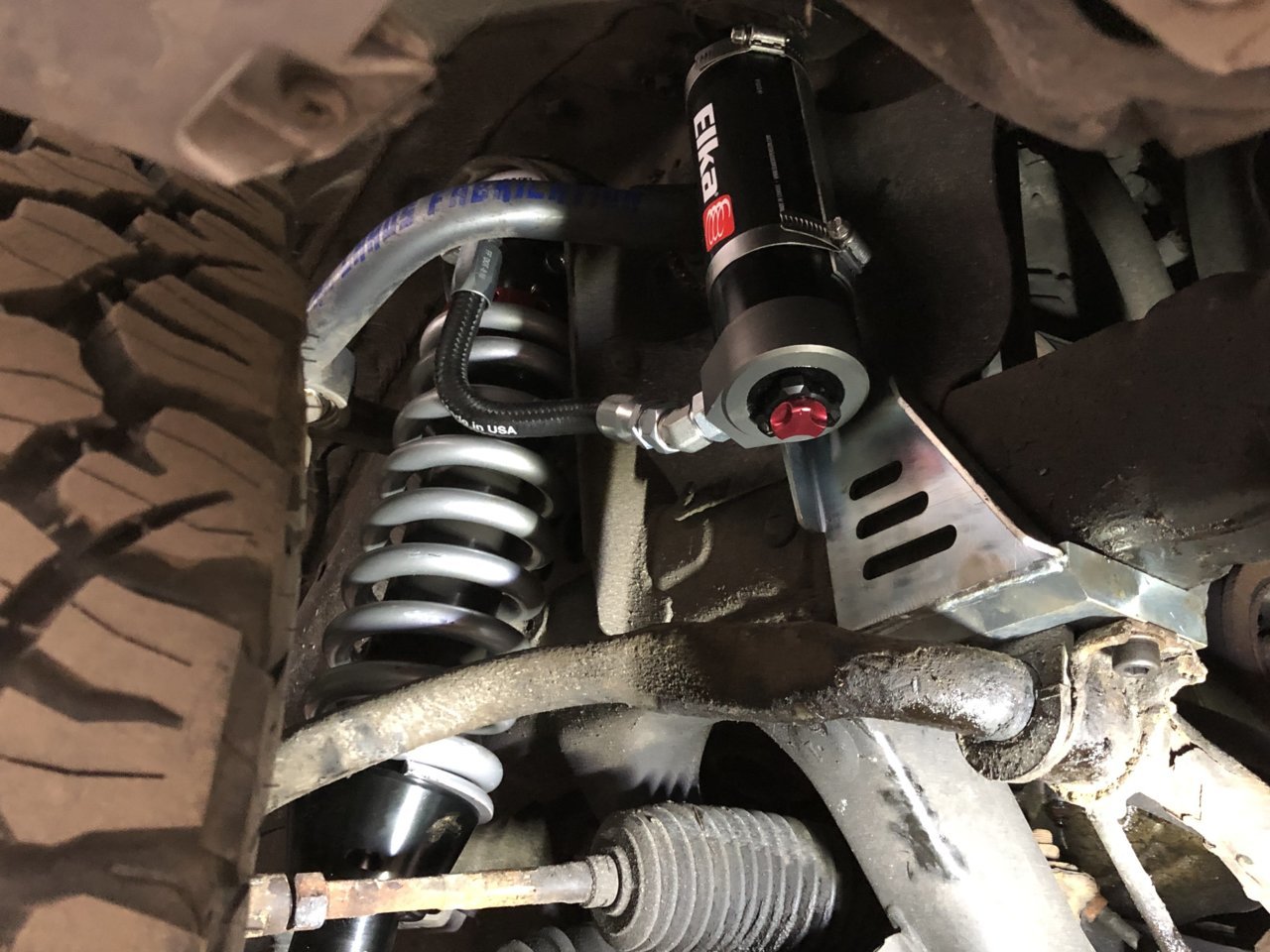

    hi guys.
    I had a set of “adjustable” Elka shocks installed on my 07 Taco last week. Comparing to the Toytec 2.0 Boss kit I had, previous, they are amazing. I should have done this from day one. Anyhow, I want about 1” more lift (I believe they are pre loaded for around 1.5-2.0”).
    I tried to turn the collar but it won’t budge when it’s fully jacked up. Apparently I will need to remove them and have the springs compressed on a spring compressor and then adjust the collar accordingly.
    Is there a “portable” compressor that I can use to relieve the tension such that I can spin the collar while still on the truck?
    Thx

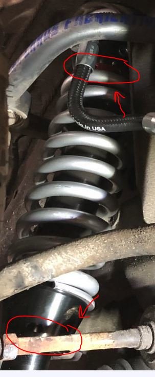

  4. Mar 30, 2019 at 7:56 AM

    This is what I use, works well. I have to remove my Fox shocks to adjust also. After doing it a few times now it only takes me about 30 min for both sides after the truck is jacked up and tires off.

    You've used this successfully on Fox Coilovers?
    I have 2.5's and would like to adjust mine as they settled about an inch after installing.
    I rented a compressor from Autozone but it was a different style and didnt really fit or work.
    I'd be interested in the exact process you use.
    Thanks!

    I had a long handle punch but not nearly as long as the setup you pictured. I was leary of backing the Allen screw out too far and causing the collar to jump the threads so I quit while I was ahead.
