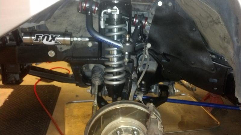

    Hi I just installed my Fox 2.5 C/O last week. I already had a 3 inch suspension lift in the front but it was time for me to upgrade. When I measured the ride height with the old shocks it was about 37 3/4in from the ground to the fender. after the installation I measured again and I was a in taller than that. I drove home and let it sit over night. I had no problems with anything. but I went out and measured the next day and I was at about 36 3/4. so I lost almost 2 inches as the shocks and C/O settled. Then while driving I also get that clunking sound while driving over bumps and it sounds like metal on metal.
    I checked everything was shaking my truck trying to figure out where it was coming from and I couldn't figure it out. I checked all the bolts that were loosened during the installation and all were good so I don't know where the noise is coming from. Im going to adjust the suspension so that it is back up to around 3 inches so my tires stop rubbing and hopefully the clunking goes away.
    Does anyone else have any ideas as to why there is a noise coming from these shocks? I just feel like I should have saved my money at this point and kept my old suspension. I am 100% sure I installed everything correctly as well. Just really annoyed because my truck sounds like it gonna rattle apart ever bump I hit.

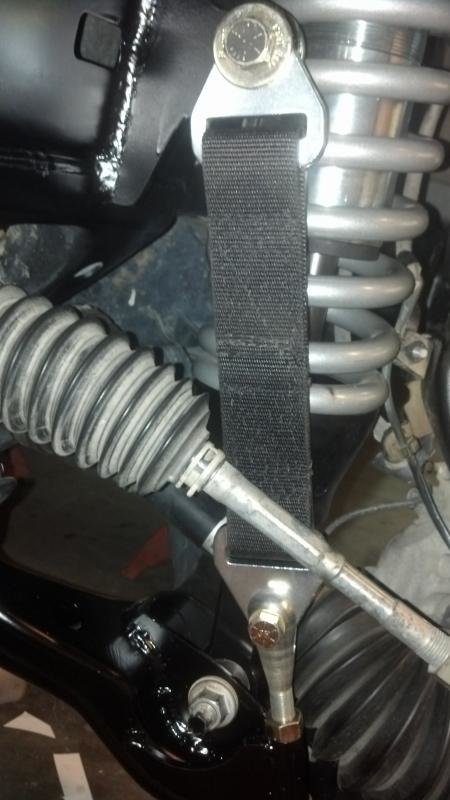

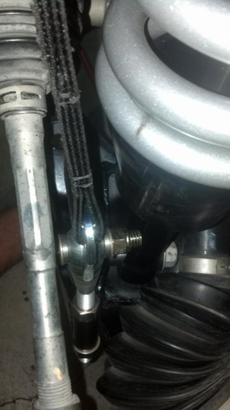

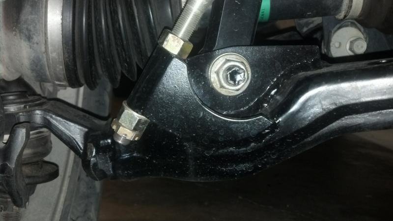

    The violent clunking that you hear when going over bumps is likely the shocks topping out or extending all the way. This is not the best thing for the longevity of a coil over shock and it’s easily cured with limit straps.
    IMG_20140718_172620_001_d94899c68419d06a11cba01f4abdcb46bfa44c80.jpg IMG_20140726_230632_194_c85ba4b96dfbeea00596b61beb5e18ee9c948df2.jpg
    (top bolt is a temp) Lots of people just bolt the strap to the bottom shock bolt and let the strap rub on the tie rod and rack and pinion boot. I built tabs to put the clevis on the bottom so that the strap wouldn’t hit anything. There isn’t much room in there but it was worth the work to keep the shocks from beating themselves to death.
