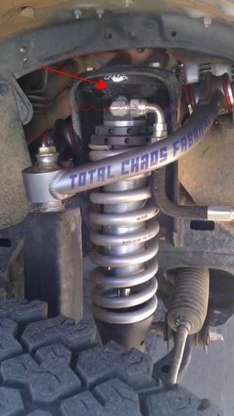

    Anyone know where i can find that top plate for the 2.5's? I cant find a part number. The piece that connects the shock to the housing off the frame....

    I drew a hi tech arrow and clound to eliminate any confusion.

    Or call Fox. 800/369/7469 - extension #8.

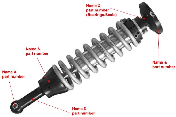

    check out the pic now that should be easier to see

    So found the exploded view design of the shock on Fox's website. Go figure. parts and pieces are spendy!

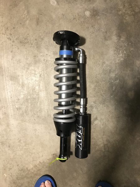

    Hey guys I got the Fox 2.5 with resi can anyone tell me approx how much of a lift will I get from the pic. Bottom of blue tape is factory setting so I went down approx 3/4 inch. As @Kman mentioned above it is nearly impossible to try to turn the preload ring without a spring compressor machine but then again I didn't use wd40. @FinnJ any feedback is appreciated. I have a 2017 offroad and I'm looking for a 2.5" lift.

    The stock setting gives you about 2" lift, now you are going between 3" to 3.5" I think. Install them first, you can loosen the collar easier without a spring compressor. Just lube the spring perch and thread first. 8mm punch is just right size for the adjusting.
