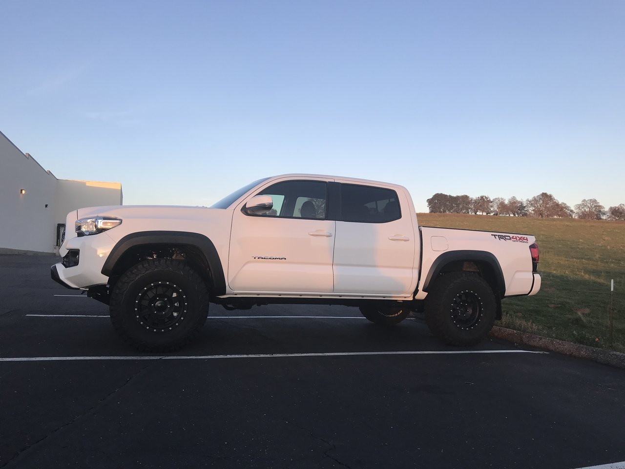

    I forgot to measure before hand...
    I believe I am measuring correctly. I don’t have any added weight. Here’s a picture. Stock rear suspension for now, 285/75/16s
    Edit: I have 27 threads exposed

    27 threads (1.925") should equal to a 2" over stock lift for a 3rd gen. That's the max that Fox recommends.
