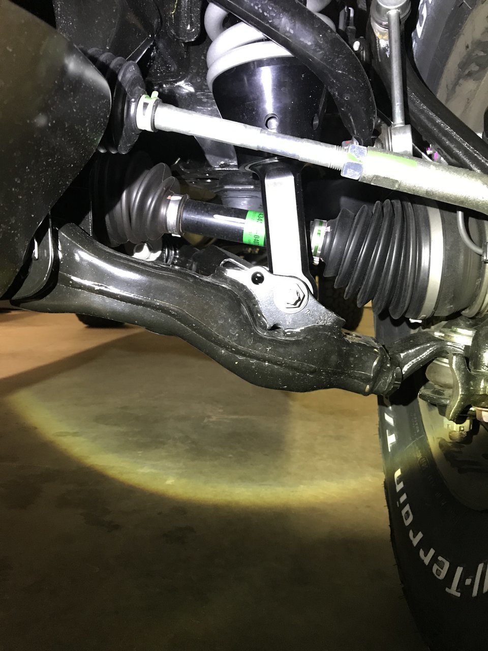

    How much down travel from static height?
    Pics of drive axle boots?

    I’ll have to measure the down travel
    Here’s a pic of the drivers side axle

    Do you have a light on that camera? Lol
    I can't tell anything because the pic is so dark.

    Same issues I was going through. Crank em back down. Anything over 23 inch hub to fender is not going to be worth it. Will loose your down travel.. I'm back at 22.5 inch hub to fender and am happy

    It actually looks pretty good to me. Based on your cv boot and where the shock housing sits in the coil. You can see just a couple of inches of piston, which means you're somewhere in the middle of the range.

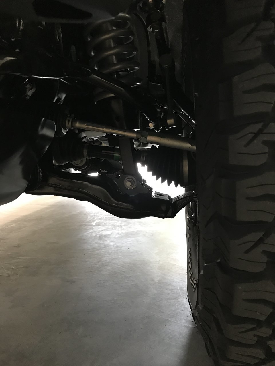

    How’s this

    damn. that's better.
    Now that there's light, the boots look like they are touching at the accordians - which means your angles look a little high and you will blow through the cv boots quick. In other words, not great. how many threads you say you are showing? 2 3/4"? 24" hub to fender?
    IMO you should turn em back down to around 2" thread showing max. do it before you align.

    Agree with Adam. You went a bit too high. Your down travel/droop is surely suffering as well. These things are a juggling match of finding the max amount of lift where other aspects don't suffer (down travel, ride stiffness, drive Axle boots shitting the bed too soon). If it were mine, I'd lower it a bit but it's not so do as you please! Ideally it'd be:
    ~23", boot ribs not rubbing, ride great and ~3" of down travel. That's MY idea for the perfect setting. That'd be right around where Fox says is max on these (1.925" of exposed threads which equals 27 exposed threads). YMMV.
