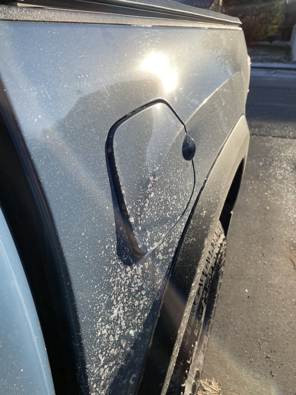

    Hi all!
    I just picked up this bad boy yesterday. I noticed the fuel door was not flush with the body. I figured someone probably walked into it when it was open or tried closing on an open gascap. I thought, no biggie I can easy adjust that myself.
    Took a peak today and noticed the mounts looks riveted on. Has anyone successfully adjusted a bent fuel door mount or can post a pic of the hardware so I can see what part of mine is bent? Thanks for any tips!

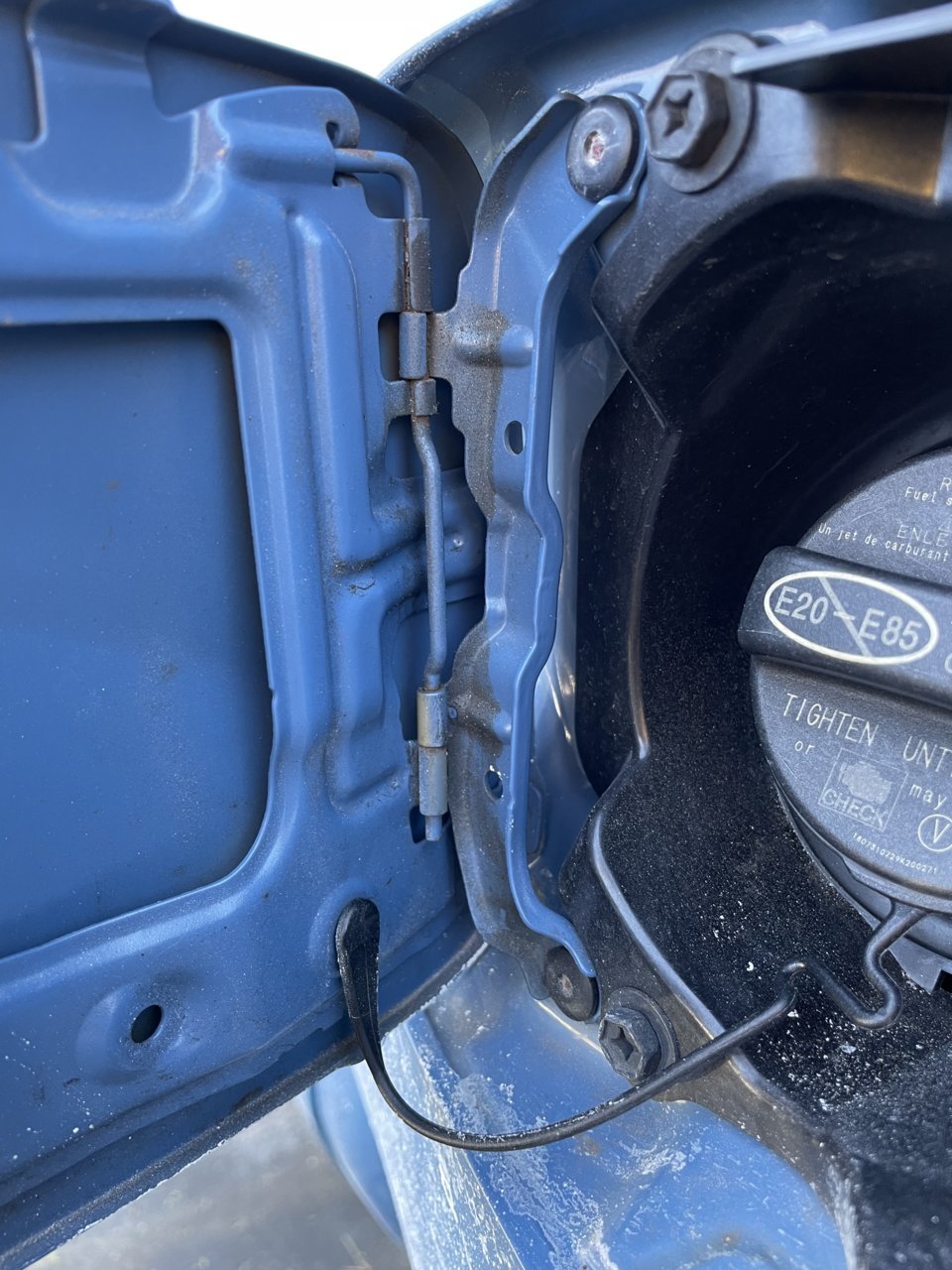

    if you just bought it, that looks pretty henky, ask them to fix it before you attempt DIY.

    What looks deformed to you you guys? Can someone post a pick of their healthy fuel door?B1EC86C4-D77E-426B-A4AD-E2FDDE8394D8.jpg

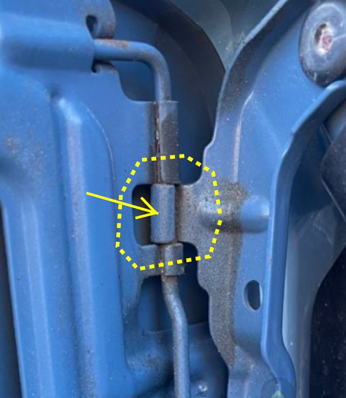

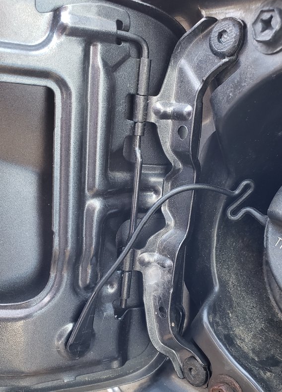

    The fuel door on my '21 TRD looks much different:
    My gut guess is that the 'curled' part of the hinge (arrow) has 'uncurled' due to lack of lubrication over time.

    Actually, comparing to yours, I'd say the bottom on OP's needs to be "uncurled" some.

    It also looks like the braket/hinge base, that is riveted to bedside is pulled away. Look at both pics, OP's has a wider gap.

    It almost looks like it was bent to all hell and halfassed bent back to somewhat shut. I’m the end, it doesn’t matter, it needs fixed, most likely professionally.
    I’d still give the dealer a shot at making it right.
