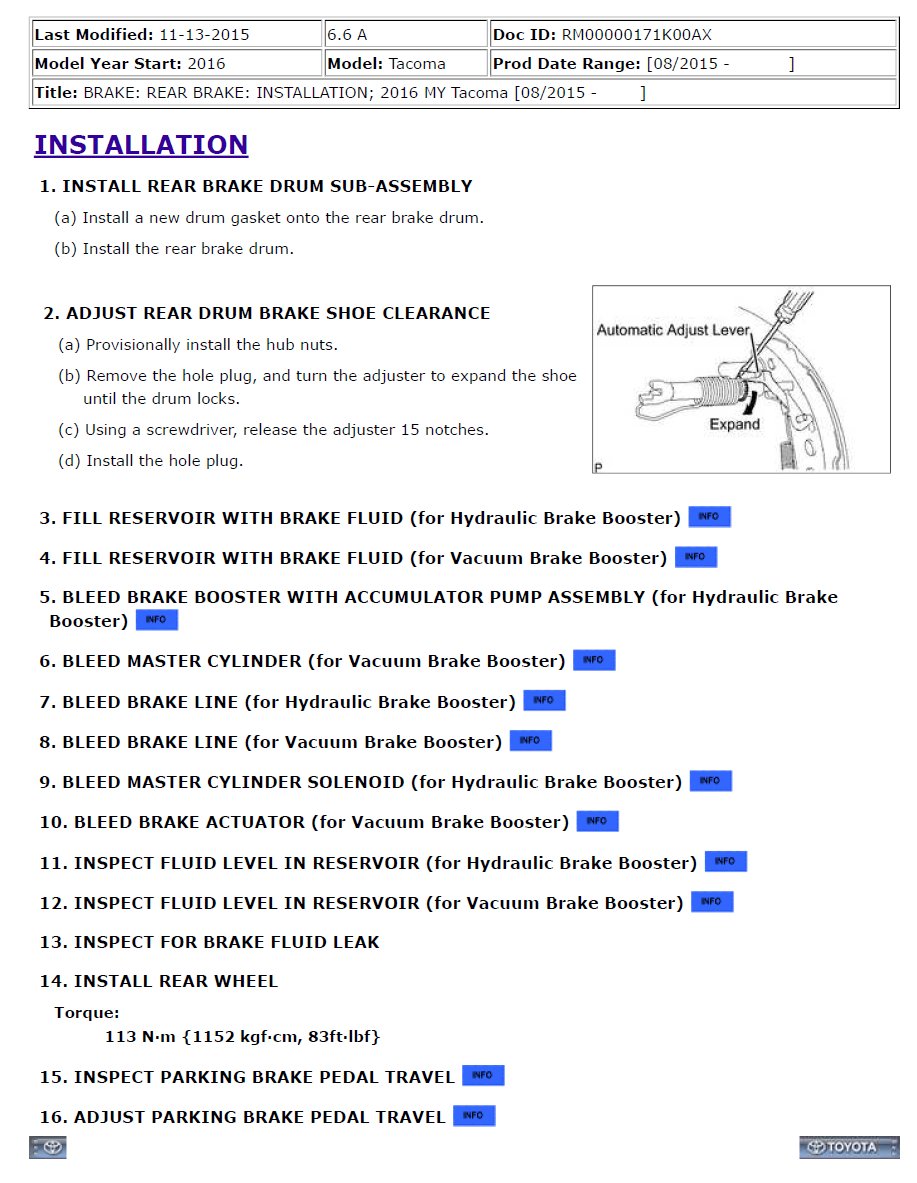

    When adjusting the rear brakes on a 2021 tacoma 4x4 must you alternate going forward after backing up and using parking brake to adjust the rear brakes? Or can you keep backing up and use the parking brake without going forward?
    Thanks in advance

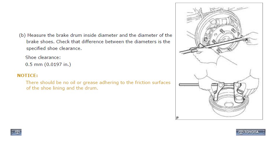

    Nothing in the Service Manual is jumping out at me. This is all that I see about adjustments:
