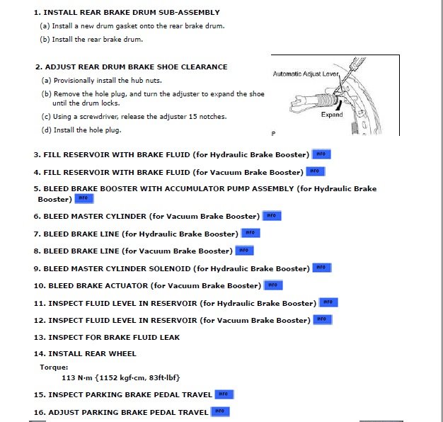

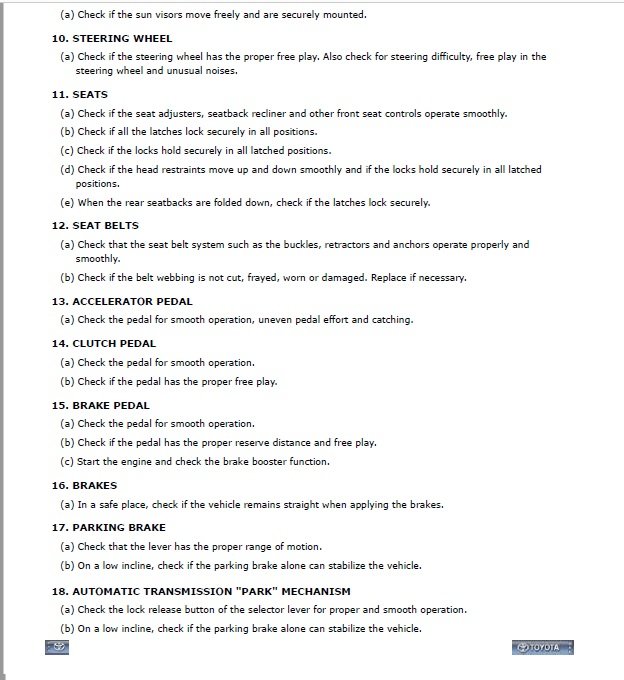

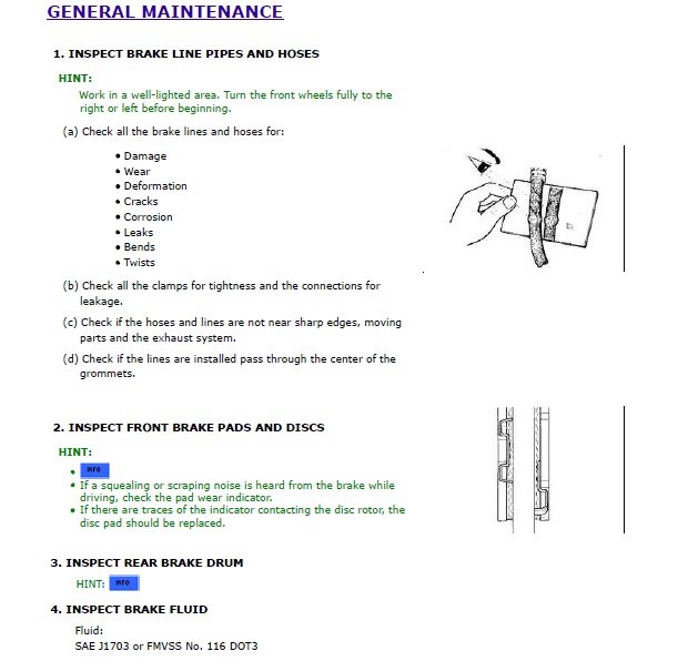

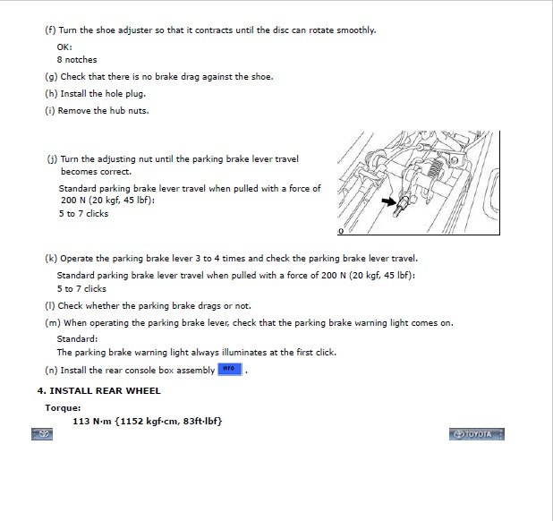

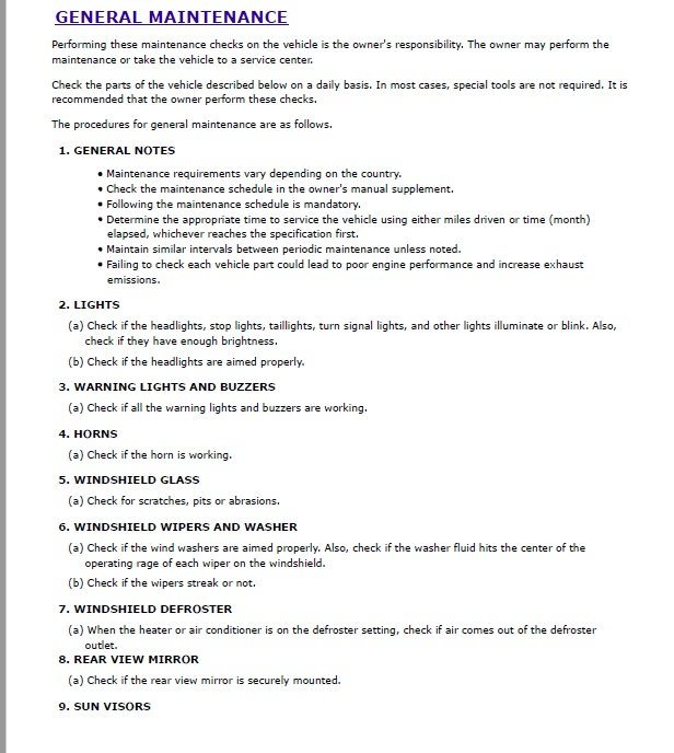

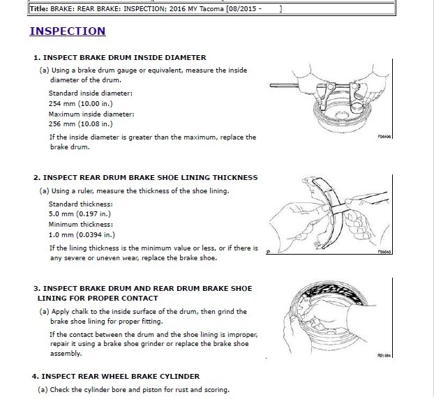

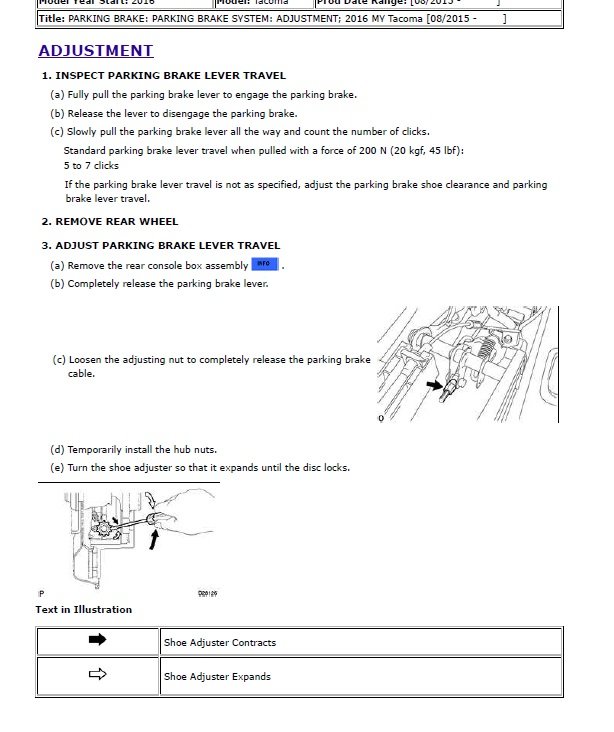

    It does have an auto adjuster that could not have been set correctly, initially. You said the parking brake felt funky...included adjustment procedure.
    I also included the service manual maintenance information. I guess Toyota could say, these things get discovered during a maintenance inspection, thus, no real service interval for adjusting.
    Pscdouglas, wi_taco, Kev250R and 4 others like this.

    @splitbolt with fsm screen grabs. Always on point buddy

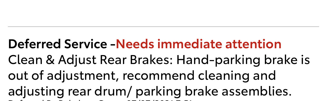

    dealer wanted $55.
    i declined for now
