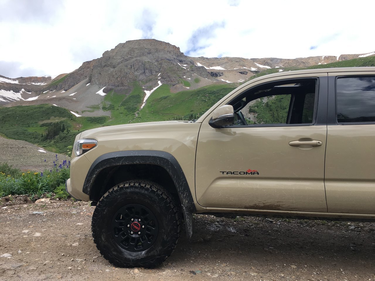

    IMG_1311.jpg I'm running the 2017 Tacoma Pro wheels with no spacers. Have 285/75/16 BFG tires. No rubbing. Lift is a 3" OME.
