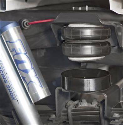

    I also want to get the daystar cradles. You can offroad with them and still use the air bags. They're just mounts that go under the bag and the air bags are free from the previous mount they were on and pretty much float on the daystar cradles. So you still have all your off road ability.
    https://www.youtube.com/watch?v=r4QBG3izhyA

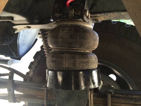

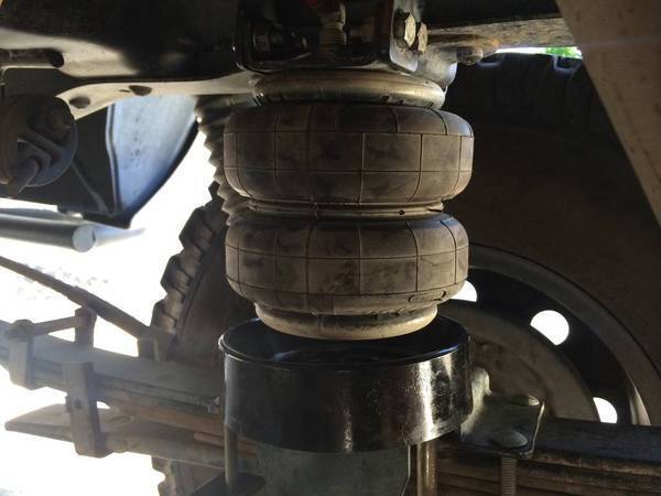

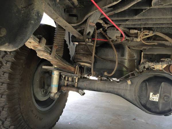

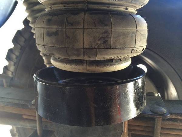

    just installed the daystar airbags. Took about 30 mins.
    Before: Attached to the bottom
    Daystar Cradle installed and now the air bags are free from their bottom mount. Now I feel safe going over bumps. Always felt they might rip with full extension. (rear is jacked up)
    Bags with 20psi
