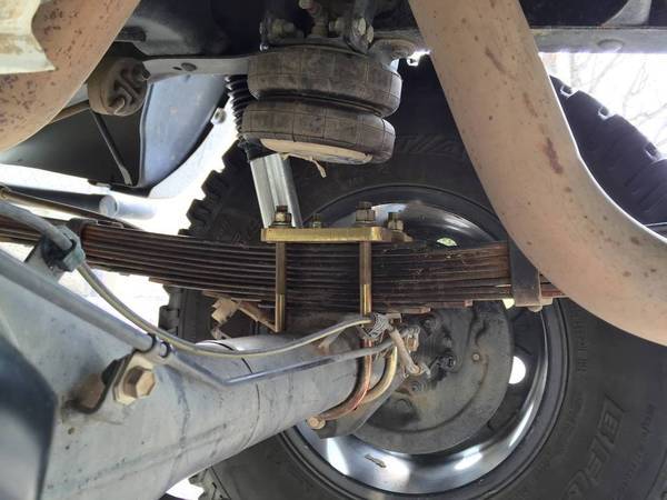

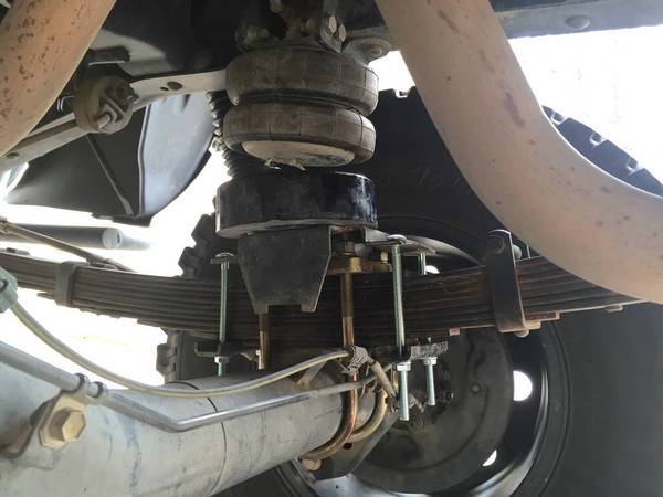

    Finally installed my AllPro Leaf Springs, U Bolt Flip Kit, Extended Bilsteins and trimmed my u bolts. Still need to put back together my bottom air bag bracket w cradle.

    Got the rear done finally.
    rear lifted:
    rear not lifted:

    Interesting. so when you take this truck off road do you deflate the bag? Do ever tow anything?

    0psi now. Had 30psi with stock leafs. Now with all pro leafs, I have the same lift in the rear so no need for air in the bags anymore. Even before I would deflate before off-roading.

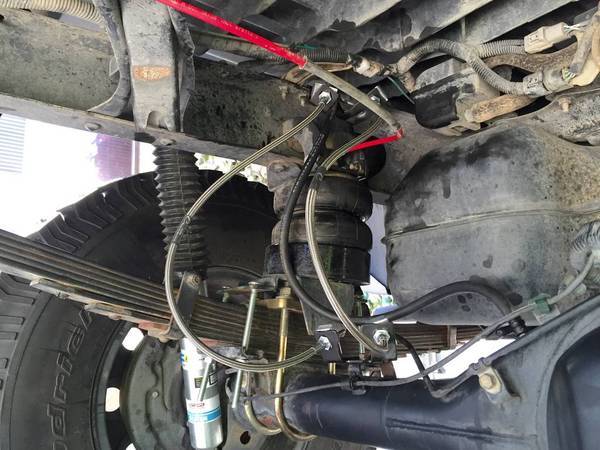

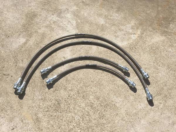

    AllPro extended brake lines. Now I have to find the time to install.

    Thinking of paying someone to do it. Any volunteers?

    When I take off the old lines does a lot of brake fluid come out?
  17. Feb 26, 2015 at 2:52 PM
    #357
    Manwithoutaplan
    Manwithoutaplan the full Monty
    Jan 30, 2008
    #4500
    54,643
    ID
    it really depends just make sure you keep the reservoir topped off so you don't suck in air.
    I have seen it gush out and seen it just drip out.

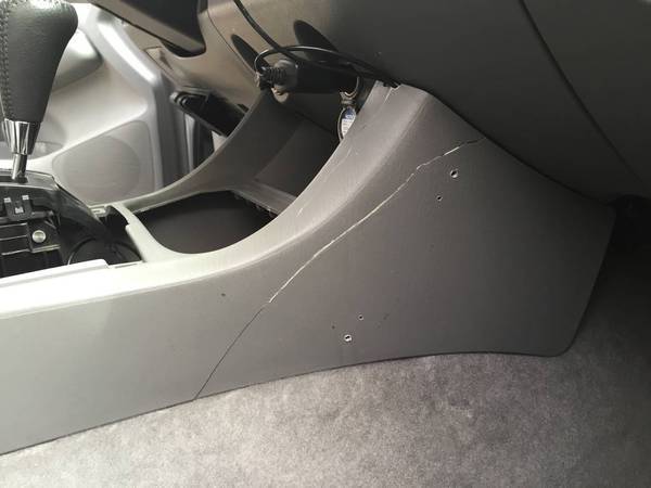

    Finally switched out my upper center console and did the 400 watt anytime.

    Did my brake lines finally. Cbass helped with the rear and I just did the fronts by myself. Fronts took like 10 mins max. Rear took about 2 hours.
