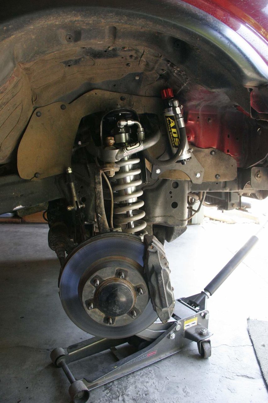

    2002 XtraCab TRD 4x4 SCv6 AutoTrans With Lots of Mods ADS COs w/Compression Adjusters Camburg Uniball UCAs Whiteline Lower Control Arm Bushings Kartek 7" Limit Straps Plastics Guy Front Bumpstops Total Chaos Sprindle Gussets Custom Alcan Springs +800 lbs +3" ADS 10" Stroke Triple Bypass w/Resi Rear Shocks Custom Rear Shock Relocate All-Pro U-bolt Flip w/Timbren Bumpstops 4.88 Nitro Gears ARB Front Locker ARB Twin Compressor Black 17x8 Konig Countersteer Type X 285/70r17 Falken A/T3w Gunmetal 16x8 SCS Ray10s 255/85r16 Maxxis Bighorns Limited Edition (Relentless) Elite Front Bumper Smittybilt X2O 10K Winch Diode Dynamics SS3 Sport Selective Yellow Fog Lights in the Bumper Diode Dynamics SS3 Pro 4,000 Kelvin SAE Driving Lights with Clear Lenses on the Bumper Morimoto D2S Projectors XB35 Ballasts + 4300K Bulbs Badland Sliders FrankenFab Tire Carrier Swingout bumper w/kitchen BudBuilt Front & Bellypan Skids BAMF Rear Diff Skid Dometic CFX 55im Fridge/Freezer Alpha II Hardshell RTT Badland Custom Bed Rack Denso 210-0461 105 amp alternator Dual Northstar 24F AGM batteries BlueSea 7622 ML-ACR Battery controller Peak DBI Dual Battery Voltage Monitor Haltech IC-7 Display with Mako Dash Insert Haltech Elite 2500 Standalone ECU Magnuson MP62 Supercharger w/URD 2.2" Pulley Denso 650cc Fuel Injectors Aeromotive Stealth 340 Fuel Pump TransGo A340F Reprogramming Shift Kit Doug Thorley Headers 2.5" Magnaflow Hi-Flow CAT Magnaflow 18" Muffler w/Vibrant Resonator 13WL Brake Calipers Braided Steel Brake Lines Kenwood TM-71A Dual Band Ham Radio Larson 70CM/2M Antenna Midland MTX275 GMRS Radio w/Roof Mount Antenna Uniden 520xl CB radio 3' Firestik Adjustable tip antenna Pioneer DEH-P9400BH HU Alpine Amps & Type R components (F) and coaxials (R) Wet Okole Seat Covers Weathertech Digital Liners Deck Plate Mod 1" Diff Drop Carrier Bearing Drop
    Great thread start OP. This could become an excellent resource going forward for 1st gen owners considering their suspension upgrade options.

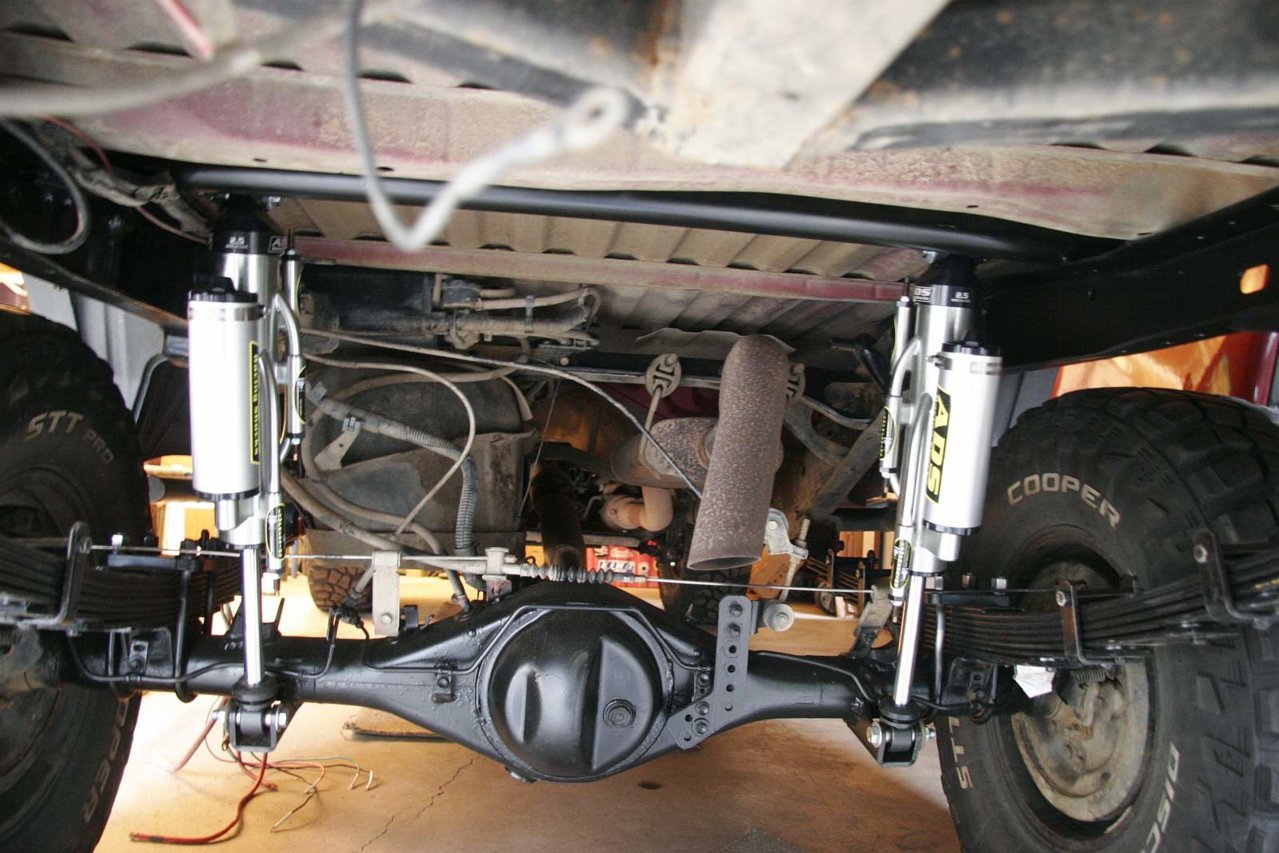

    Here is my mid-travel setup:
    In the front are extended travel, 2.5" ADS coilovers with 650 lbs coils and remote resis with clickers. The COs are set for ~2.25" of lift, with 7" limit straps, plastics guy's durobumps and Camburg Uniball UCAs.
    In the rear are 10" stroke, 2.5" ADS triple bypasses that are mounted about as vertical as possible to still fit without going thru the bed. The shocks lengths are 25" extended and 15" compressed. ADS was able to get this 'short body' design with the use of welded rod ends. The leaf springs are from Alcan and are spec'd for 3" of lift when the bed is fully loaded for adventures. 4" Timbren bump stops and OEM shackles round out the setup.

    so with them almost vertical, the rear is cycling 10-11” of travel ? Do the shocks act like limit straps or no ?
    sorry for all the questions, I’m in a similar situation and I think I’m slowly realizing that max travel is like 10-11” with these setups. This is insufficient for my needs. Unless I do like a cantilever setup under the bed it seems a bed cage is the best idea for 14-17” travel range.

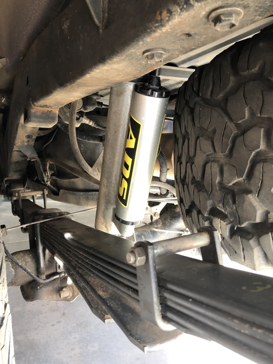

  7. Dec 24, 2020 at 12:15 PM

    10-11" of travel is about what you can get with a leaf pack that is the stock length on a 1st gen. You can get more travel with something like a Chevy 63" pack as @drr has done - he's running 12" shocks with that pack.
    For more travel, you'd need a longer pack, SUA, that kind of thing. For 14-17", you're definitely going to be looking at going into the bed and/or SUA and longer shackles.
    The tire definitely doesn't fix back there with a cross bar - I don't know of anyone who has gotten that to work, especially with 33"+ tires, which are already tough to fit back there.
    For u-bolt flip, you can essentially pick whatever kit you want - they are all conceptually similar (obviously). I used the one from here, and it's been great: Toyota Tacoma U-Bolt Flip Kit - DuroBumps - Toyota Bump Stops for 4Runner, Tacoma, Tundra, FJ Cruiser

    The top out limiting factor is the alcan springs. Right now I am able to utilize about ~9" of travel with this bump setup. No limit straps on the rear yet, but may be a future mod.
    I would generally agree. Unless you go through the bed, or lean the shocks way back, about 10" is max for a spring-over configuration.
    Good eye. I have spoken with Matt at MCM Fab about this issue. Because of the hose length and the way the fittings are configured, the hose has to be on the outside, exposing it to the tire. With my tire/wheel combo with 4" of backspacing and 285/75-16s, the tire did rub on the hose a little bit. 3.5" of BS or a narrower tire (what I did) the rubbing on the hose was reduced to almost zero.
    Bumps in the rear are mounted on the axle. I used this kit: ADS COs can be ordered with 600, 650 and 700 lbs coils. 650 may be too much coil for an extracab with no added weight (plate bumper, winch, skids, sliders, dual batteries, etc.).

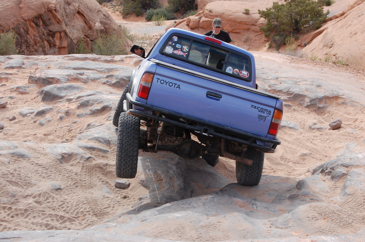

    The spare was removed so I could get a better picture. Recall the 1st gen rear stock shock locations are opposed on either side of the axel. Passenger side is mounted closer to the front of the vehicle which allows clearance for the exhaust:
    Drivers side is mounted towards the rear. Tire size is 275 70 17 (32.2 inches) which clears the shock:
    chowwwww[QUOTED] likes this.

    wow thanks! That's fully extended then right, looks like your tires off the ground...
    With those stock mounting points and shocks, are you noticing them over-extending, like going over a speed bump or something?

    Yes, fully extended.
    I never hear the clunk from the shocks over extending as described in the ADS thread. Maybe I drive too slow? I’ve been on a few challenging trails.
