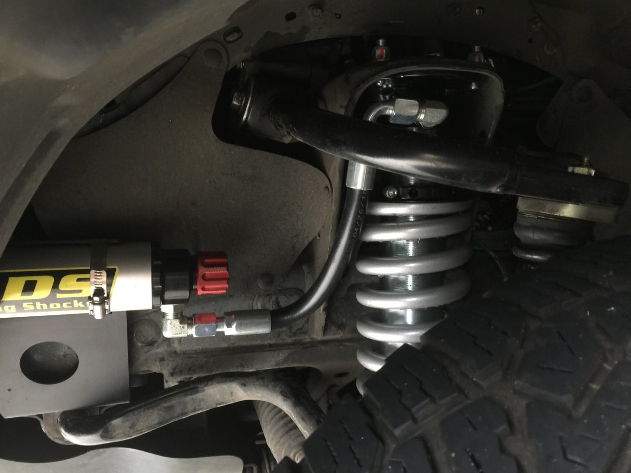

    Ride is instantly nicer than my OME 90021 with 2888’s. Clickers are amazing as you can tell the difference pretty noticeably every 3 clicks. Really can’t wait to upgrade the rear shocks as well from the OME nitrochargers.
    No regrets, just design recommendations for one more hole in the shock head for the wrench when preloading. There is a certain spot where the UCA and shock head will not have room to accept the wrench because the Allen bolt that holds the head together prevents the wrench from sitting well enough to get torque to turn no matter which end you use. The threads without lube are hard as F***!
