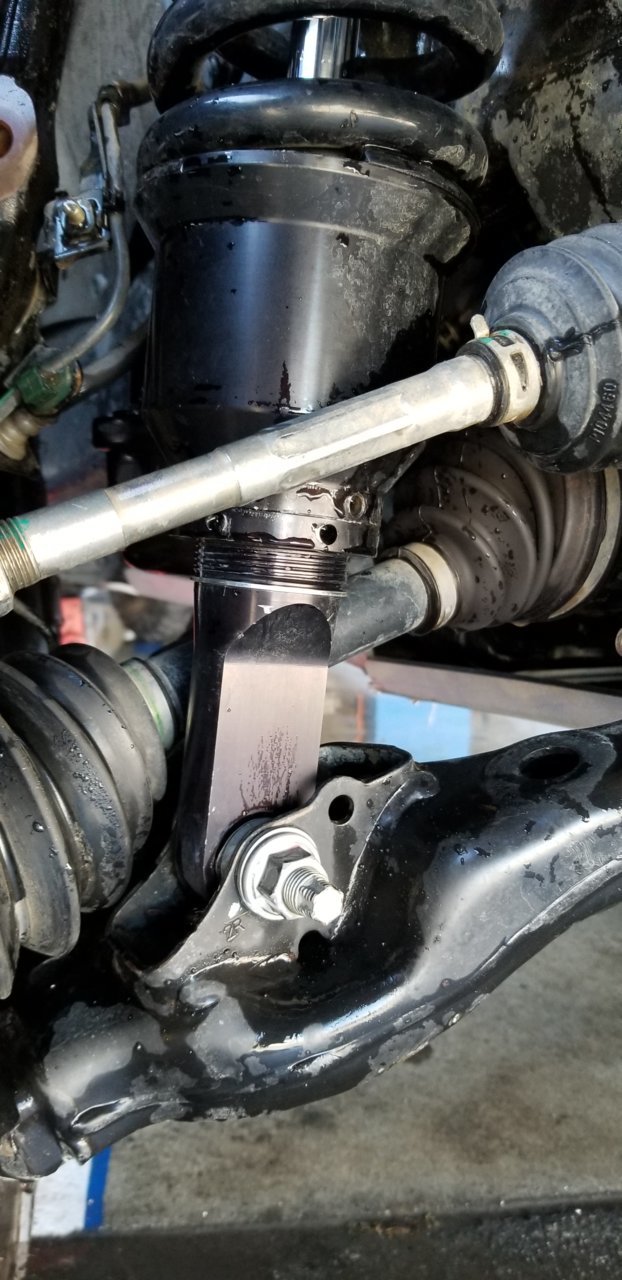

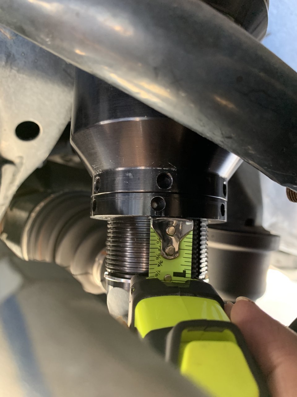

    the 8112 doesnt have clips like the 5100 and 6112 do. They're on an adjustable sleeve. Unsure how high I have the front lifted but they're not close to being maxed out thats for sure. I would guess 2.5 inches? I prefer not to preload my springs to the point where it makes the ride harsh.

    you have pics showing your preload of your 8112s. 2” is suppose to be max or 19 11/16” max length of coil. That’s mine about 1” on both sides with 650coils 79B414B6-2854-4BFA-9412-4F46AE86DCEF.jpg

    Driver and passenger
    oscolivar1[QUOTED] likes this.
