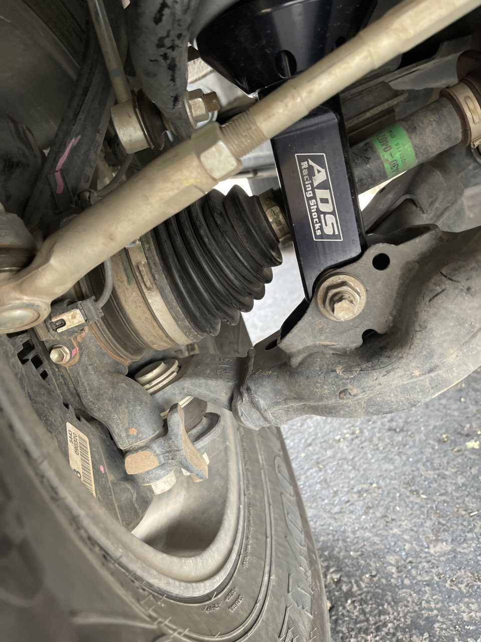

  18. Feb 9, 2021 at 11:32 AM
    #18
    jdubyat2
    jdubyat2 [OP] Well-Known Member
    Sep 20, 2020
    #341425
    123
    Josh
    Scottsdale AZ
    2021 Tacoma TRD OR DCSB
  19. Feb 9, 2021 at 7:40 PM
    #19
    INSAYN
    INSAYN Well-Known Member
    Dec 2, 2016
    #203898
    2,243
    PNWet, Oregon
    '17 TRD OR DCSB 6MT 4x4...'97 Taco XtraCab 5MT 4x4
    DIY Fabricobbler.
    Can't really see the CV boots where the creases are at the closest to touching. That would be the bottom side of the inner CVs and top side of the outer CVs.
    In a quick glance though, I think you'll be fine right there. The axle itself does not appear to be at an aggressive angle. :thumbsup:
    How's your rake look front to back? Having the rear 1" to 1.5" higher than the front is normal and in some ways desirable if you ever plan to load the bed or have some hitch weight that will make it squat a tad and level out.
  20. Feb 9, 2021 at 7:48 PM
    #20
    jdubyat2
    Sep 20, 2020
    #341425
    123
    Josh
    Scottsdale AZ
    It’s about an 1 1/2” higher. It bugs me but I’m going to wait I til get my tires on before I look at a bed rack. I appreciate your help brotha.
