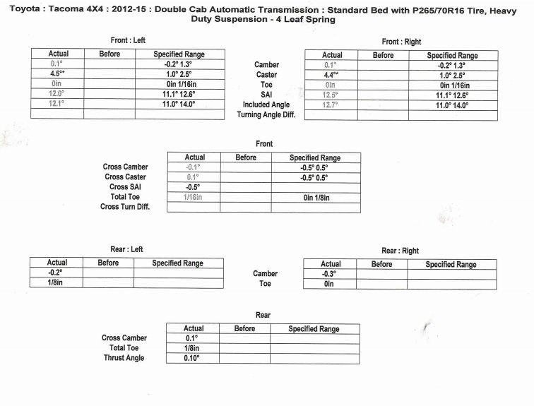

    After struggling to find any tire or automotive shop in general with the software update for 2018 Tacoma's I finally got my truck aligned after suspension install. I wasn't worried about the delayed alignment because I have been out of town and thus put very little mileage on it. This was the only shop that said they could do 2018's and guess what I found after the alignment.....they didn't have the software package for 2018's. Besides the fact that they were unable to set some configurations that are required for the new Toyota Safety Sense package (based on discussions with other tire shops), everything looks pretty good.
    This is my first time really paying attention to alignment details (first real truck build too), does anyone see anything wrong?

    Thanks for the help. Luckily for me I had the Total Chaos spec sheet that recommended 3.5 to 6.0 caster specs to aim for. I also did a little prep work and loaded my truck bed with 350ish pounds to simulate my future typical weight with GFC/cargo and put some ballast right behind the driver seat.

    I was going to say the same thing. My caster is at 3.3 degrees, surprised he got that much as well

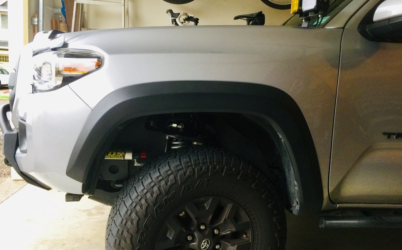

    I’m wondering how much caster I will need for 255/75/17? Maybe I’ll be fine as is

    Sounds like I’m cherry for now. Yup 32” tire will be +1.25” from where I am now and judging by the visual gap I see about 1” on each side of the tire at full turn.
