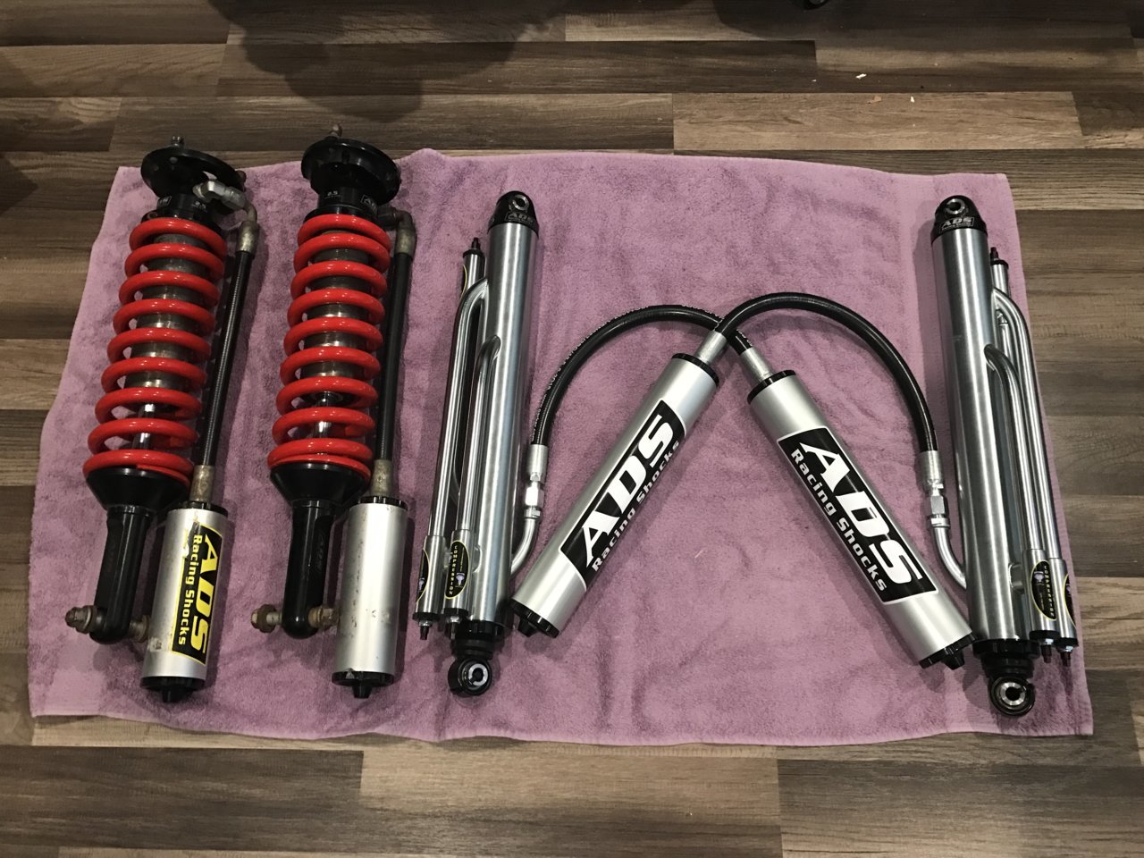

    Anyone have a photo of ADS 2.5" remote resi coilovers in the front of a first-gen Tacoma, with MCMs brackets for the resis?
    Looking for the best way/location to install...
    @M C M

    I have an ADS problem, guys. My therapist says I need help. :thumbsup: Edit: I find it a slight bit hilarious that the resis on these bypasses are larger than the entire shock body on the coilovers. *maniacal laugh persists* :laugh:
