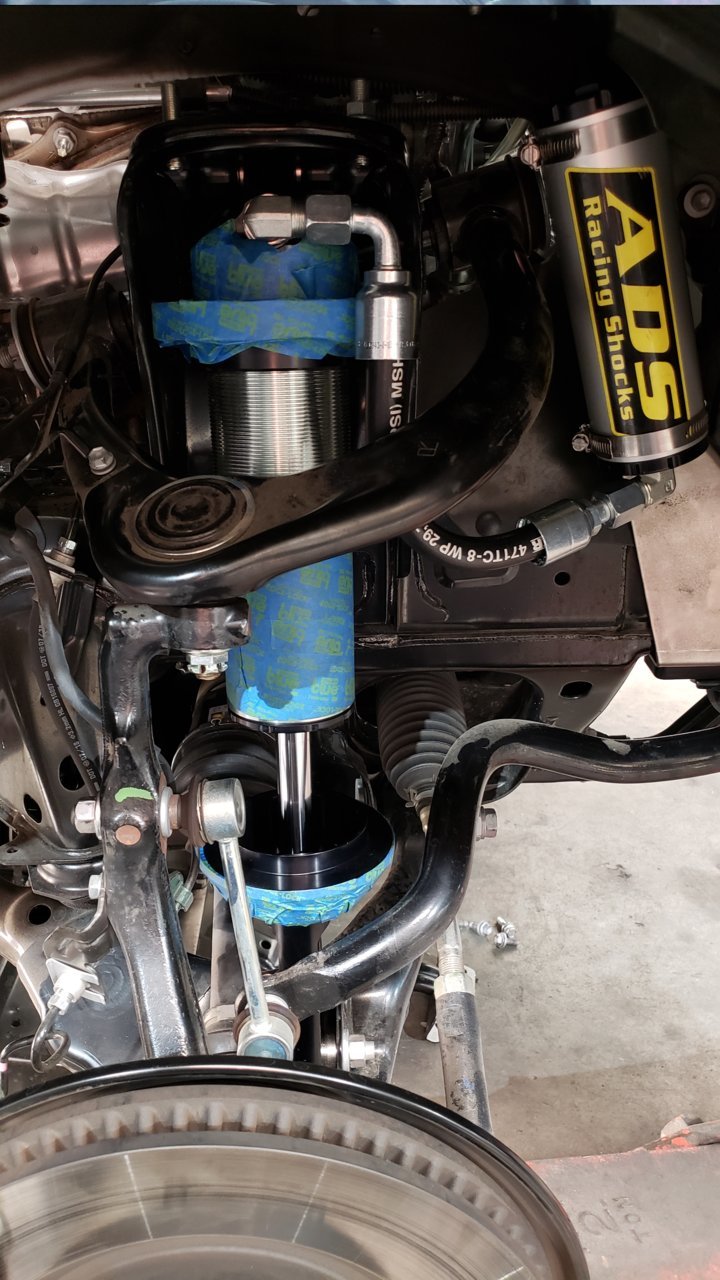

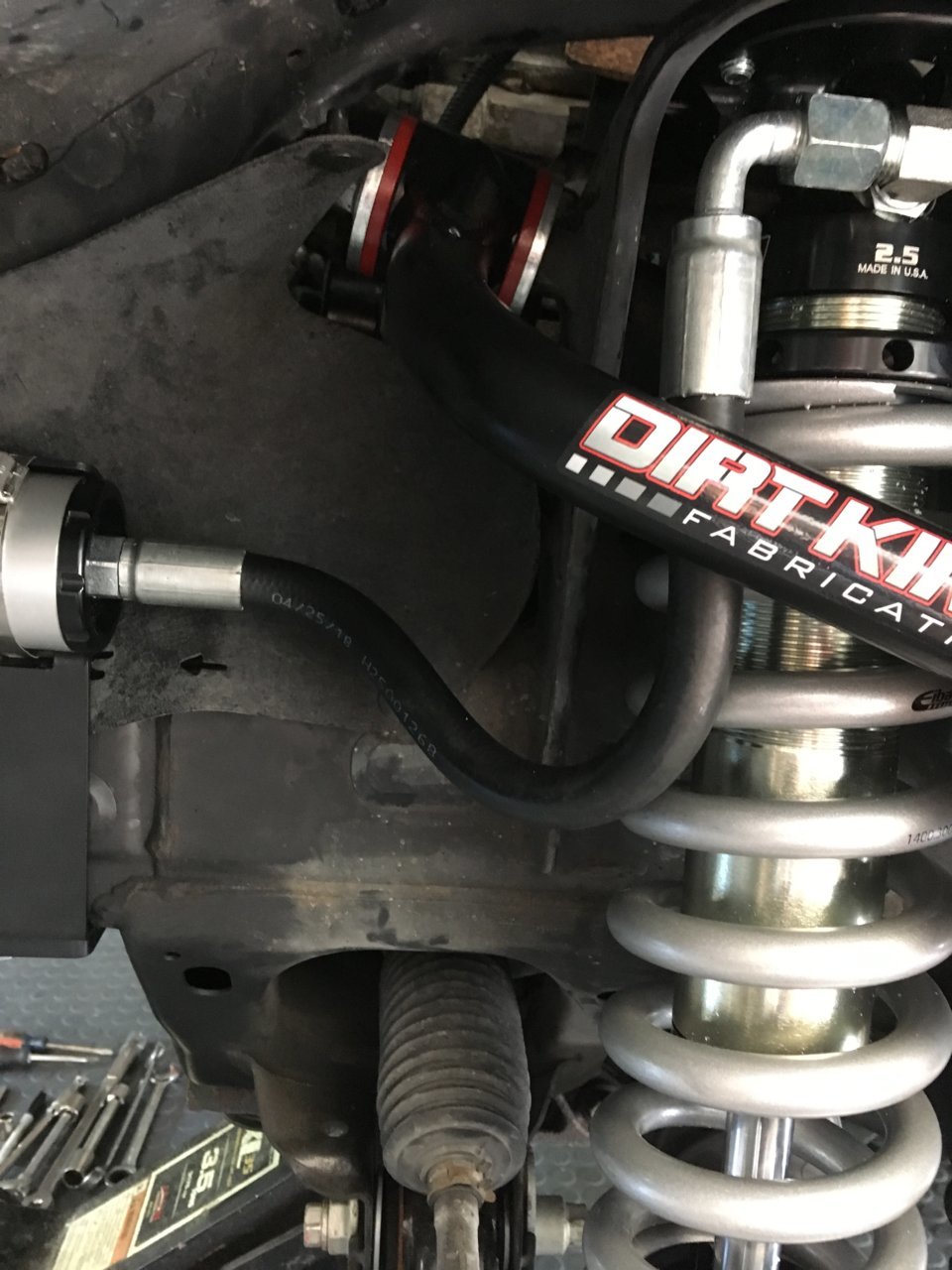

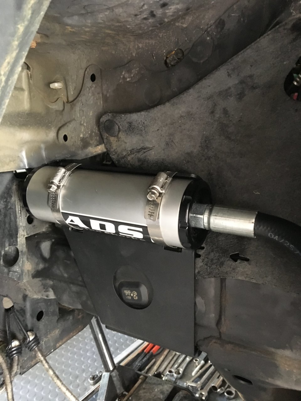

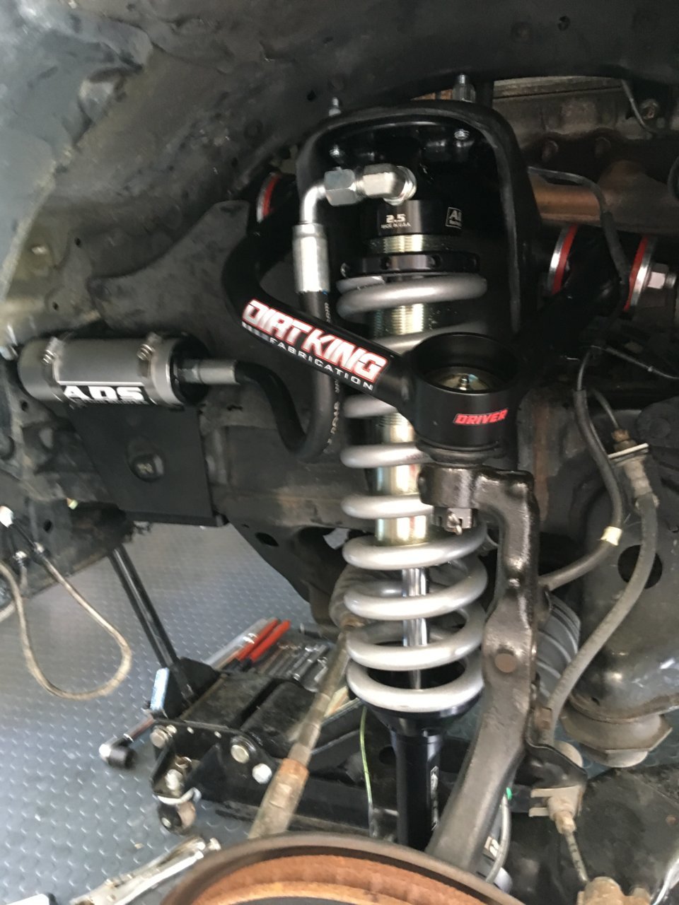

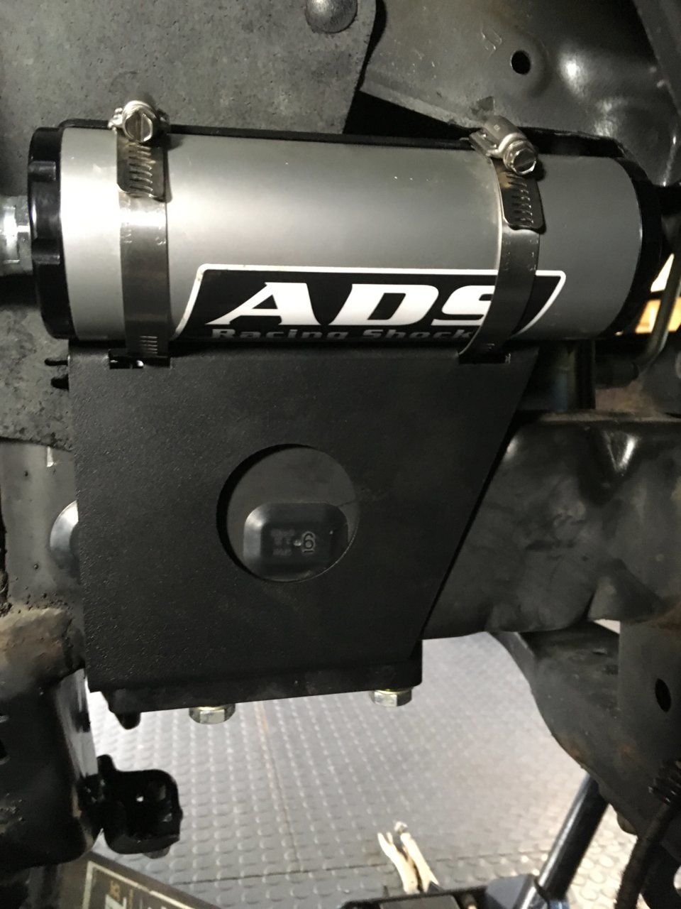

    Matthew at MCM sent me these brackets for a first gen. Turned out great and no more rubbing on the reservoir in the original location. If anyone has any questions I’d be happy to answer them.

    Anyone have any idea what the minimum height should be on these? I’m definitely lower than 2” on my 04. Maybe Matt at @M C M can chime in.

    Min is what they come set at from ADS (recommended minimum)

    Minimum? Well minimum ride height depends on spring, so whatever spring you have on your coilovers you can move the adjustment collar up until it's no longer in contact with the spring or you run out of thread. That will be your minimum ride height with that spring. I wouldn't advice just having the adjustment collar rest on the spring as I've heard it can cause some noise. And a little preload is good to keep your suspension in contact with the road.

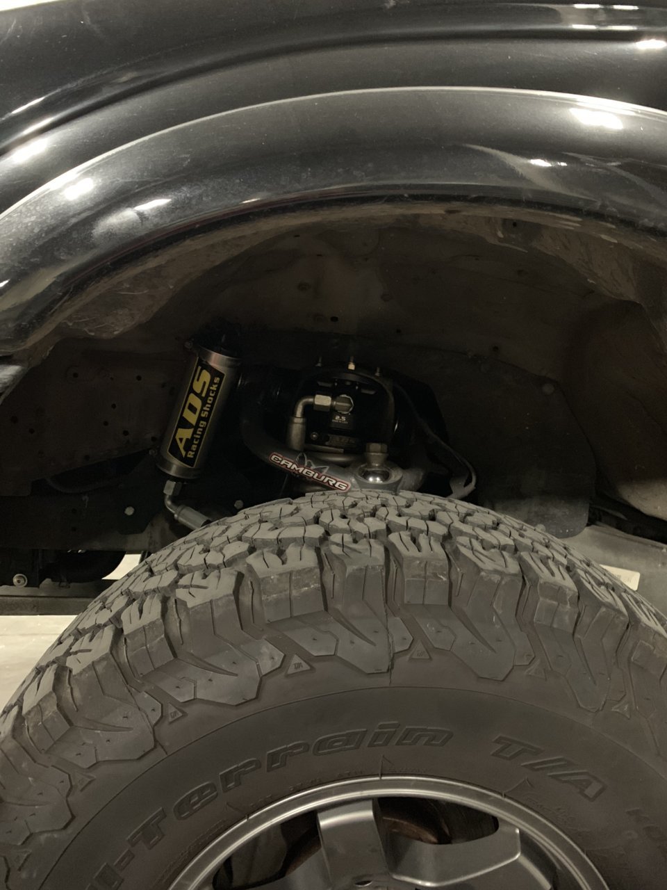

    Test fitting the 3.0s on a 4 Runner.
