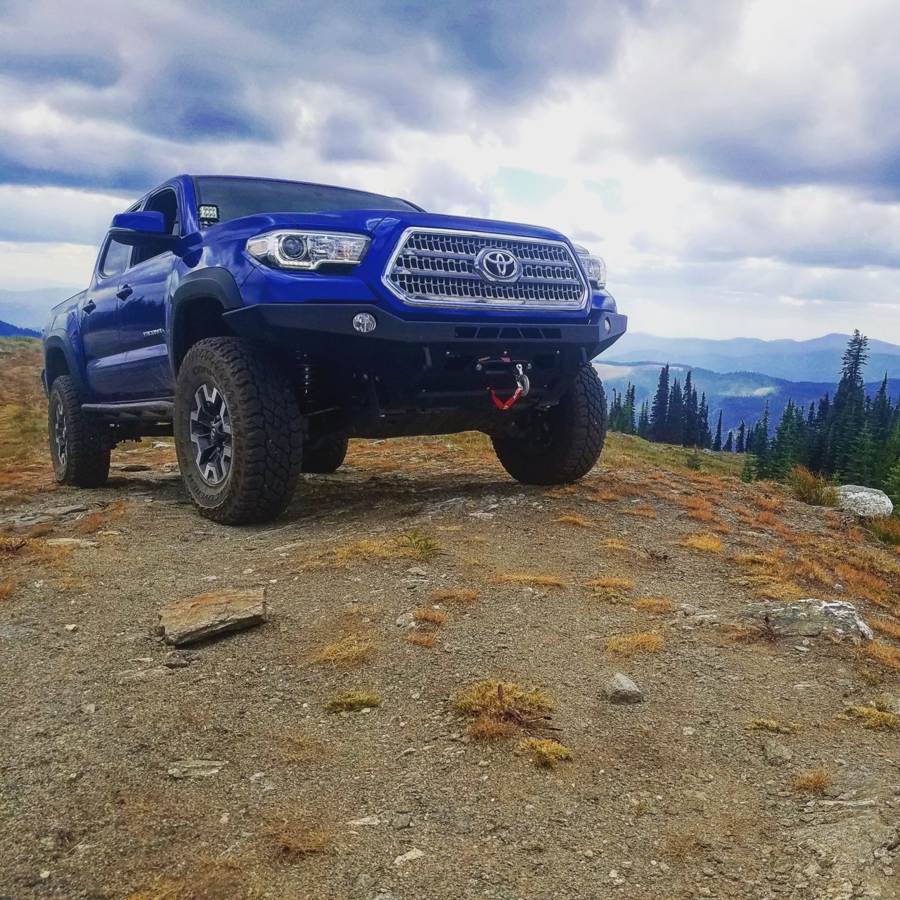

    I love the fact ADS suspension is becoming more popular. I was scouring the forums months ago, looking for info on my current set up and had little luck. Glad to revisit this thread and see current gens running ADS!
