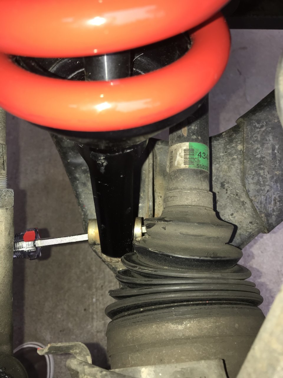

    Well fuck these misalignment spacers. That’s not going to fit in a million years.:mad:

    Don't know. I bought these used and had them rebuilt. PM'd the user I bought them from but they must have been used with aftermarket LCAs. Pretty much $1,400 paper weights right now. What a joke.

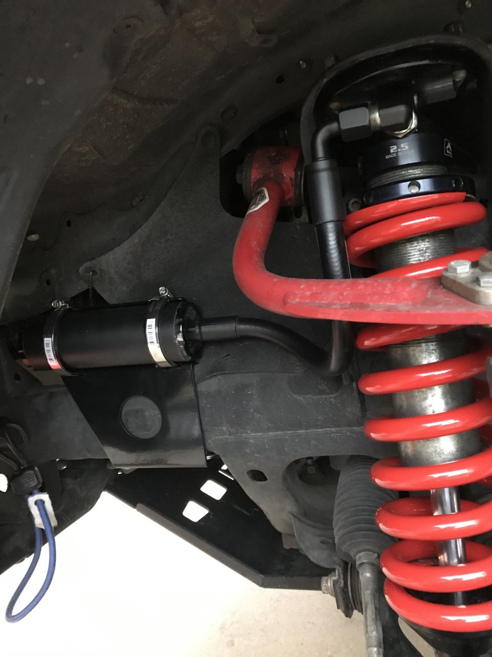

    In addition to the misalignment spacers. I don't know how I'm going to get the reservoir to mount. Without it even tightened down the hose is contacting the coil and is terribly kinked. Never buying used coilovers again.

    As far as the reservoir hose goes, you should be able to rotate the fitting clockwise just a little to push the hose away from the coils. And if needed, rotate the reservoir to help push the hose outward.

    I understand the fitting, seen a lot of guys do that in here. Unfortunately it appears the hose is way too long, It's taking all my strength just to force the reservior to stay in the mount. It wants to be in the radiator currently

    This happened to me as well. Make sure the mount is all the way under the sway bar adapter before you tighten then focus on the resi. You literally have to push it all the way forward until it is pushing into the plastic molding very hard.
    You can loosen the neck at the shock head 1/8-1/6 turn and move it to angle upward and you will have max 1/4” of space between the hose and coil. Loosen the joint ever so slightly to get rid of the kink. Good luck man.

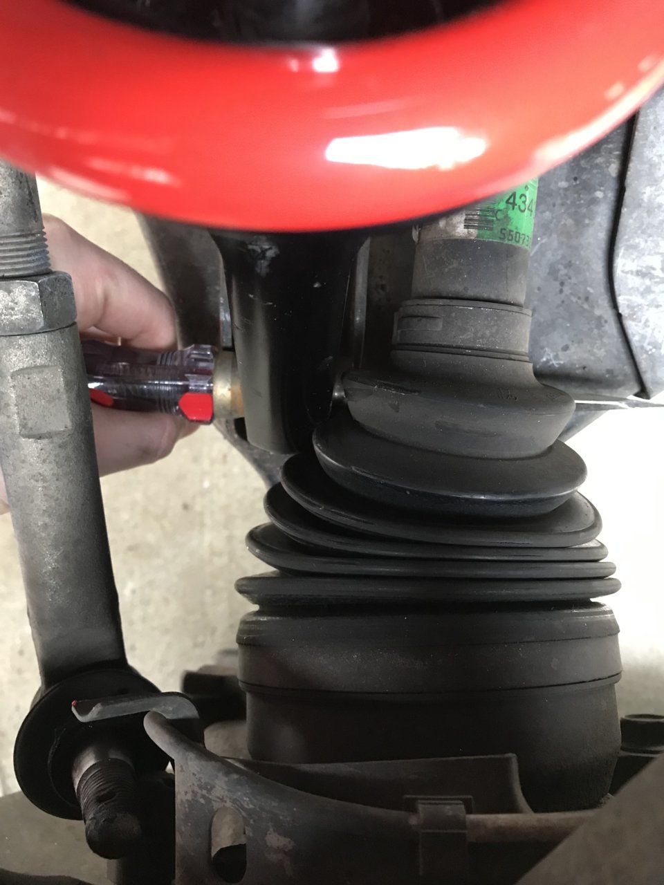

    Well I took the whole coilover out and stuck the misalignments in a vice and pushed one of them in another 1/4 inch. The supposedly knowledgeable techs at DC shock services must not like pushing them in all the way because it's like that on both of them. and I fiddled with the reservoir a little to get it to a place where I'm comfortable, without loosening the fitting yet. Last thing before I can be done with the driver side is I have to reattach the tie-rod end back to the spindle, but the castle nut is just spinning the ball joint even with the tapered end forced in. At this point, not going to be done with 1 side before work. Seems like a whole lot more trouble than it should be.

    Pshh sway bar? what is that? It's one of those ball joints where you used the tapered end to apply pressure so you can torque the nut. There's no allen on the end. I ended up whacking it with a hammer and it stayed. One side is finally on but not torqued. Only took 6 hours :annoyed:

    Nah, stock tie rod ends. It's the moog ball joint that's at the, smaller version of what's on the stock UCA. I dropped the shock out just fine, it just wouldn't fit coming out by being articulated between the tie rod and LCA. So I just swung it out of the way.

    That happened the first time I had my suspension apart (the threaded taper of the ball joint). What was recommended to me when I went for help on TW and what worked like a charm was to start the castellated nut until things begin to spin and then I used a pry bar to put some upward load on the ball joint essentially wedging the taper and the castellated nut against the spindle. With one hand loading and the other ratcheting the nut it went back on. The next time I had my suspension apart I swapped to TC UCA's and got rid of that frickin' ball joint.....
