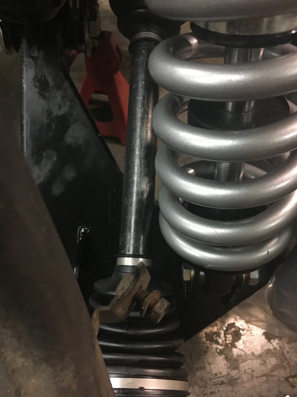

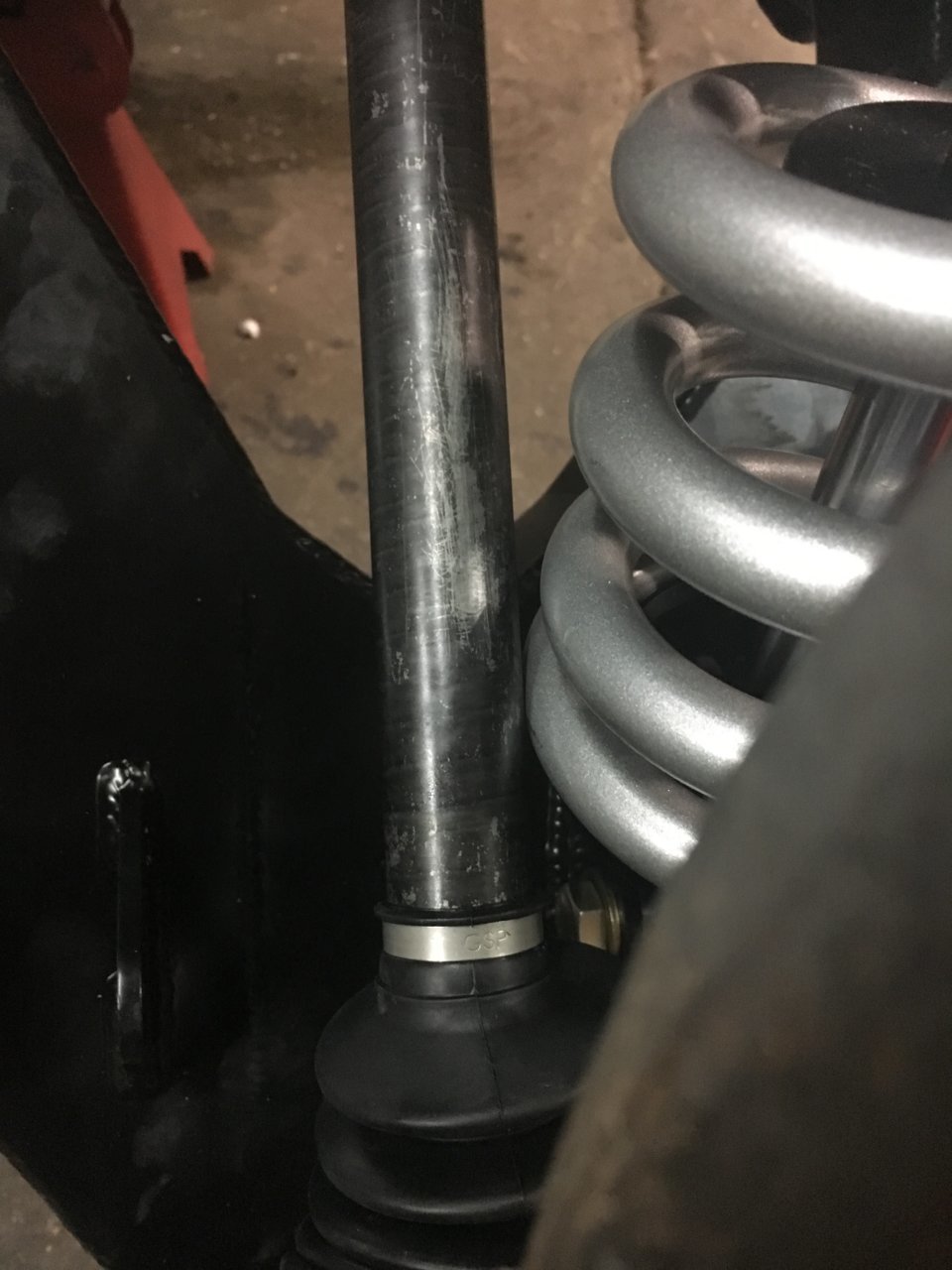

    Installing mine on the 97 taco with the SoloMotorSports LT kit and running into an issue with the axle contacting the bottom of the coils. Anyone else have this issue with the bolt on 8" coilovers? Any ideas how to fix it, quick and simple?
    Also, I'm struggling to find a good mounting location for the resi. I'm thinking that I'm going to have to go up and over the UCA and mount the resi at like a 30 degree angle... Or mount it to the body with the hose running up over the UCA. Any suggestions? THANKS!!!

    Yeah the misalignments are definitely one of the thoughts I had. Hopefully that will be enough to get it out of the axle's way! Hmm curious to see if anyone else has this combo and ran into similar issues...

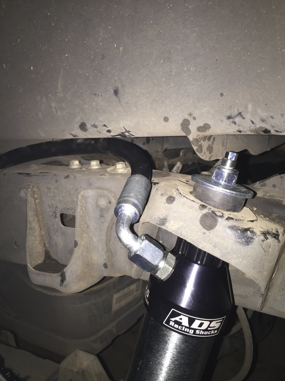

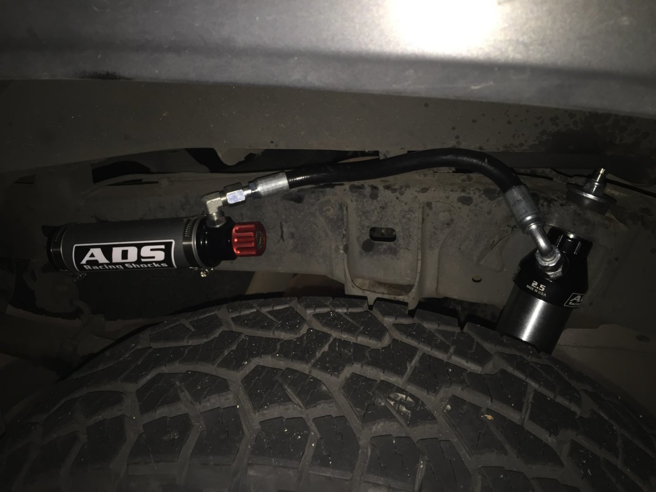

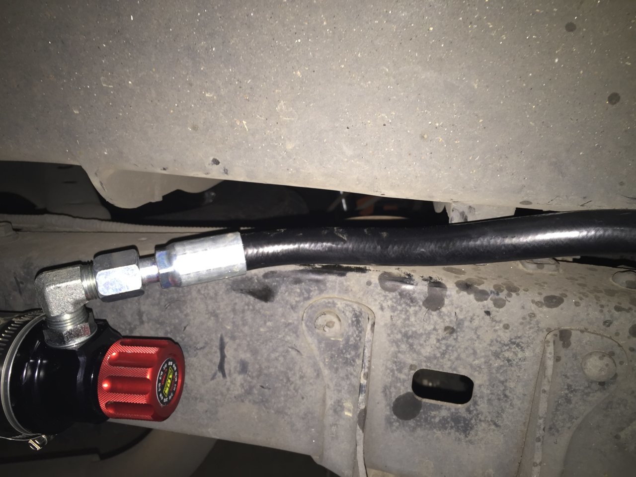

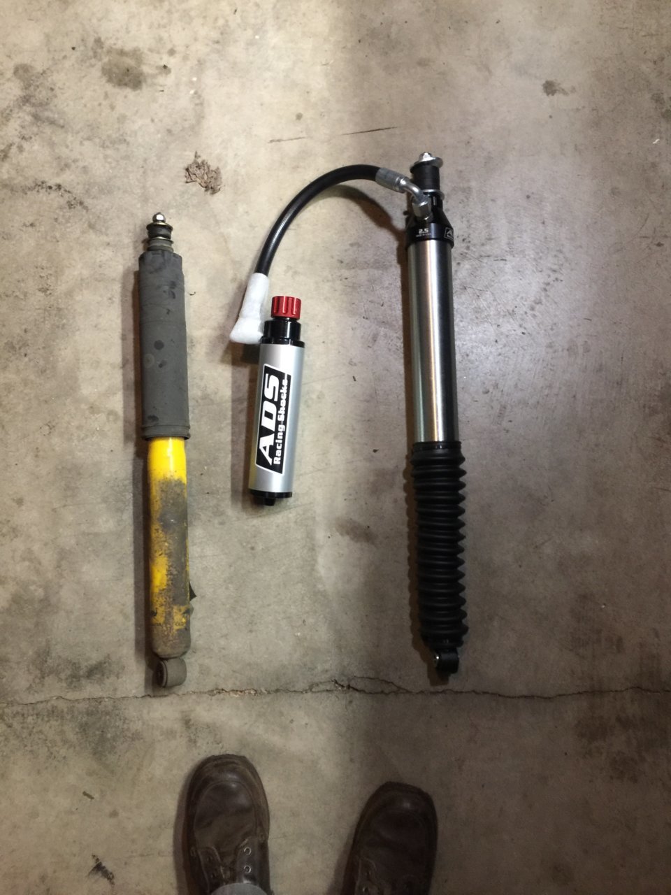

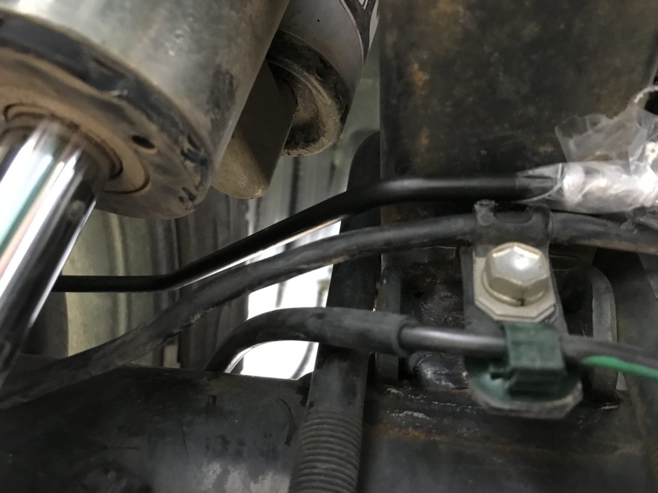

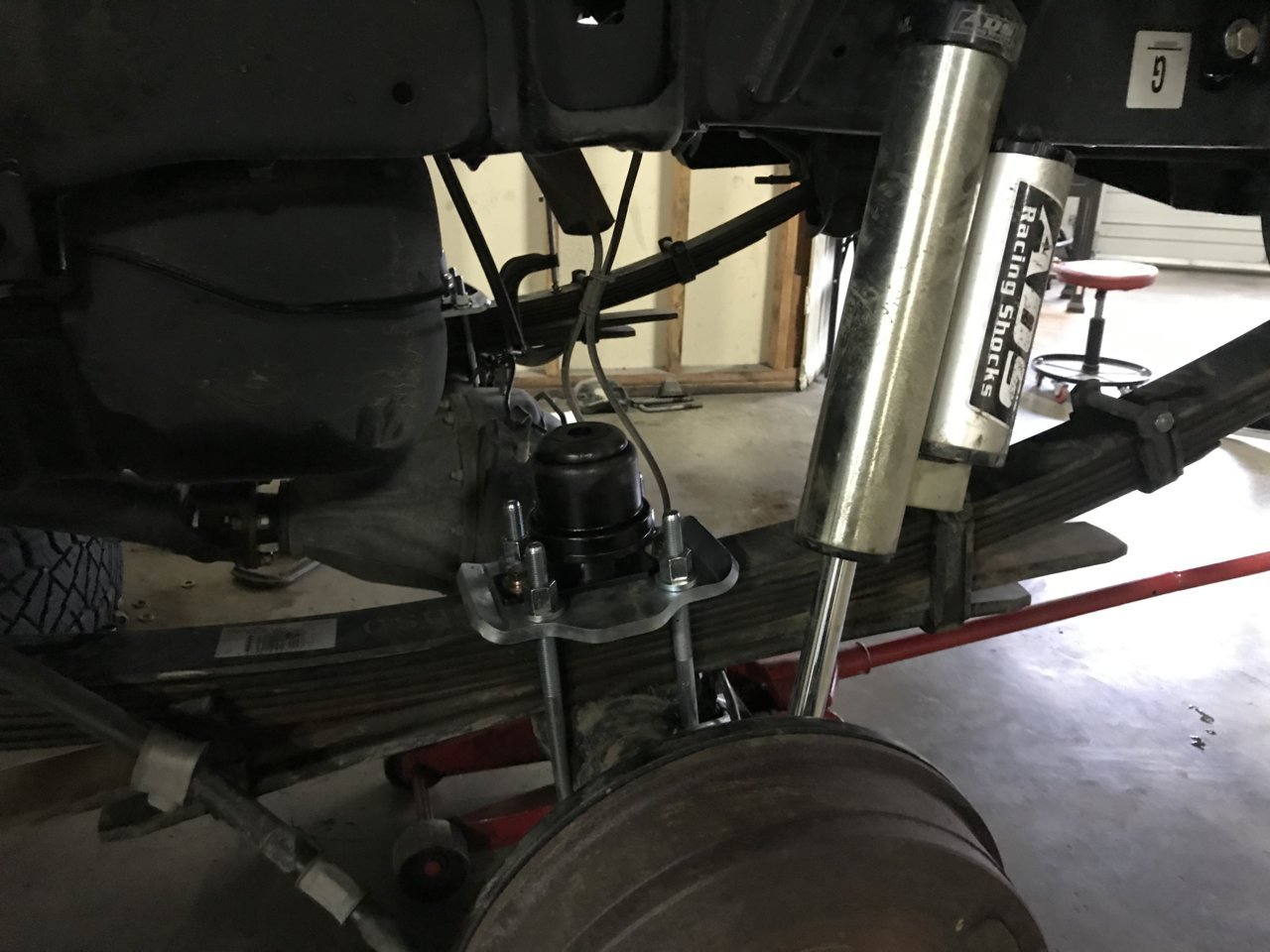

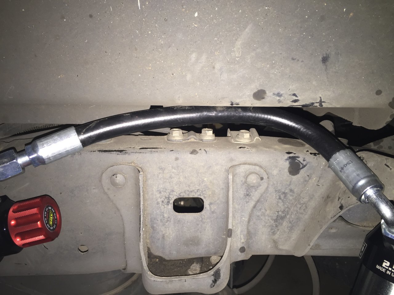

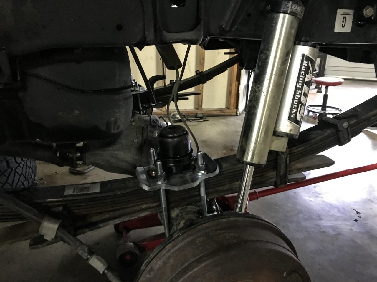

    Finally put my rears on. Only issue besides doing it for my first time and being slow (2hrs), was that I may have mounted the passenger side reservoir bracket a tad low because the hose is a little tight against the frame. I would hate to drill 4 more holes a 1/2” higher, but if it comes to it it’s not the end of the world.
    I definitely need new rear bump stops because the distance between the shock fully compressed and the stock bumps is about 1” less.
    Drove around the neighborhood and could tell the ride was a lot smoother. Any recommendations on good bump stops not too pricey please advise.
    The old emus vs new
    Hose shot driver side
    Passenger side
    How close the side is to the Dakar medium (6-leaf) pack o_O

    The hoses are pretty resilient. They also look a little twisted, crack the fittings and twist the hose to flow a little smoother. Dont have to loosen the fitting much, sometime you can even just get a wrench on the crimp side and move it some. Should solve your problem.

    are you having any issues with the bump plate contacting the shock?

    Good to see you finally got the rears!! I messed up where i placed my reservoir bracket and just moved it but as you said before you didn't like drilling into the frame. It does look a little kinked you can twist the hose by loosening it or move the bracket back further. Once I get my money back from returning my other bumps I am going to try All pro plate with super bumps.

    I am buying the standard euro bumps for the rear because the plate is skinny, not going with the u-bolt flip...im not that hardcore :D.
    I did move the bracket up and filled the old holds with JB weld and the inside of the frame with silicone

    No not at all

    Seems like the u-bolt flip kit does vs the standard for some people with 2.5” shocks

    I have the Wheelers flip kit and it’s far from the plate even when shock is collapsed.

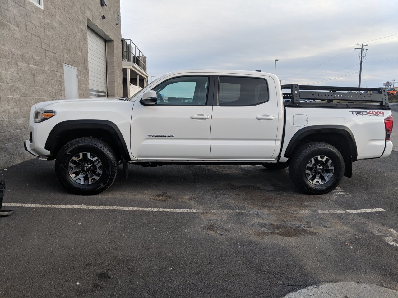

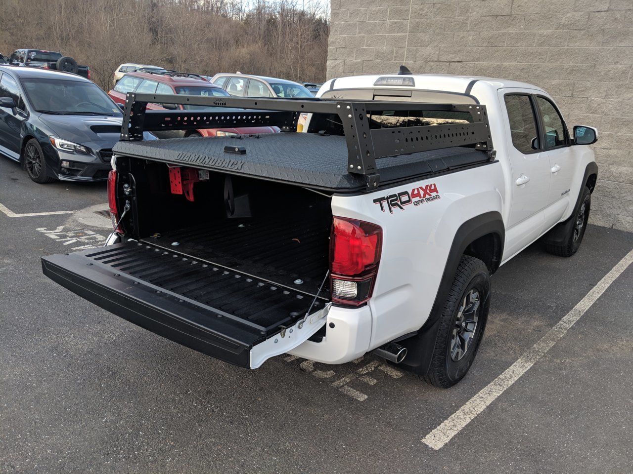

    ADS on all 4 corners, with Icon tubular uniball UCA and Icon 3-leaf progressive AAL.

    Looks great! What’s ur measurements?

    I didn't measure from the hub, but rather the ground to fender arch. I have 37" on the front and 37-7/8" in the rear.
    Basically, 1.5" lift in the front and rear +/- .5". That was from the previous TRD Pro suspension that I had.
    Edit: I did not adjust any of the preload from ADS factory setting.

    I have 7/8” of threads showing and that netted me 1.75” total in the front with my lo-pro bumper. I may end up lowering it in the future, but with the extended travel rears I can’t go any lower back there because there is only 4.25” until the shock is fully compressed. Makes me wonder if I should add that 3rd leaf back in
