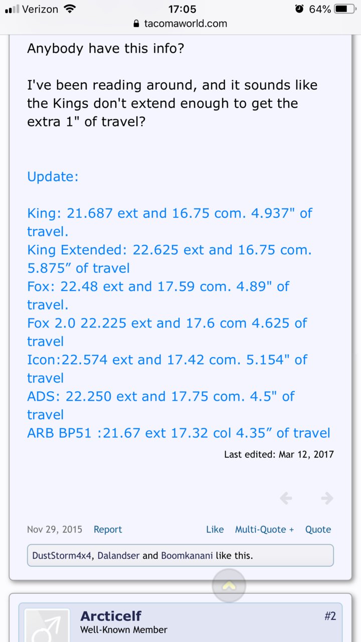

    Here’s the list of shock travel starting with extended for each brand

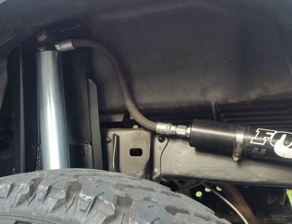

    My bypasses Im trying to install have a 14” stroke with a welded lower rod end to shorten up the compressed length. But I have to relocate the shocks much higher, as shown here with the new shock towers I’ll be using from Archive Garage.

    These are all specs for front shocks, not rear shocks.
    The OEM Tacoma Rears from ADS are a 9.5" travel shock. I dont know what Marie spec'd out for her rear ext length shocks.

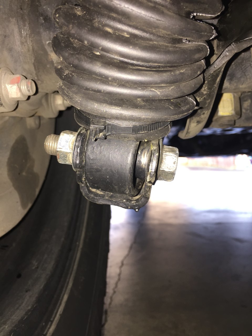

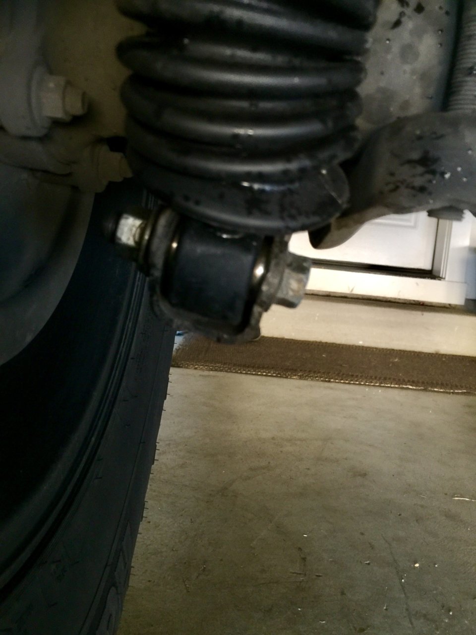

    Here’s another question.
    I assume the lower mounts on the rear shocks are suppose to swivel given they have a ball like attachment in the bolt sleeve. Weird thing is I have driven a bit and the driver side is still crooked. Is this normal?
    Also @HeadStrong Off-Road
    Driver side (crooked)
    Passenger side (straight & normal)
  14. Dec 31, 2018 at 10:28 AM
    #2374
    TACOVRD
    TACOVRD I Identify As A Prius
    Jul 11, 2015
    #159264
    6,437
    TW Addict
    AZ/WA
    2019 T4R ORP - Formerly 2013 DCSB OR Spruce Mica
    Workin' on it....
    Mine are the same, no problems noted.
  15. Dec 31, 2018 at 11:03 AM
    #2375
    SpeySquatch
    SpeySquatch Function over Form
    Mar 6, 2018
    #246516
    7,366
    2016 TRD OR DCSB
    C4Fab LoPro, BAMF Sliders, Ext ADS 2.5’s, 4.88's, OVTune (OG to KDMax)
    Thanks. I assume they will swivel back to center if I hit a bump
