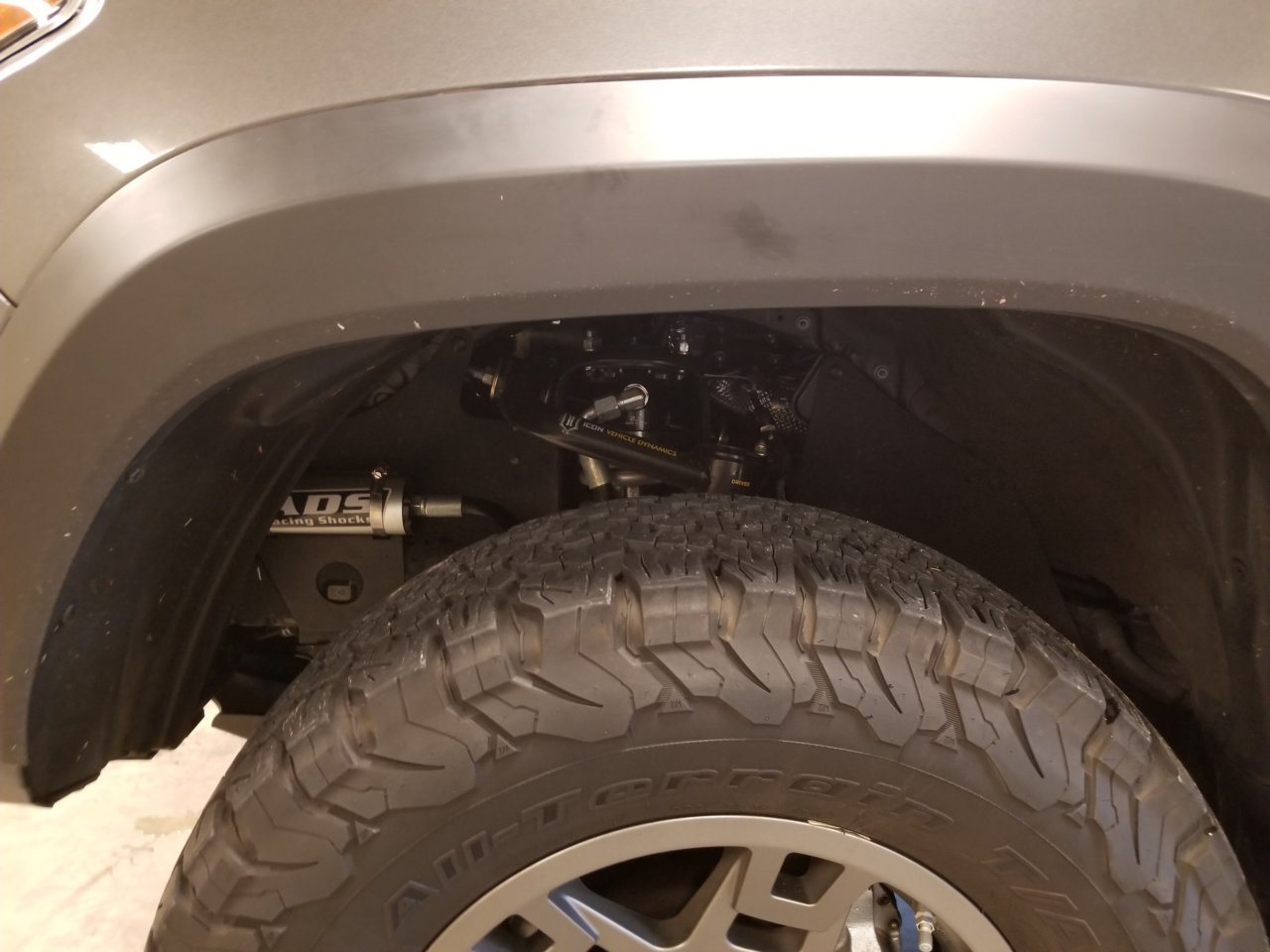

    These came with my front coil overs. I'm assuming the clamps are for the res but what's the black square for?

    SpeySquatch
    SpeySquatch Function over Form
    Mar 6, 2018
    #246516
    7,366
    2016 TRD OR DCSB
    C4Fab LoPro, BAMF Sliders, Ext ADS 2.5’s, 4.88's, OVTune (OG to KDMax)
    Sway bar relocate. Pushes it forward with those new holes so it doesn’t hit your bigger badass coils

    Frawstme
    Frawstme Well-Known Member
    Aug 27, 2018
    #264315
    125
    Oh, okay. Thanks! I was hoping they were to mount the res on, lol I have no idea where to put them without a extra mount. I see some different locations but I don't know the best setup, i'll be running 33's and I don't want anything to rub.
