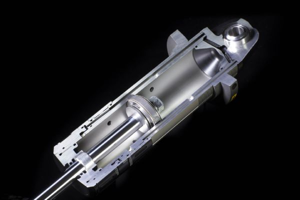

    Don't get me wrong, I'm all for the newbies asking questions and even asking for consumer advise when trying to understand purchase decisions.
    What does rub me wrong, is when the answers they get are full of misinformation and don't fit the use-case of the person asking. Like recommending a race-quality shock only because they ride nice and provide good lift for example. There are plenty of options out there that will accomplish those two tasks for less money and these are expensive pieces of equipment. Giving bad or unfounded advise for someone who's never purchased a 2.5 coilover and isn't prepared to learn how they work just isn't ground for helping out anyone new or unfamiliar with suspension systems and their maintenance.
    For your use, I'd recommend taking a good look at the BP-51s. To my knowledge they are an internal-bypass shock and that's why the piston diameter is smaller. Both the BP-51s and ADS coilovers are tune-able however the BP-51s do so by adjusting the amount of oil that bypasses piston and ADS coilovers require dismantling to change out shim-stacks for the piston for adjustments if you don't have clickers (although clickers function differently in fine-tuning). So if you are tough on your suspension and are looking for a rebuildable 2.5" performance coilover, then ADS is of the utmost quality. However, if you're not comfortable removing and servicing shocks after certain mileage or off-road use and just want a well-rounded suspension system, then the BP-51s will serve you better and you can play with the compression and rebound settings to your heart's contentment. Here's a cutaway of the BP-51 VS. an IFP shock such as one found in a 2.5 coilover. gawdamnit I didn't want to type this much.
