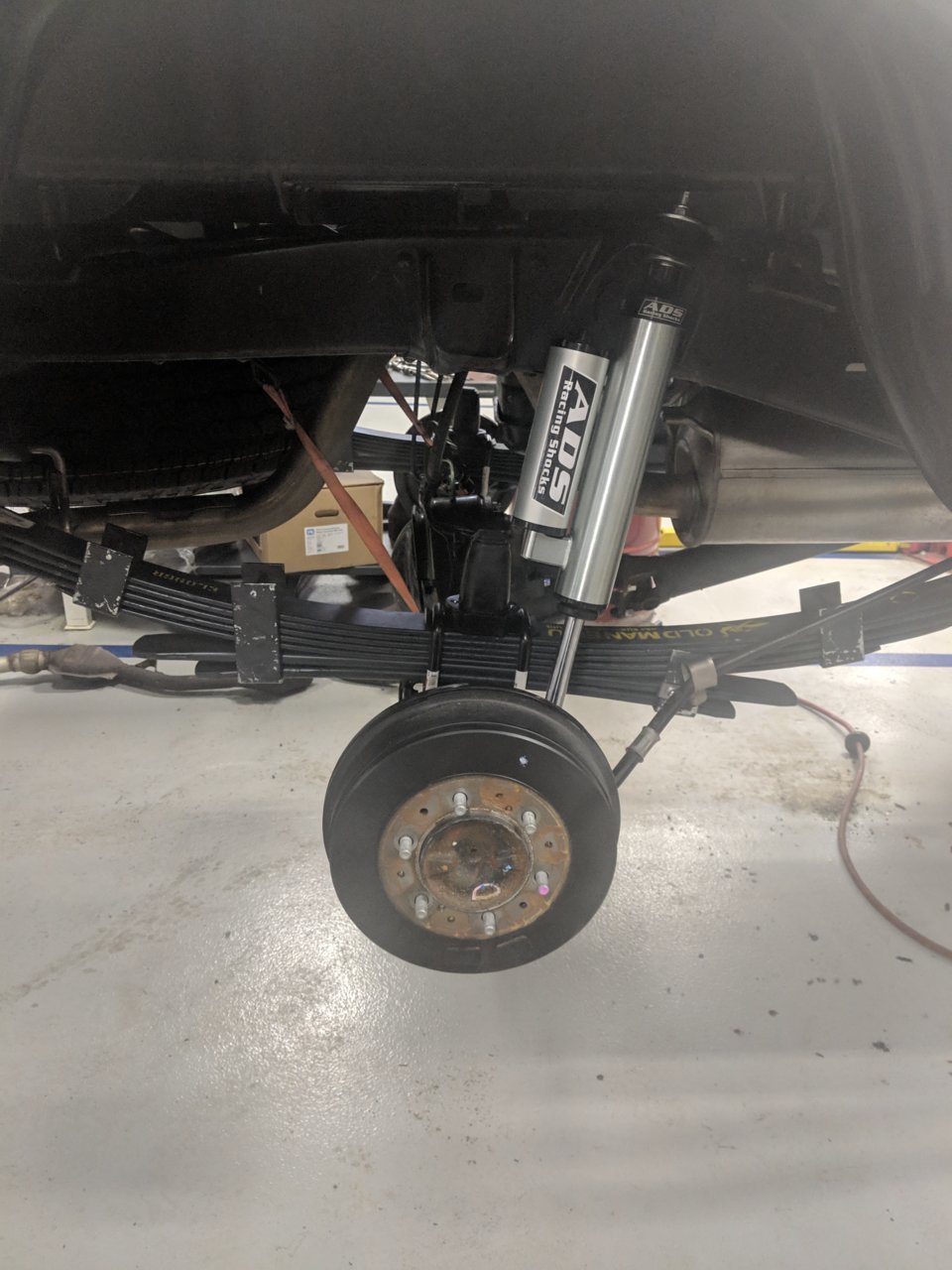

    Just curious,
    why do you have limiting straps on the rear axle with a Dakar pack?

    It was temporary until we had everything tightened up

    How does it ride?

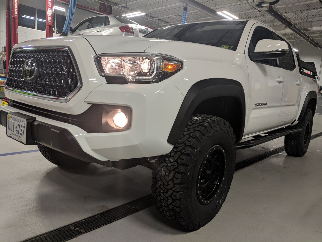

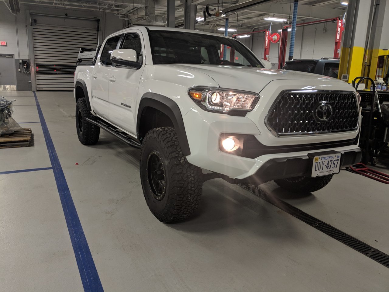

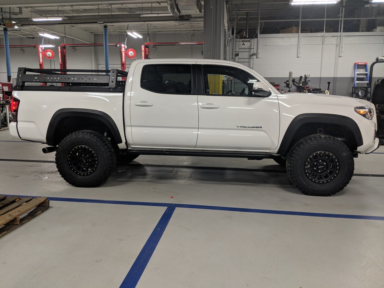

    Woooooooo took all day but man I'm happy

    Funny how long it takes huh? Some guys on here seem to be pros and can speed righ they it. Truck looks great! What tire size?

    Thank you! I went with 285/75r16

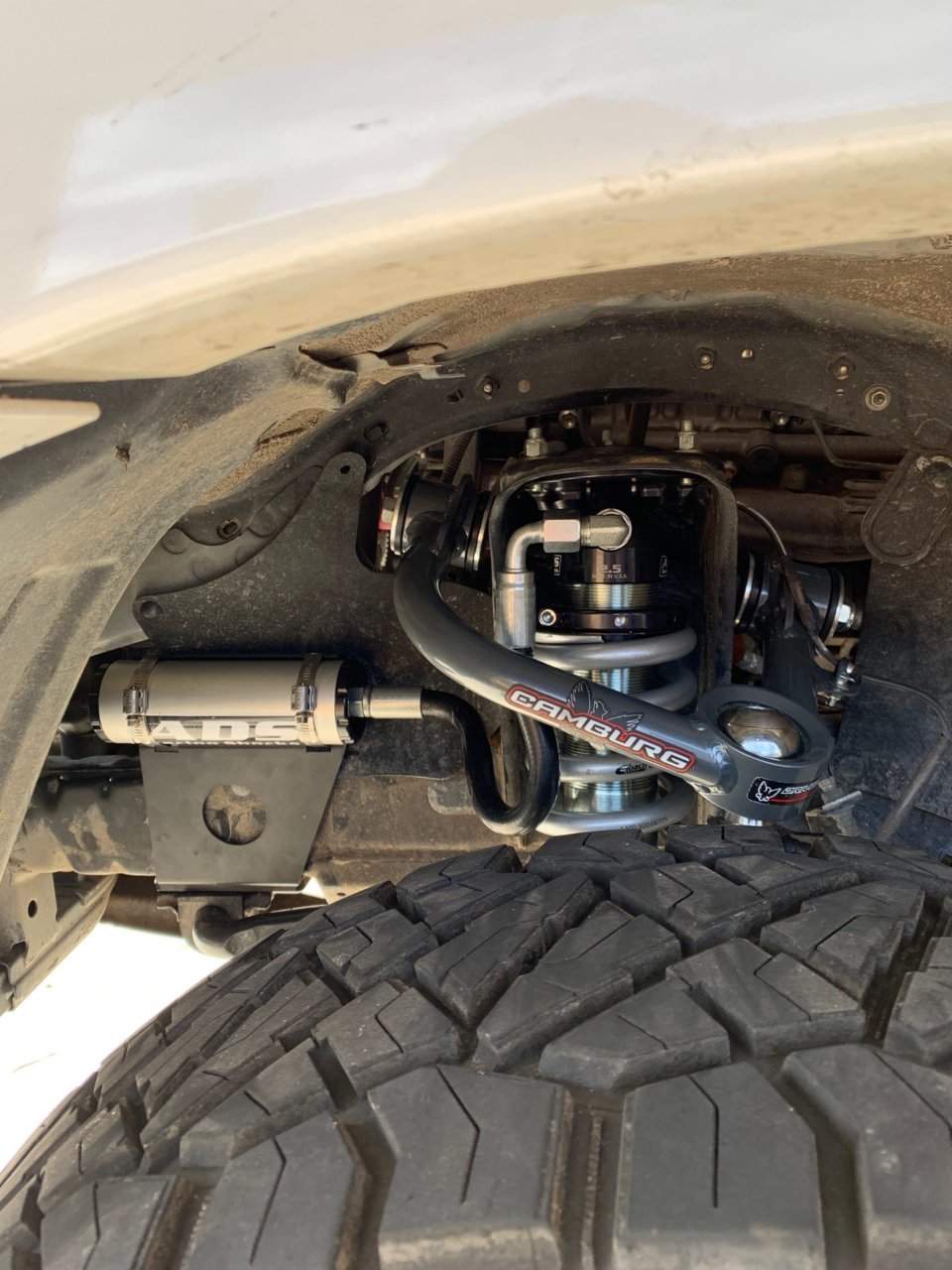

    Ran through the whole install yesterday and everything went pretty smooth. Noticed the difference immediately after leaving the driveway. Going to let the setup settle, make a few adjustments, and then will test it out on some trails in a few weeks. 56901912805__55F61713-6150-49D2-B980-7599622BD038.jpg

    Your resi hose seems to bend weird...maybe you put the resi brackets on backwards (see attached) Looks good otherwise. :thumbsup:
