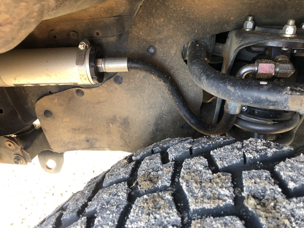

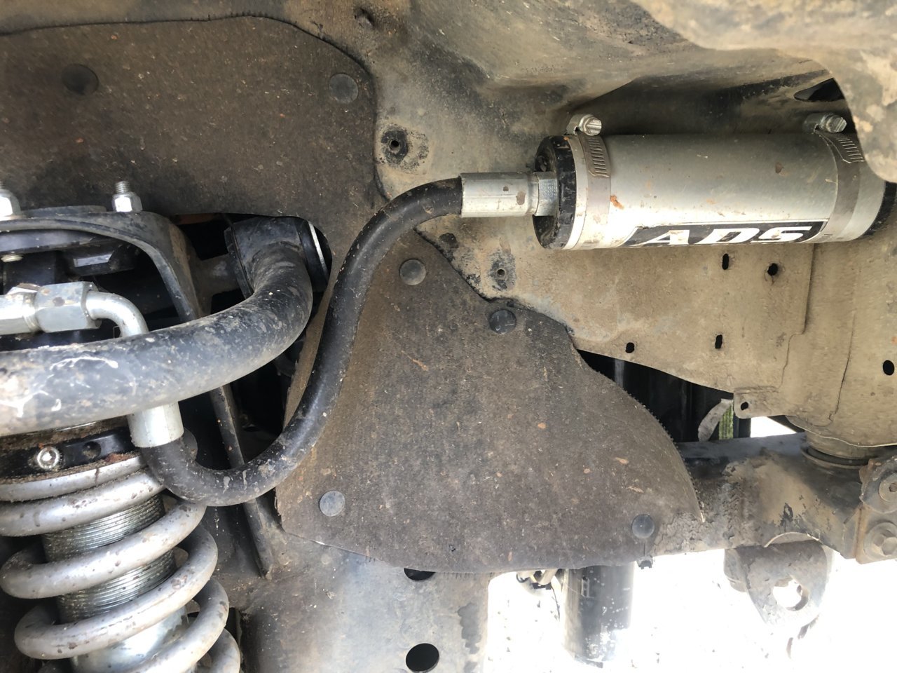

    Do my hoses looked kinked to anyone?
  16. Jan 16, 2019 at 7:40 AM
    #2576
    rmepilot
    rmepilot Well-Known Member
    Jun 22, 2013
    #106798
    11,006
    Rob
    Huntsville, AL
    '23 LR DCSB TRD OR 4x4 Premium Pkg
    2019 Jeep GC Summit 5.7l '15 DCLB S/C 4x4 Limited Pyrite Mica - Deceased
    No, but I'd be a bit concerned with chaffing on the spring. Over time, that will create a wear spot in the hose.
    SpeySquatch likes this.

    I think it’s turned slightly from when I first mounted them. I’m fairly certain it was clear of the spring, but just barely. I didn’t notice that until I took the picture
    rmepilot[QUOTED] likes this.

    Hard to tell from that angle, but you always want hoses/lines pulled away from other components. Even vibration can cause wear over time.
    kuntry09[QUOTED] likes this.

    If you loosen the hose clamps and turn the resi until the decal is facing outwards, I think that will pull your hoses away from the coils. As another poster mentioned earlier, I think ADS has these set up to be installed with the logo facing outwards.
    kuntry09[QUOTED] and nartmot like this.

    yep, my hose sits about 3/16-1/4" from the coil after doing that
    H3llRid3r and Bertw192[QUOTED] like this.
