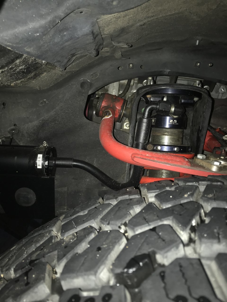

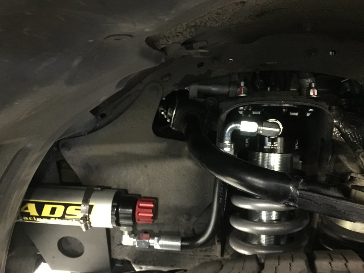

    In hindsight, if I would have know, I would have had right angle fittings put on mine. It would have made it so much easier for mounting.

    Yah mine came like that.

    Clickers get the 90° bend at the resi... poor people get the straight connection.

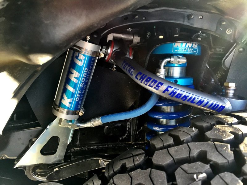

    I just bought some king brackets so I can mount the reservoir vertically to give the hose a more natural curve and keep it away from the coil, like this.

    I think that may work if you have clickers, but if your hose takes a straight shot into the resi, I don't see that working.

    Yeah I have my fingers crossed, because right now the tension I have on the hose is bending/torquing on my fittings and won’t stay in the hose clamps. Mine seem to have really long hoses.

    Looks about the same length as mine

    Same here. I installed the resi's on the mount and then rotated the mount up to the truck. This gave me more leverage on the hose and kept everything aligned.

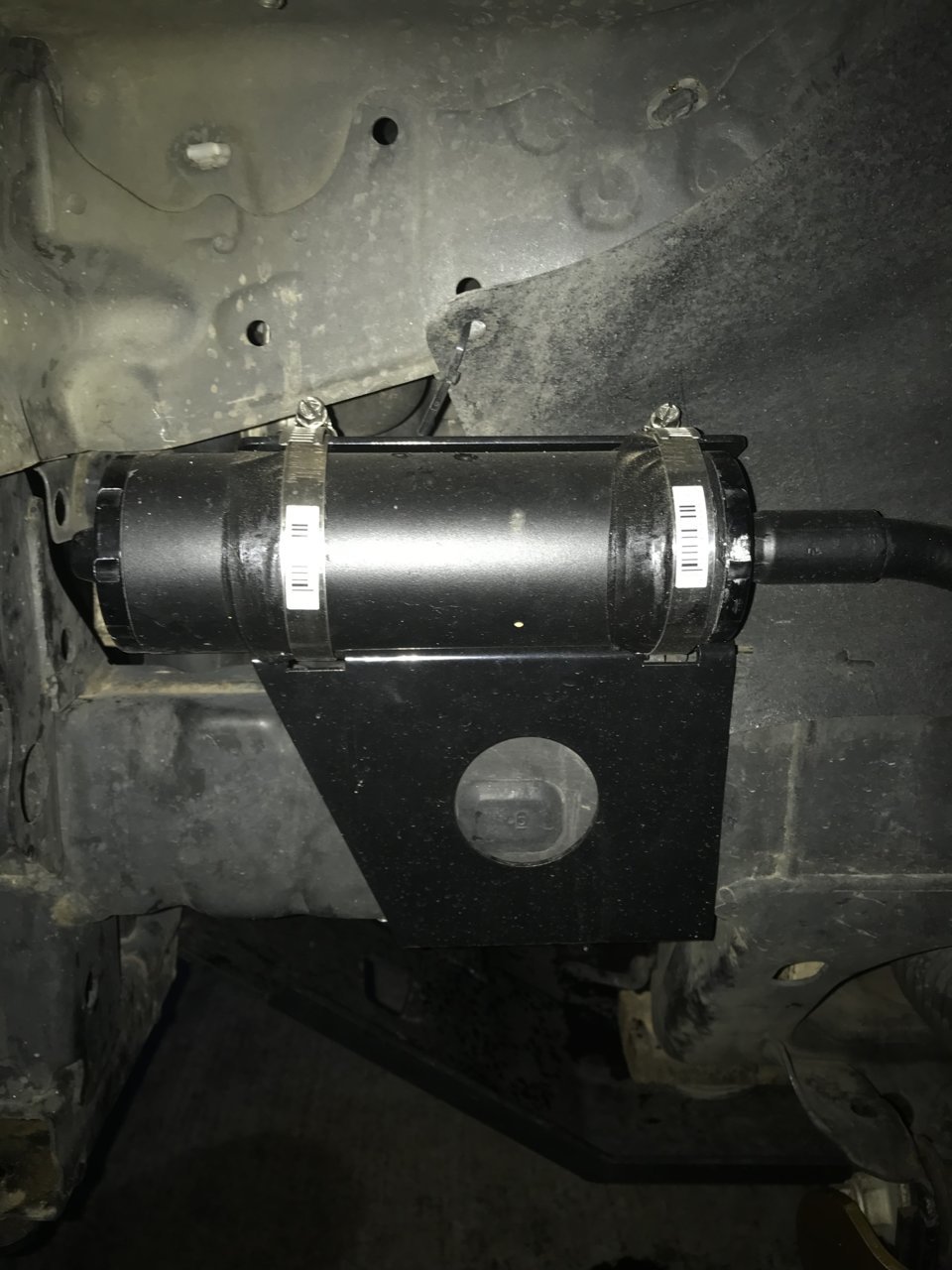

    Yeah I tried that too, like I said, way too much tension. After two days and torquing the hose clamps with a ratchet, the reservoirs pushed out of the clamps and into the radiator support. Stuff is gonna break if I keep it in the position. I’ll take a pic in a few.

    I loosened mine just slightly and turned the fitting at the reservoir so it isn't near the coil anymore.

    Mind you, it pushed out of the double sided tape I had added also, After using a 1/2 drive ratchet to tighten the hose clamps. The elbow fitting was also level when I installed, now it is not.

    That’s exactly what mine looks like

    I don't like it. Sub-optimal IMO. :ballchain:
