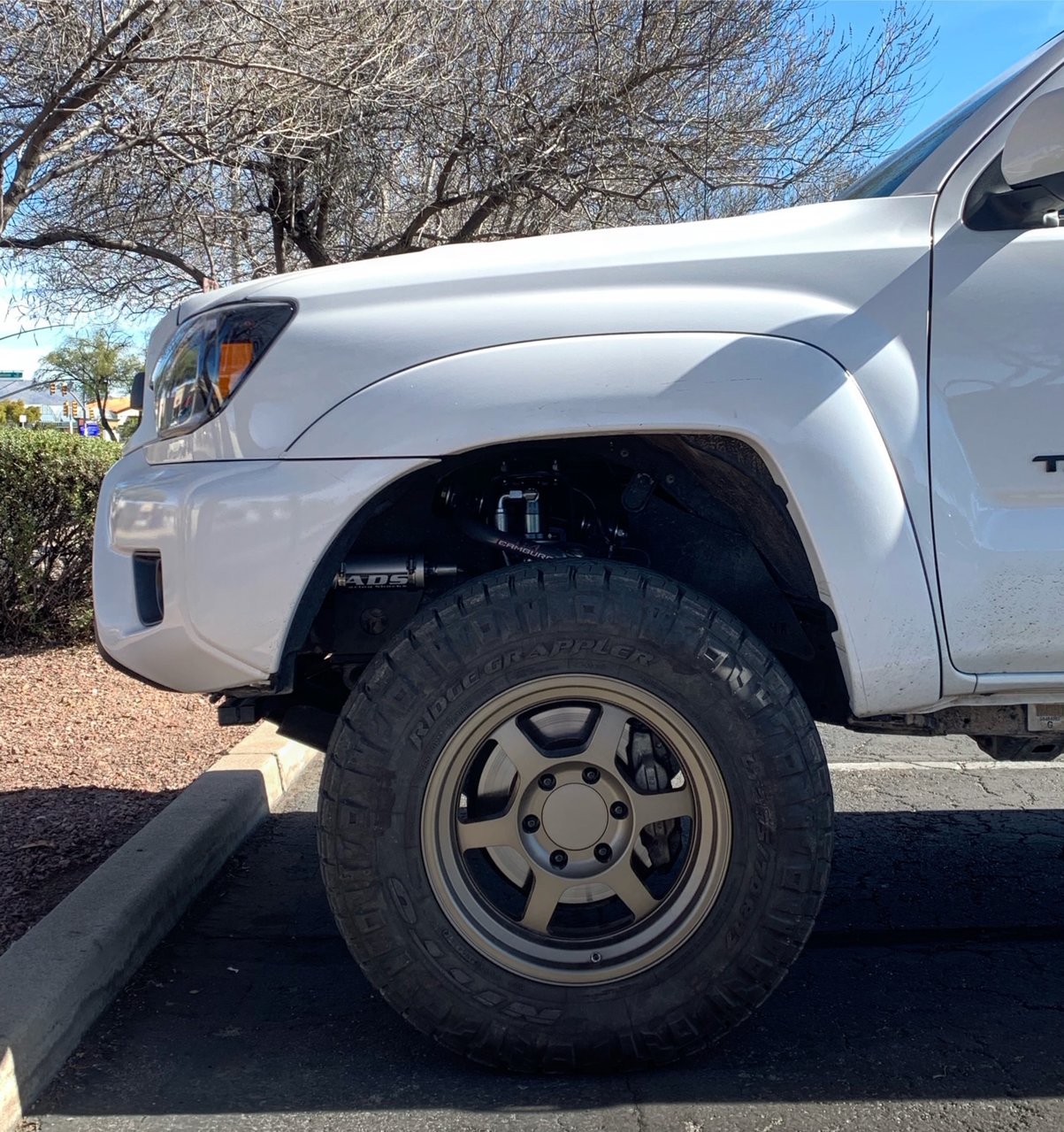

    Love the lift so far. Made my Nittos look small though and I only have 3k on them... sigh :rolleyes:

    Don’t worry about how they look. Those tires will perform fine dude. Don’t get the 33” BS “for looks” addiction. Function over form my friend. Looks fine.
