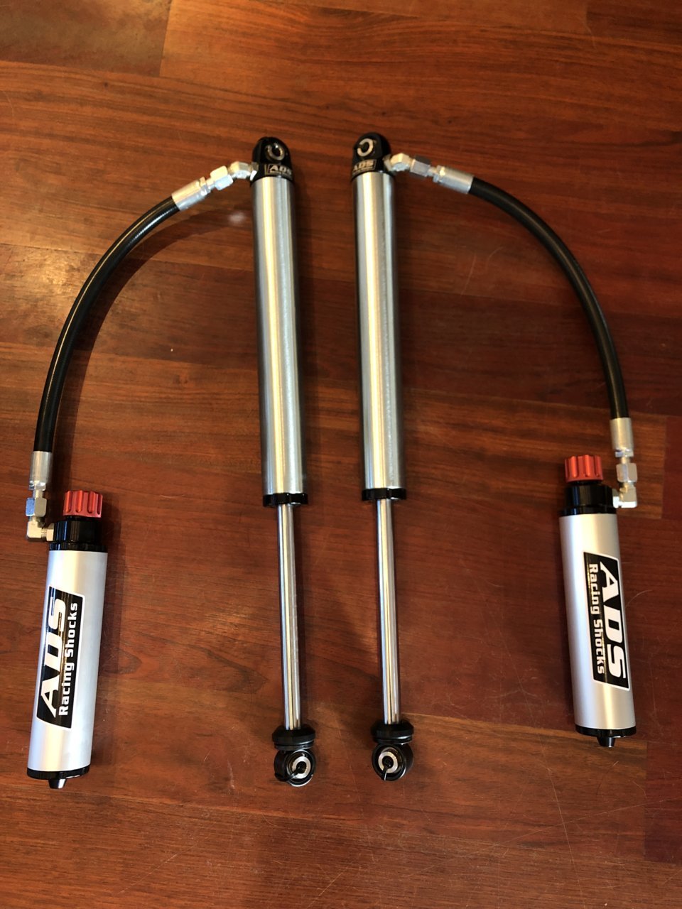

    My ADS 2.125's showed up today. Going to get them on the truck tomorrow, can't wait :D

    These are for my Total Chaos outboard relocation. 2.125 bodies with 10'' travel. 28 3/8th inches extended, 18 3/8 inches collapsed.
