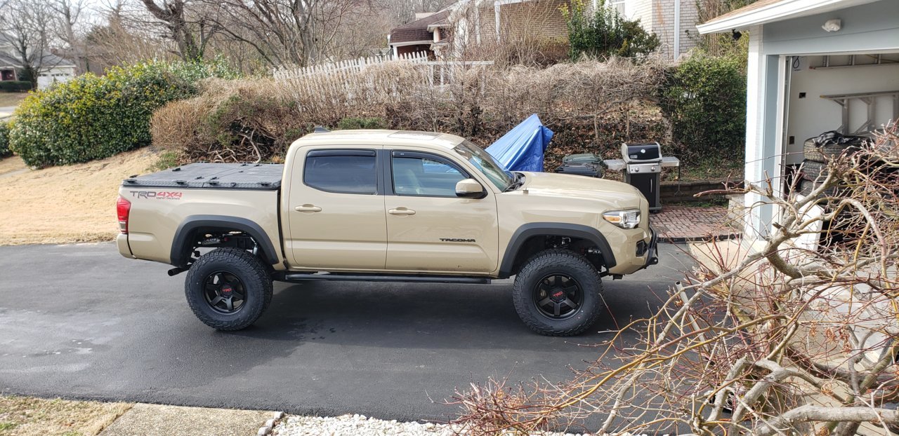

  13. Mar 12, 2019 at 7:31 PM
    #2713
    SpeySquatch
    SpeySquatch Function over Form
    Mar 6, 2018
    #246516
    7,366
    2016 TRD OR DCSB
    C4Fab LoPro, BAMF Sliders, Ext ADS 2.5’s, 4.88's, OVTune (OG to KDMax)
    What leafs are you running in the rear? Tire size as well please
  14. Mar 12, 2019 at 7:55 PM
    #2714
    Chewy16
    Chewy16 Well-Known Member
    Aug 3, 2016
    #193673
    76
    Northern Virginia
    '16 Tacoma TRD Off-Road
    OME HD Dakar. 285/70/17 17x8 0 offset.
    SpeySquatch[QUOTED] likes this.

    It may just be the angle but that thing looks sky high in the back :eek:
  16. Mar 13, 2019 at 5:45 AM
    #2716
    Chewy16
    Aug 3, 2016
    #193673
    76
    Northern Virginia
    It's partially the picture angle, driveway angle, conservative lift up front, and the truck bed is completely empty in this picture and the spare also wasn't attached. But yes, she's definitely arching her back in this pic.
