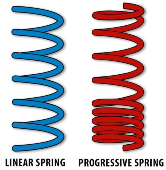

    I’m talking about progressively wound springs that change rate through their travel. On a linear rate spring there is no multiplier, a 700 in/lb spring will deflect 2 inches under 1400 lbs and 3 inches under 2100 lbs and so on.
    A progressive spring has tighter or looser coils throughout its travel and alters the overall spring rate depending on force applied.
    An exaggerated example:
    That’s shocks, not springs.
