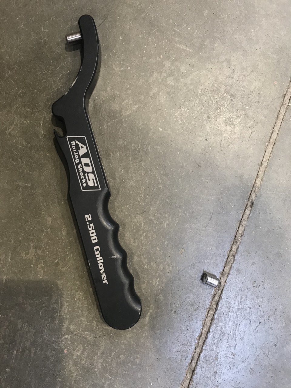

    Yah... that tools kinda sucks. Once it turns around to a certain point it’s really hard to keep turning due to the space. Many use a 3/16” punch
    We’re you adding or decreasing?

    Holy cow. I love that tool. Made adjusting my 700lb coils easy as cake.
    I'd call ADS and ask for a replacement - that has to be defective.

    Got my ADS installed today and my tool felt like a piece of crap too. You could feel the end-pin starting to bend, and I had only used it for a handful of turns. Ended up using a punch which worked way better. Waste of $30.
    Oh, and I had used your guys' recommendations for starting at 1" of exposed threads. I ended up with 4" of lift lol. Took the tires back off and spinned them back 3 rotations, now it's at a nice 2.5" after a tad of settling.

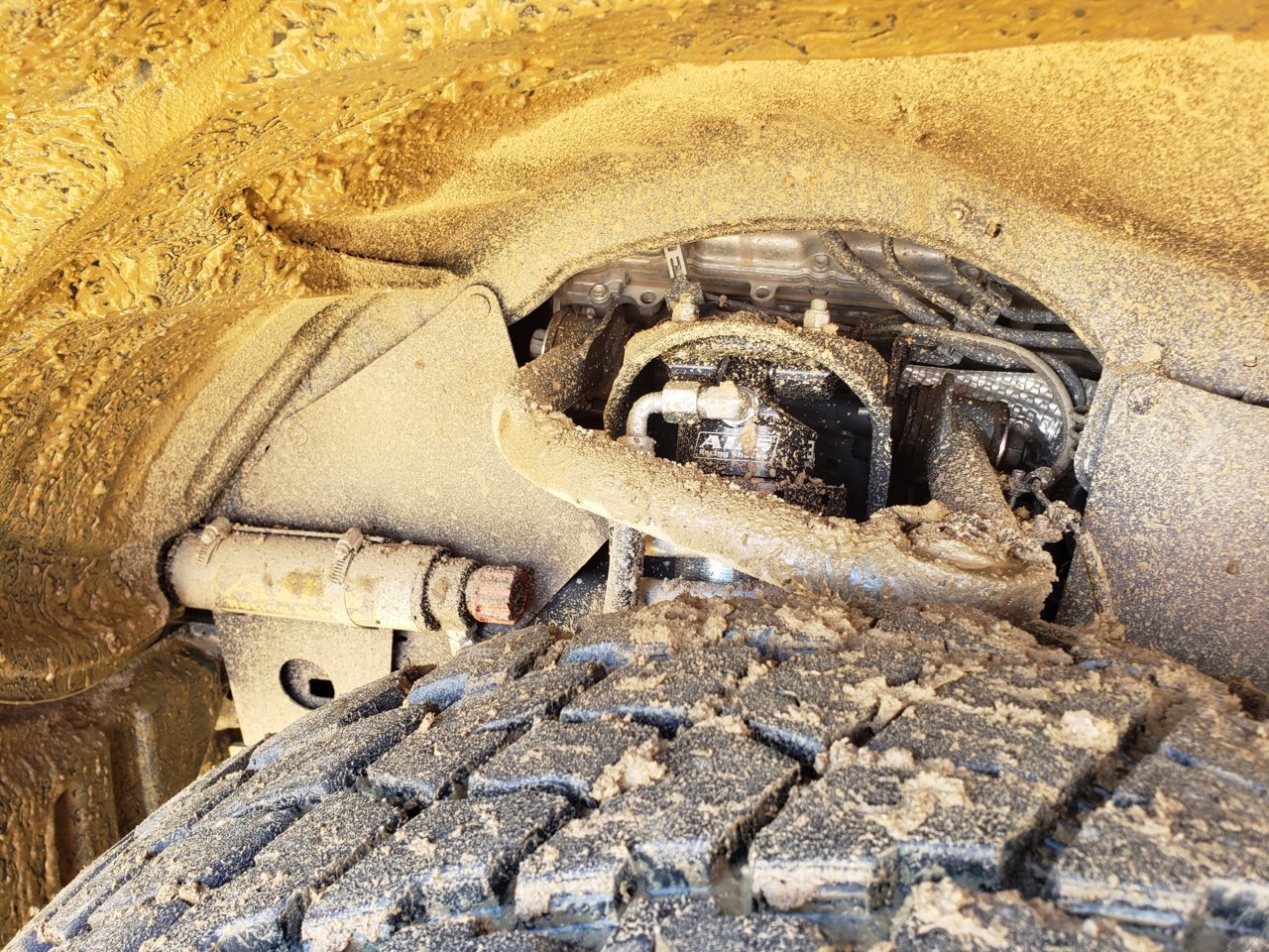

    @ADSracingshocks - F 3 point ohh / R 2.5 - w/clickers @camburgracing - uniball UCA @rigidindustries - 40" amber/white split, Dually XL, D2 @coopertires - 35/12.5/17 STT MAXX @bayareametalfab - low pro bed rack @toyotausa - 17" rock warrior @sdhqoffroad - rock sliders, a-pillar @hondogarage / @apple / @gaiagps / @dualgps- navigation @wheelersoffroadinc - superbumps
    Not a taco, but still in the family :)

    That mud looks like it has some clay in it. Looks like a bitch to clean when it dries

    It was a pain in the ass the clean off the next day. Should have turned around much sooner, hate that shit.

    I was trying to increase because I just installed a steel bumper so I was trying to get another inch of lift and I barely got one turn. I tried using a punch before but it started to deform the dollar and I was trying to avoid deforming it anymore.
    I will probably contact them and see what they say, Love their customer service.
    Yeah it does not feel like a very sturdy way of adjusting, I felt like it was gonna break when I was pulling and thought it has to be stronger than I think and then it snapped luckily the pin didn’t get stuck in the collar.

    Talked to ADS about the spanner wrench and they don’t even suggest using the spanner wrench to adjust the coil overs. The guy suggested I use a spring compressor since there is around 1400lbs of pressure on these springs.

    So...is the wrench just for opening beers? Most expensive bottle opener ever

    I understand the CYA comment of using a spring compressor but geez, it shouldn’t frickin break. I’ve adjusted mine a few times with the truck jacked up and the suspension at full droop. Copious amounts of WD-40 on the threads of the shock body and no issues changing preload with the spanner.
    That sucks man.
