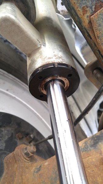

    On our family vacation for the summer and noticed my rear driver shock is leaking. I texted Matt at MCM right and is going to send new seals right away. Hopefully this is a one off and i have no more problems with it.

    your seal is leaking cuz there is a giant pit in the shaft. you can see it in your picture about 2" down on the right side

    It looks worse than it is. Its just the coating. And it started leaking while driving on the highway not doing trails

    It looks pretty bad... and considering that it is within the first few inches of up travel it is likely cycling through the seal even during daily use which is whats eating the seal up. If this were a shock we were rebuilding we would recommend putting a new shaft on it.

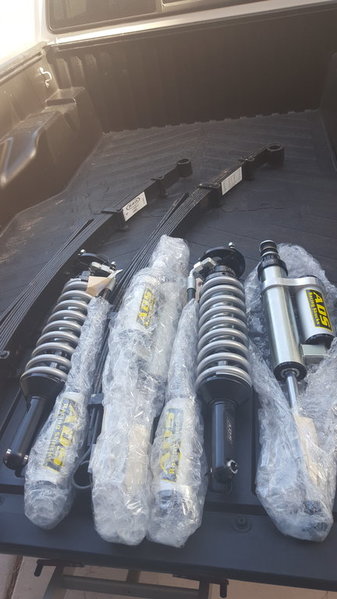

    Some of my goods i grabed from Matt @MCM this morning still waiting on a couple of things.

    I will try just the seal first. But we sand and gravel our roads up here every winter. And if this happens after every small chip its going to get expensive.

    Cliff hit the nail on the head. Did you get nitrosteel or hard chromed shafts?

    I think the hard chrome ones but i have no idea.

    Just finished washing the truck and took a look. And i think your right. There is a nick up high right behind the axle thati couldnt see before. And that looks like where it is leaking from. Fuck

    Until you replace the shaft its going to keep eating seals

    Do the nitrosteel have a coating at all and how will they hold up in damp climates? Ive already messaged MCM to see about new shafts.
