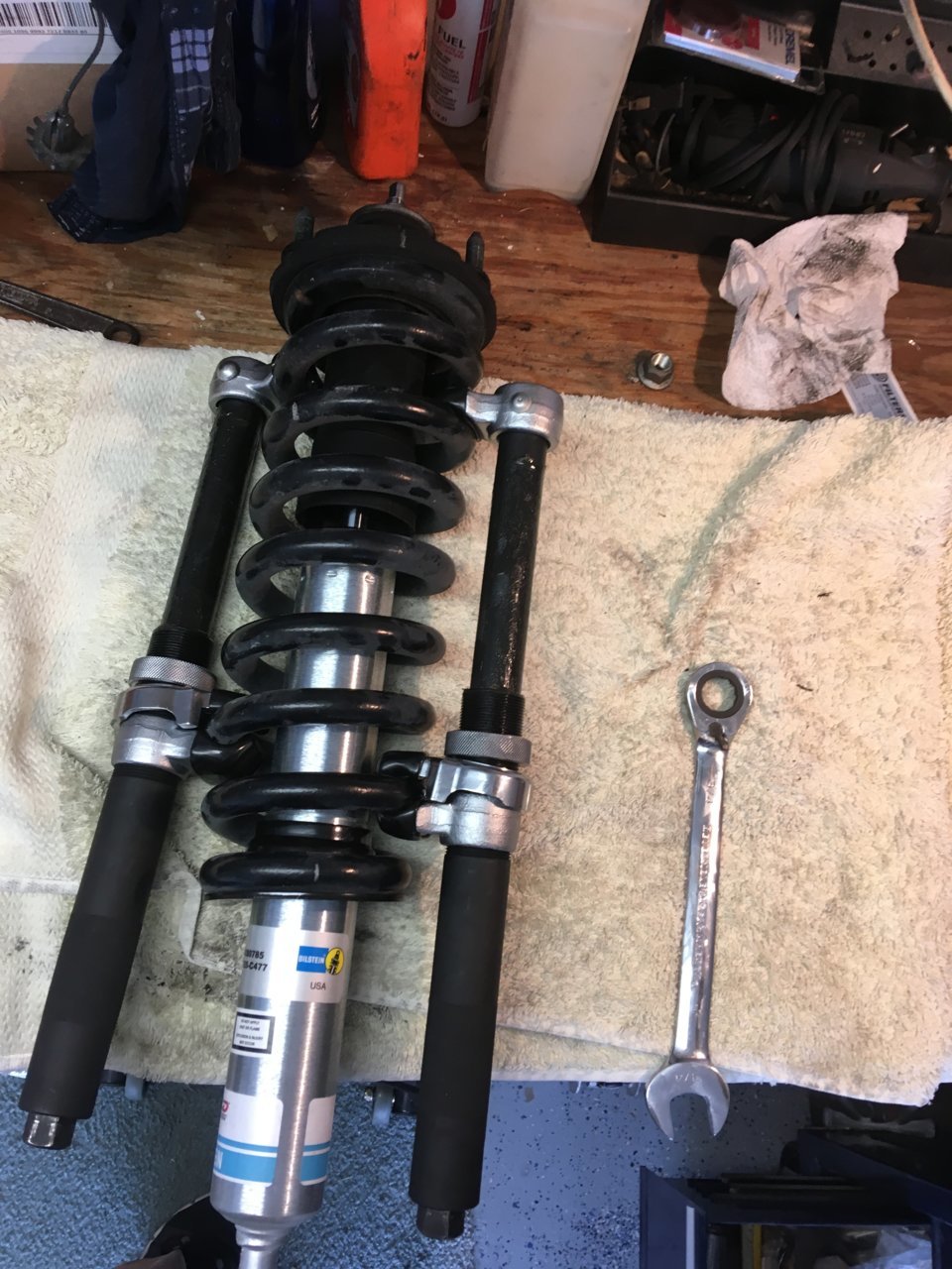

    Yeah, soon as I got mine, helped a buddy swap his stock coils to some billy 5100. They are handy fur sure.D89031D5-1864-4CF2-993D-1B492686791E.jpg

    Wonder if these would work for more than half price?
    https://www.amazon.com/Shankly-Spri...ng+compressor&qid=1553373945&s=gateway&sr=8-6

    Dang. In the video he is using them on an F250 so I thought they would work

    Good eye. That extra clamp is key for a safer experience.

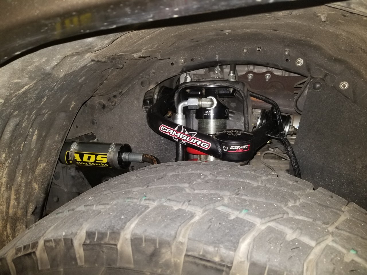

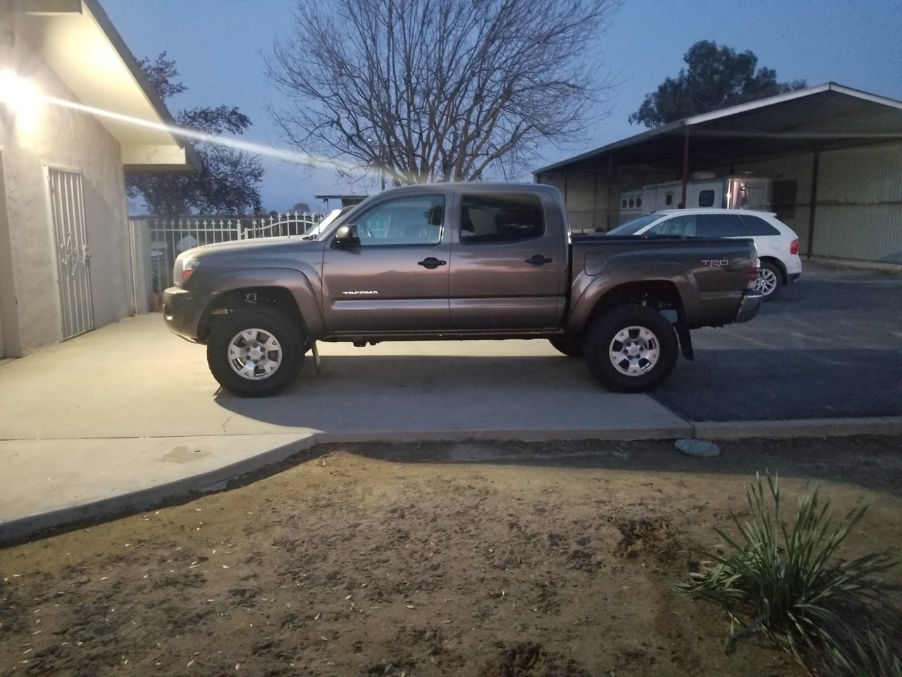

    :woot: oh how I've missed these bad boys. The ride is cush compared to stock. Sittin at 2 1/2" up front and 2 3/4 in the back20190323_193548.jpg 20190323_193532.jpg
