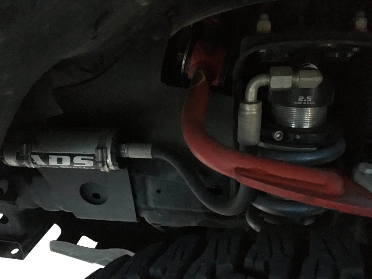

    Twist the cans harder one way or the other and the hose moves in or out, in relation to the spring. I didn’t have to loosen any fittings and it doesn’t move with the suspension.upload_2019-4-25_20-8-59.jpg

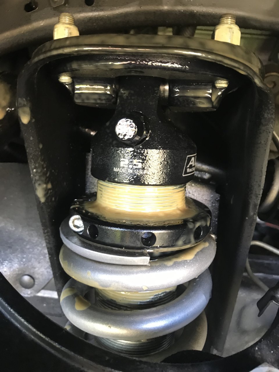

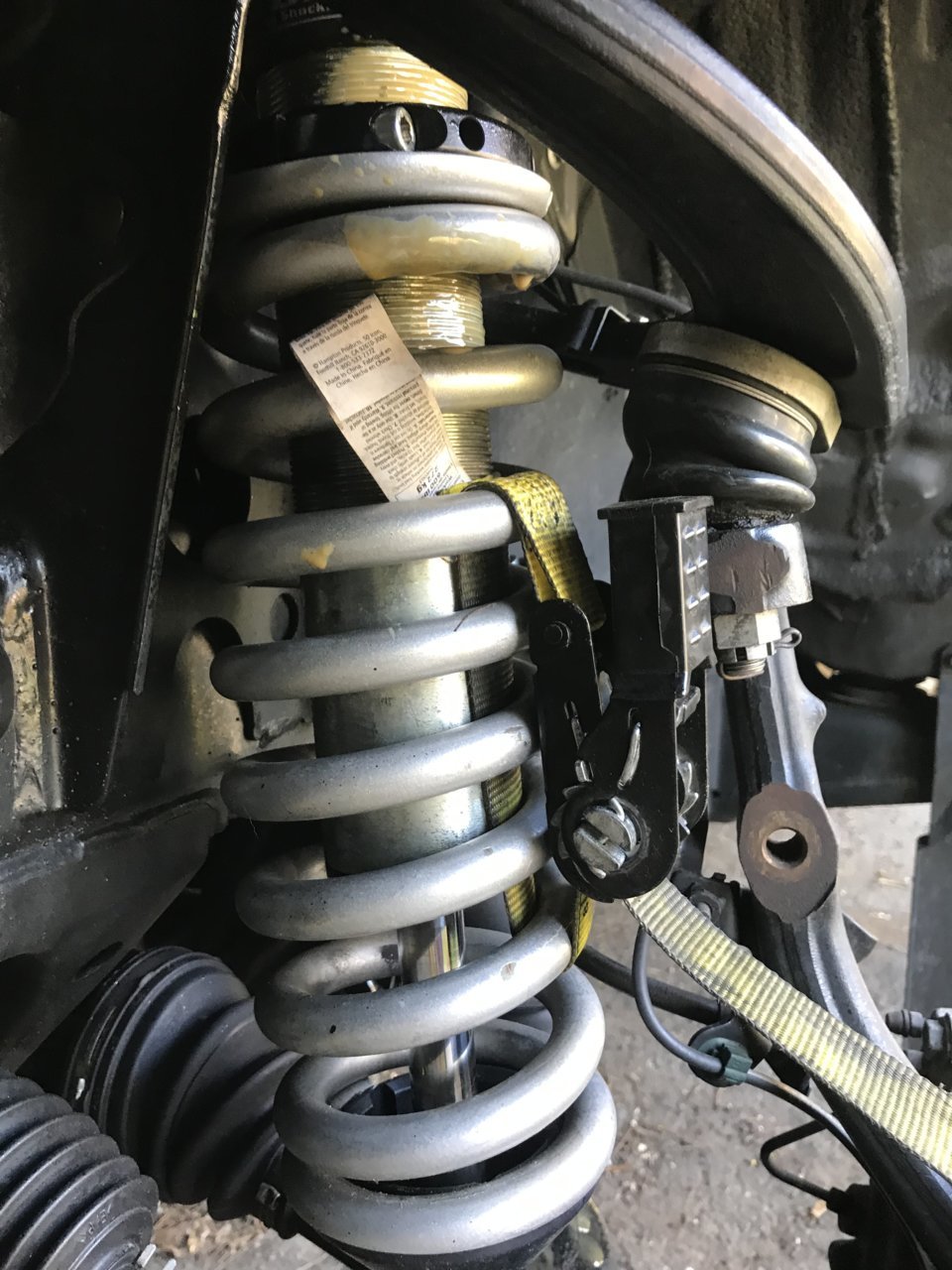

    FC9A9C63-369B-4C3D-A93C-822E9EDD4DDE.jpg 26CD9008-FF54-40EE-A7DA-9B53DD25D27D.jpg I know some people were having issues adjusting the preload with the front coil overs. I gave it a shot tonight and was able to get it done by lifting the front of the truck, adding a bunch of fluid film to the threads and using a punch to turn the coupling. I also used a ratchet strap around the springs to act as a spring compressor. Worked pretty well.

    Good idea with the strap, but why did you use fluid film vs something like WD40, just curious

    No reason other than it was handy. I’m sure any common lubricant would work.

    Those threads are protected now lol. My only concern was that it would solidify into a gummy like hardness

    He has clicker you have to adjust the 90* fitting on the clickers otherwise you have a twisted hose.

    How much preload were you able to get with this method?

    I have a little more than 1 inch of threads showing. I have the 650 lb springs and I could have gone more but this got me to where I wanted the truck to sit. When I checked my 2nd gen was at 23 inches from fender to center of hub and I have full set of skids, sliders, plate bumper and winch.

    Yeah, I wiped it down after.

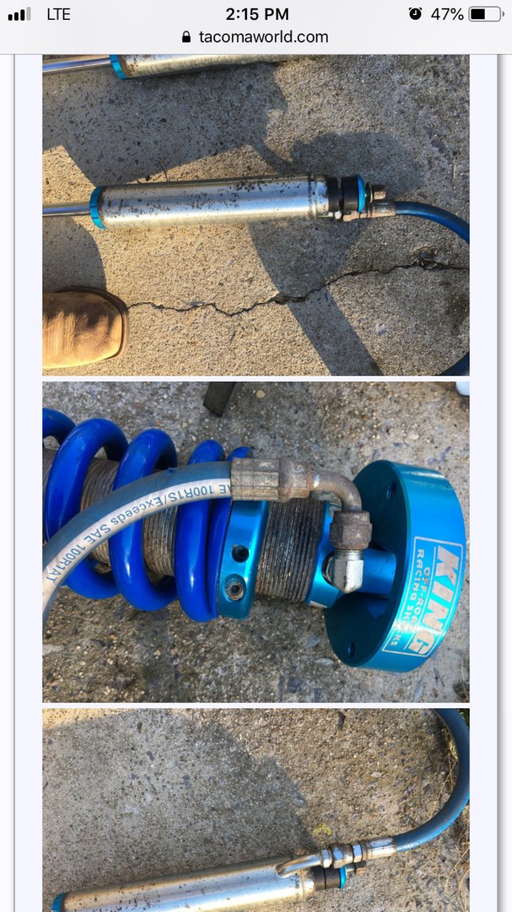

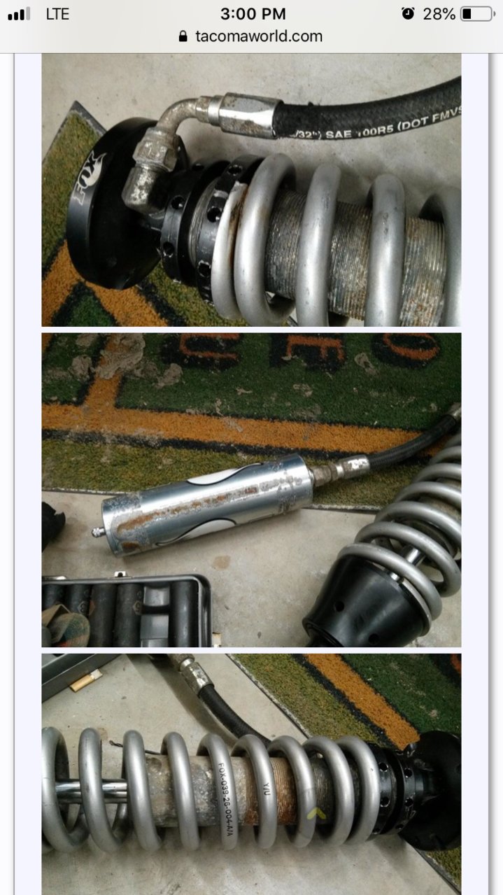

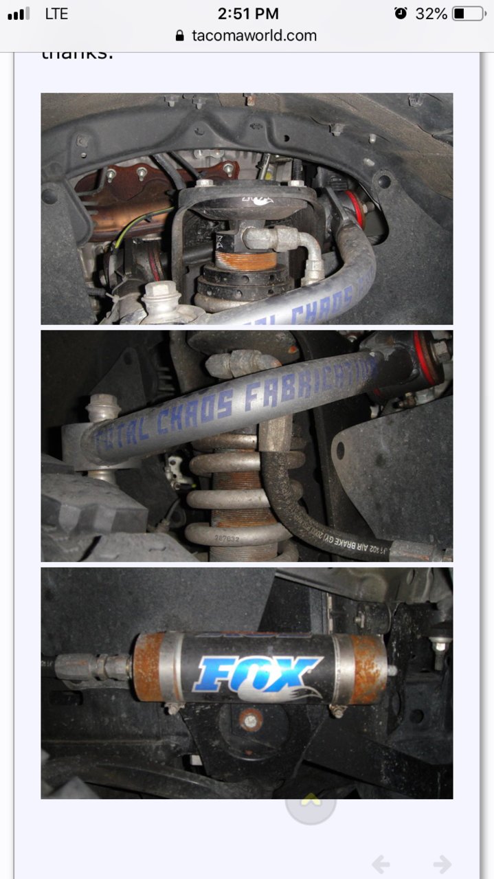

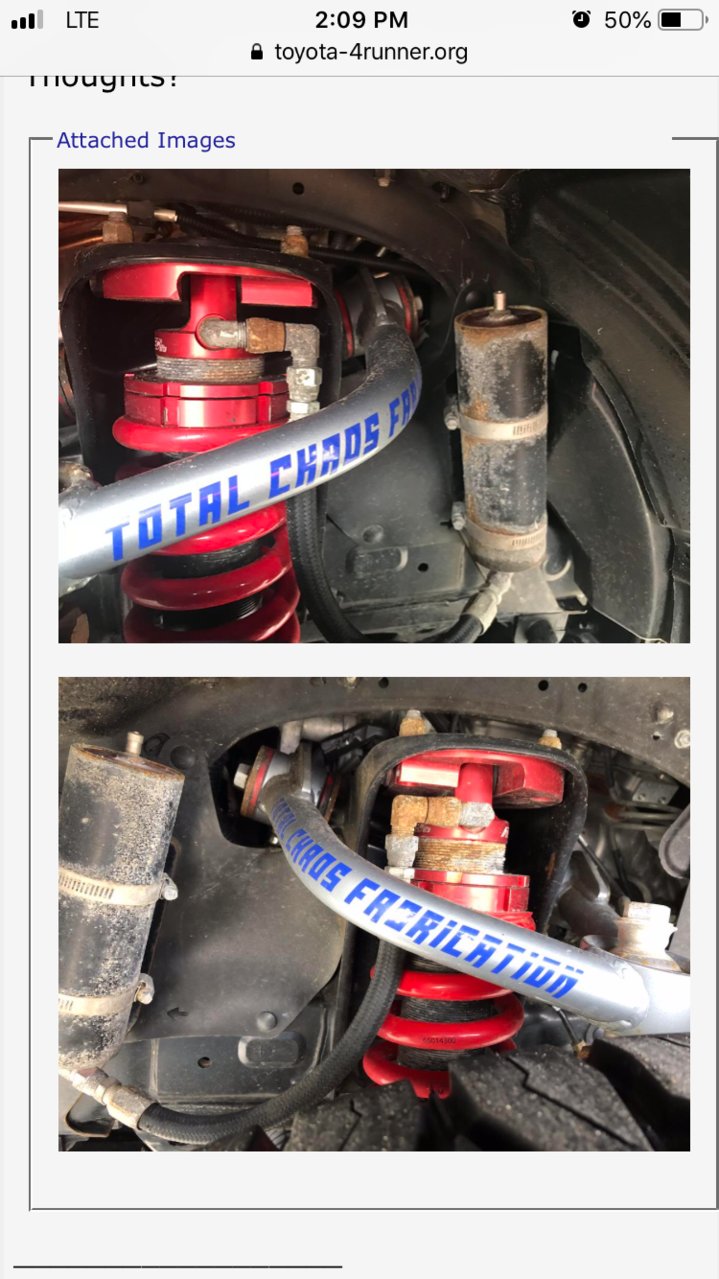

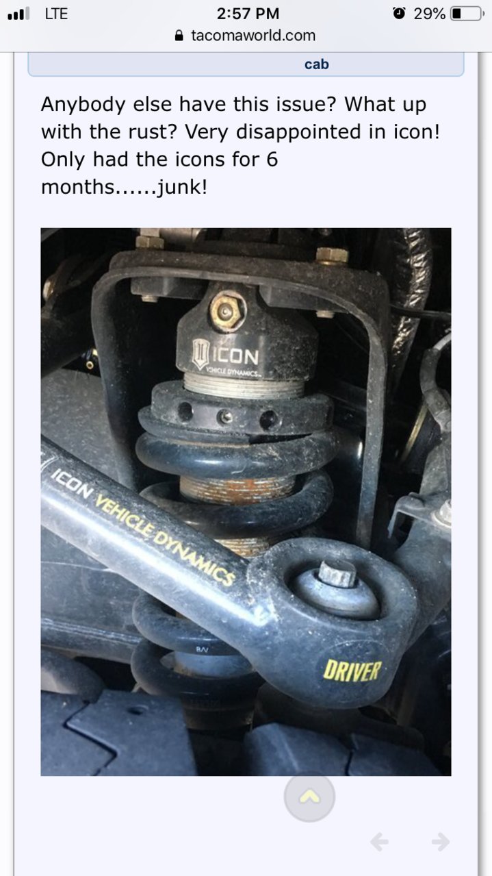

    How close to the ocean/ bay do you live and drive?
    Sorry you lost the bling factor but that oxidation doesn’t affect the performance in any way. Much better than harmful orange rust and looks to be on par, if not better than other brands.
    3 months
    6 months
    6 months
    1 year
    I also used fluid film and feel like it did more harm than good. All the salt would stick to it and fluid film could possibly cause some kind of reaction.
    Mine look worse than yours but they have seen 4 winters where roads become white from the dry salt and they have about 70K miles. They r way past due for a rebuild but still ride good and no leaks.
    A little wire wheel will shine them up again but the corrosion will return faster without new protective coating.

    4 months on my truck less then a mile from the ocean and mine still look really good.
