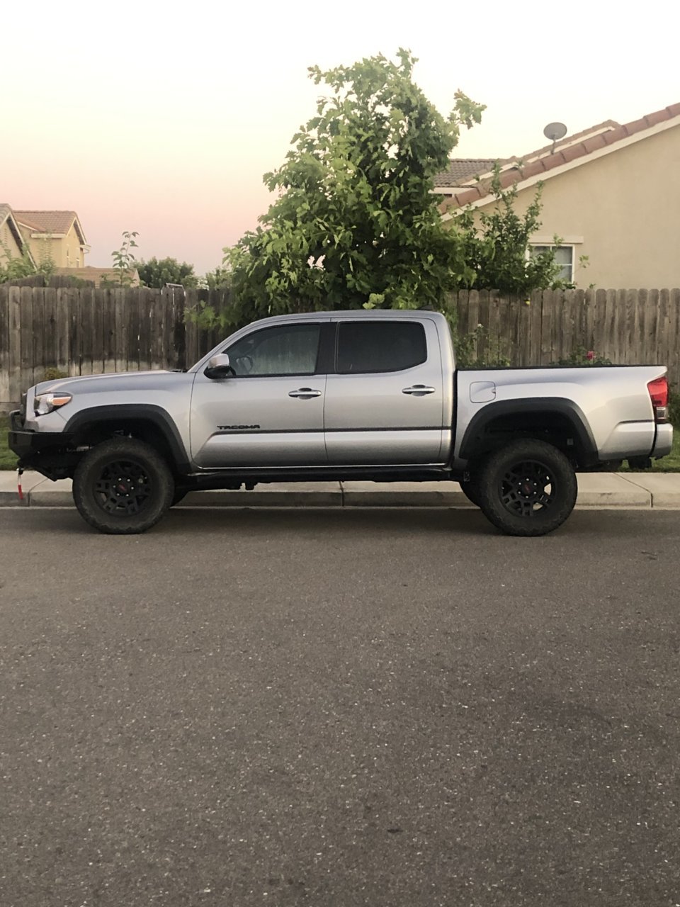

    So I should be fine adding 2” then? Is it going to change anything? I keep hearing that. I have a punch set on stand by. They are new so I’m hoping they won’t be seized up too bad.
    Right now I’m at 21.5 in the front and 24 in the rear. If I could get two more inches out of the front, I would be really happy. This is where she’s at right now. C9BEFC45-6DD1-4FFC-ACA3-2D576B1DE97B.jpg

    In all honesty though, your truck looks great as is.
    Silver rocks!

    I’m planning to remove it from the truck and compress the spring. I will definitely start with 1” of preload then.
    That looks really good. I love the way it looks, just that 2.5” of rake bothers me. Getting ready for 285’s.

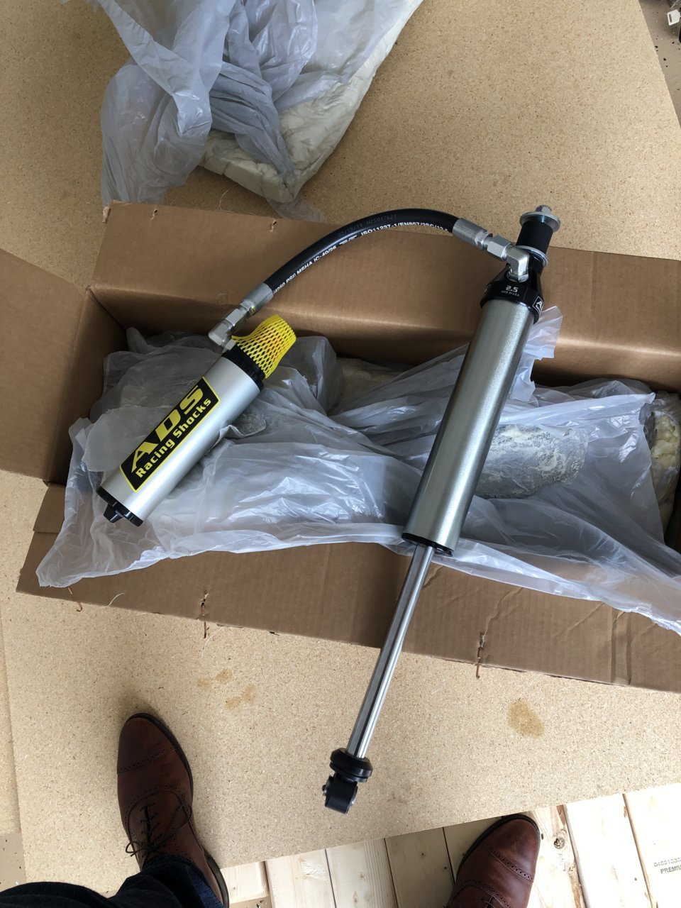

    This is the first aftermarket suspension I’ve ever purchased for one of my vehicles. I don’t think I’ll be disappointed
