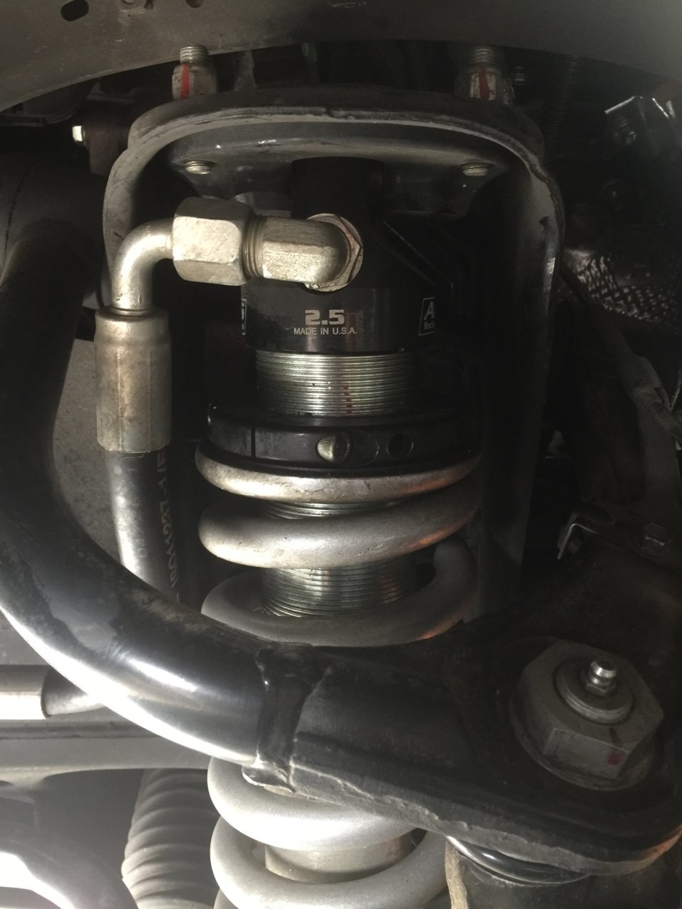

    1st measurement (driver side)
    3.5” of droop measured
    22.375” sitting at fender
    25.625” drooped at fender
    2nd measurement (passenger side)
    2.375” of droop measured
    23” sitting
    25.375” drooped
    why are the measurements so different?...weird
    Tayriva and sd1uh8as like this.

    Question for you. When you let the front droop, does it seem like the driver drops more than the passenger?

    You have an inch difference per side, time to start double checking your measurements or your truck is not level by 5/8 of an inch.
    Are your fenders cut?
    Anything binding on droop? Sway bar, CV's, steering?
    The Pass side is normal measurements for 2nd gen, 120/150.

    No cut fenders. No binding. May check with sway bar off. Don’t think garage could be downhill 5/8” to the passenger but it’s possible
