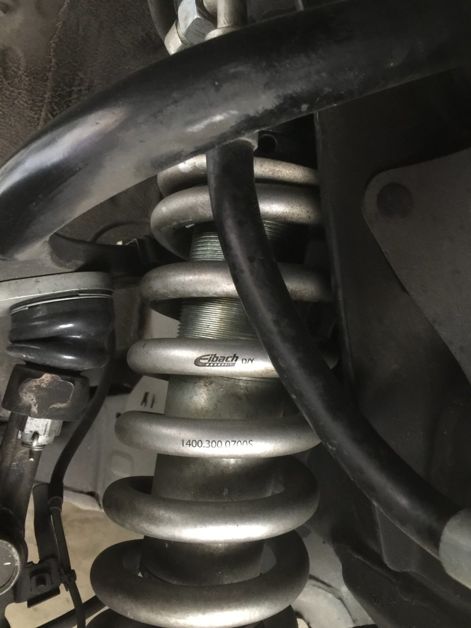

    Ohhh...OME coils. Well all I’ve run are the 888’s which are 590#, but preloaded to high heaven in the OME setups which was harsher. 10x than my 700#. What shocks are you pairing with those coils?

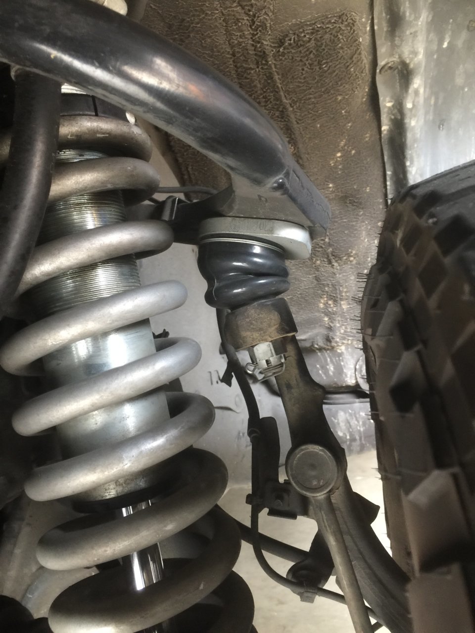

    Yeah, front passenger sounds like a rusted out box spring. It’s not leaning, think it may just be the heim joint at the bottom.
    Gonna pull it off when we get back from Ocean City. We actually might be up in Dewey next week.
