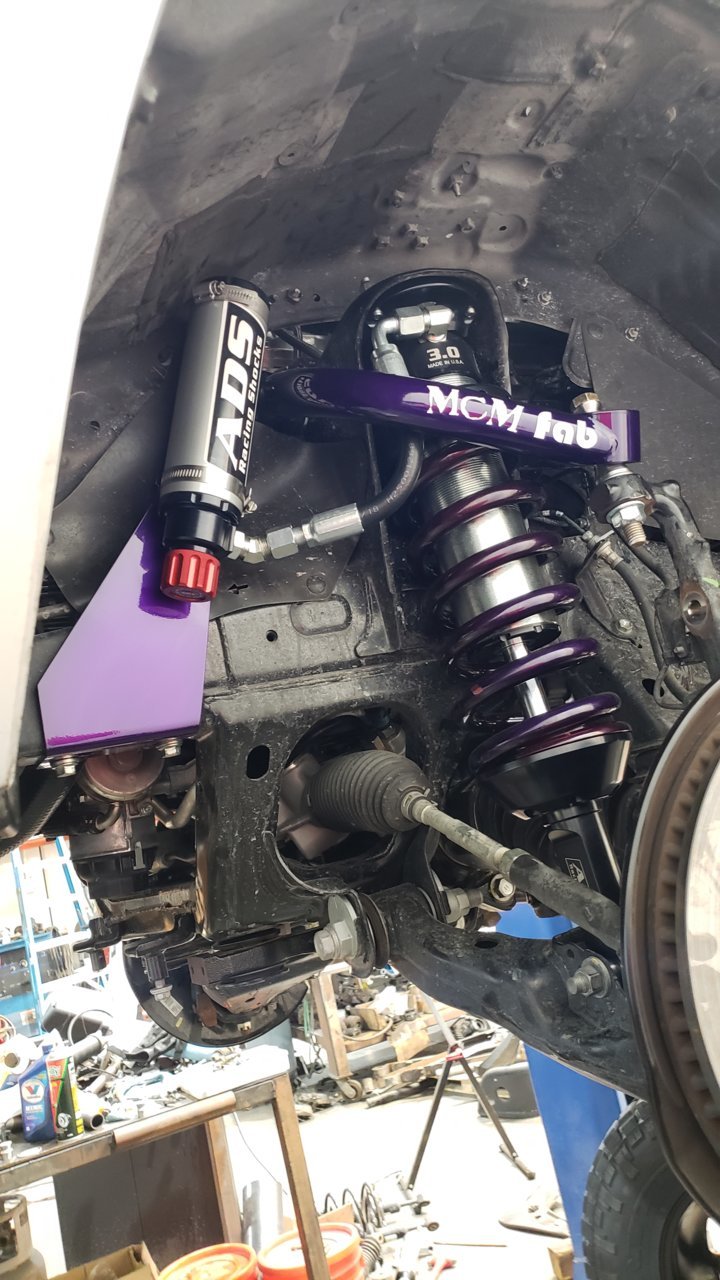

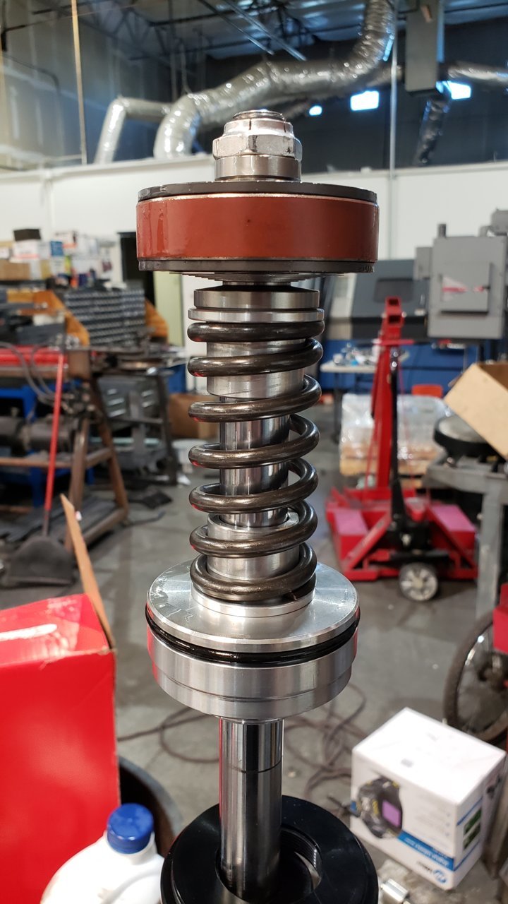

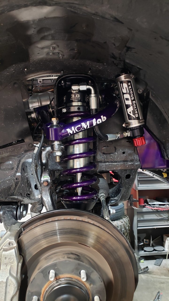

    Finally got around to building a set of 3.0 Coilovers for the wife's 4runner. Everything fits perfect and stuffed some 285/75/17s on there. We are also trying out a new top out spring to help keep the shocks from making as much noise when they hit full extension under hard use, especially when your pushing the lift height and have limited down travel.

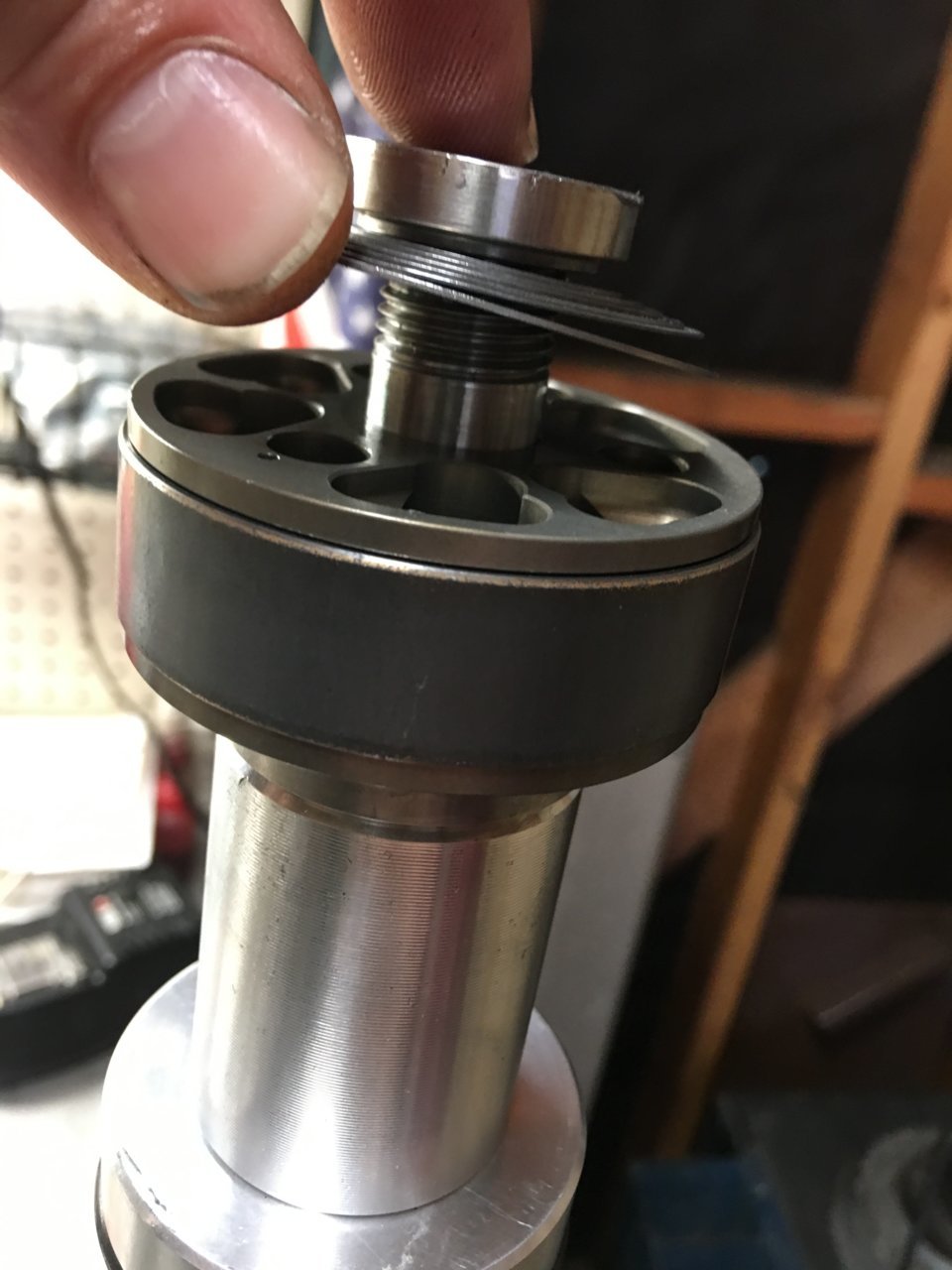

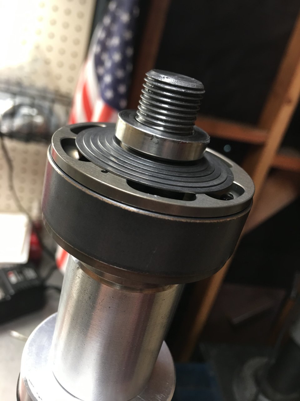

    For the sake of the conversation, the ADS I’m currently working on are not digressive on rebound... :rolleyes:
