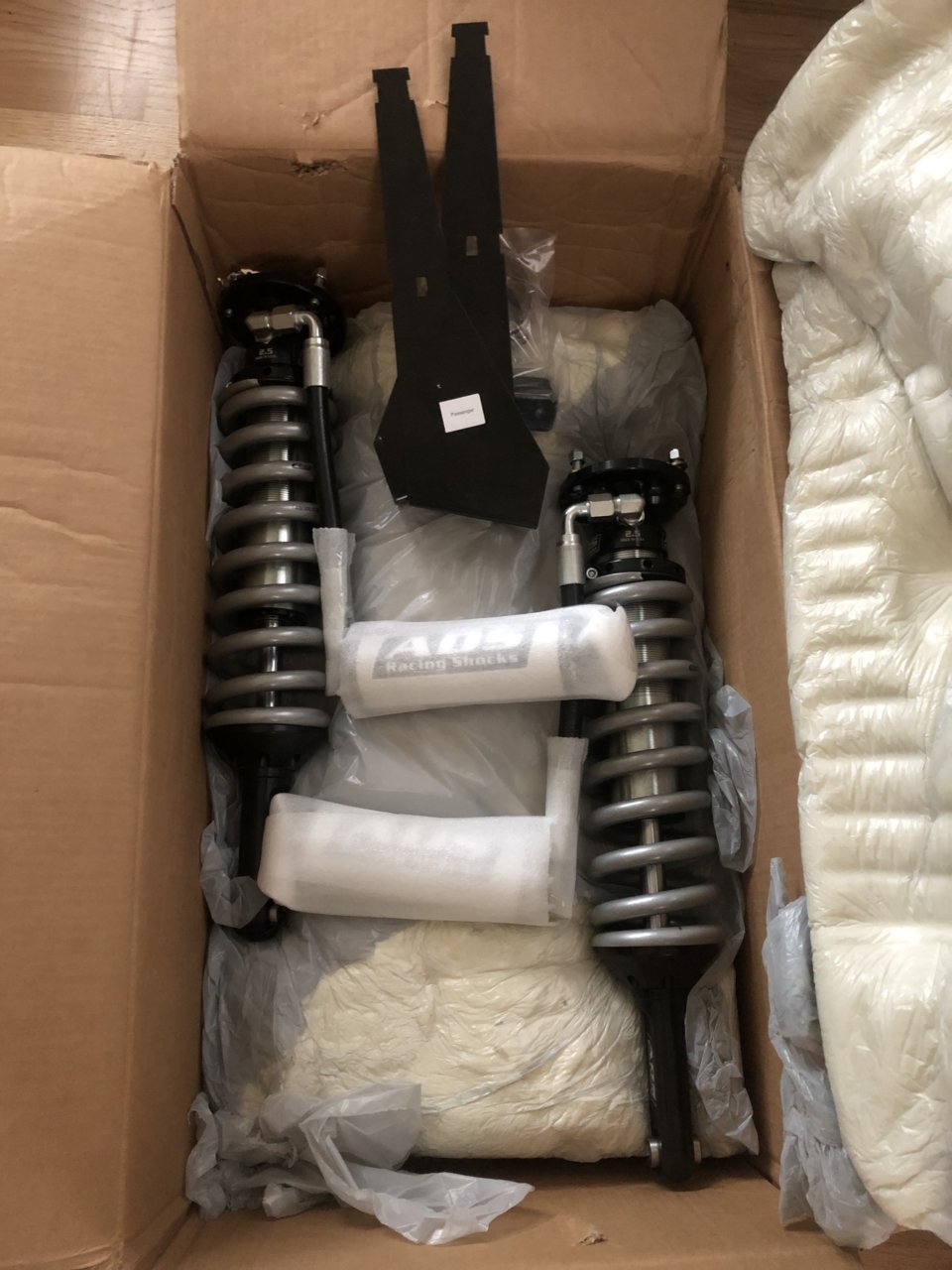

    C99925CF-F75D-4FE5-B5B2-C53E3047202D.jpg Finally joining you guys. Hopefully installing this weekend. 2.5 ext w/ remote resi and 700lb

    Are those black brackets the resi mounts? They look different

    Thats what i thought? Did they change the bracket?
