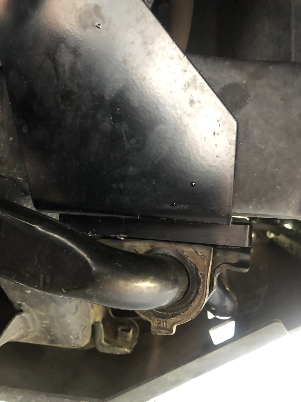

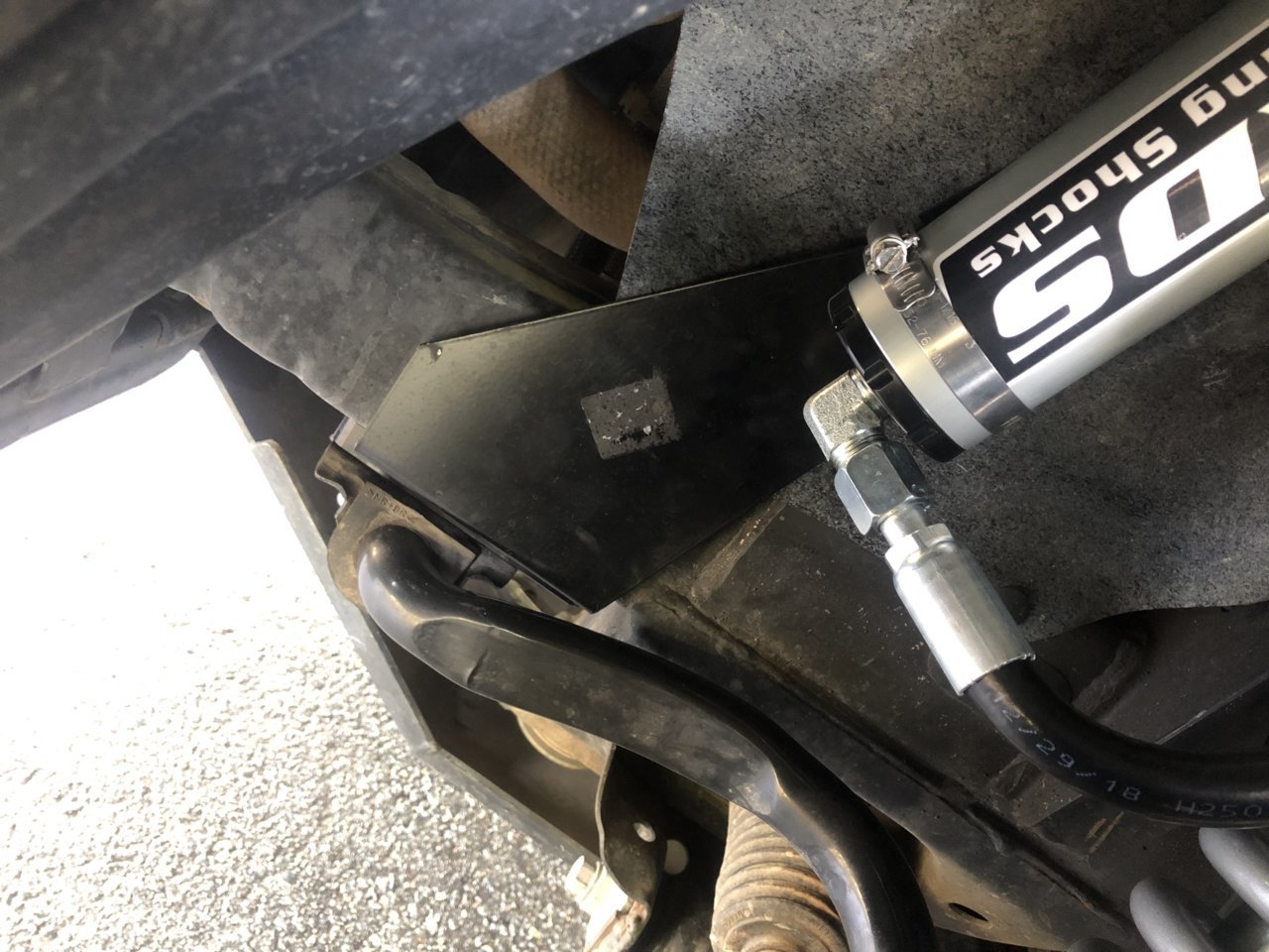

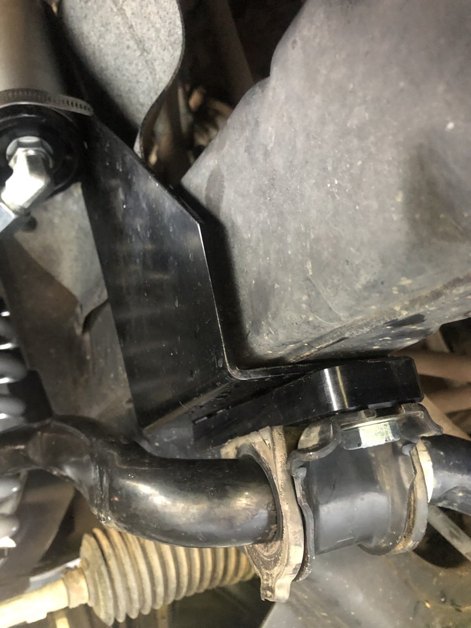

    Just to be clear the resi bracket goes above the sway bar mount and against the frame?
    Or below mount for more clearance to clear hose and coils/ UCA ?

    My application required it went below the sway bar bracket, further from the frame.
    According to @M C M this is incorrect but it is how it worked for me. If you can, install it against the frame and then mount the sway bar adapter and sway bar.

    Did you reuse your sway bar bolts or use the provided bolts? They don’t seem to belong enough for sway bar bracket or spacer to fit with bracket?

    Oof, good question. I think I used the original bolts to mount the sway bar bracket to the frame then used the new bolts to mount the resi brackets.
    Could be wrong, it’s been a month.

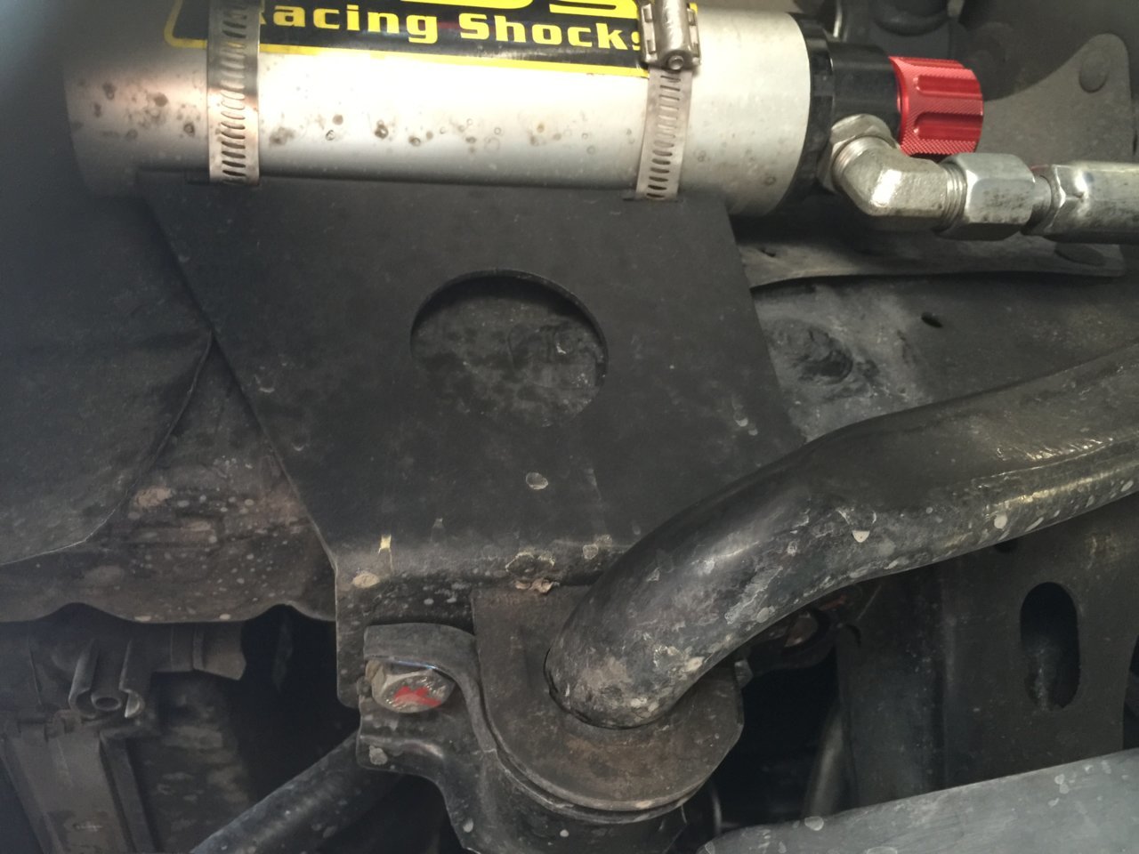

    Resi mount driverside

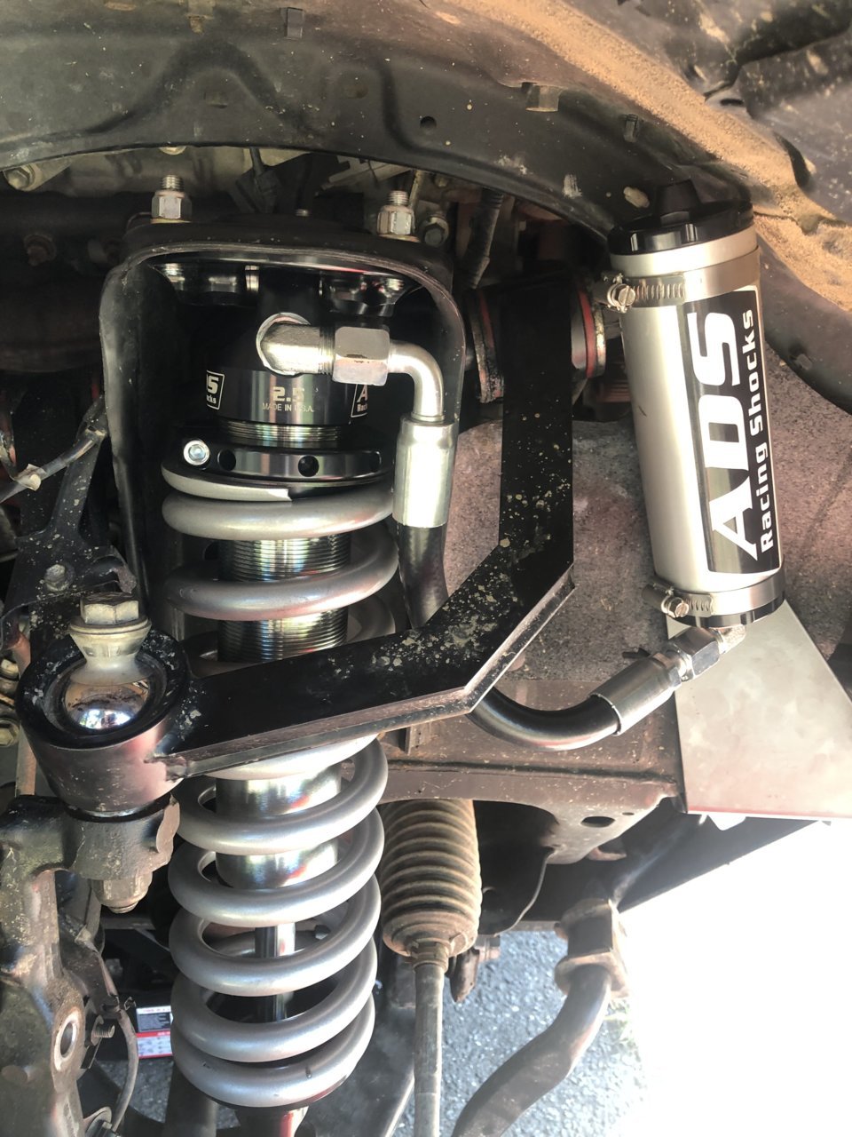

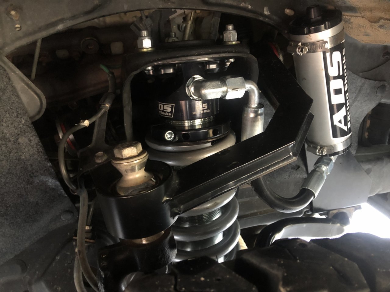

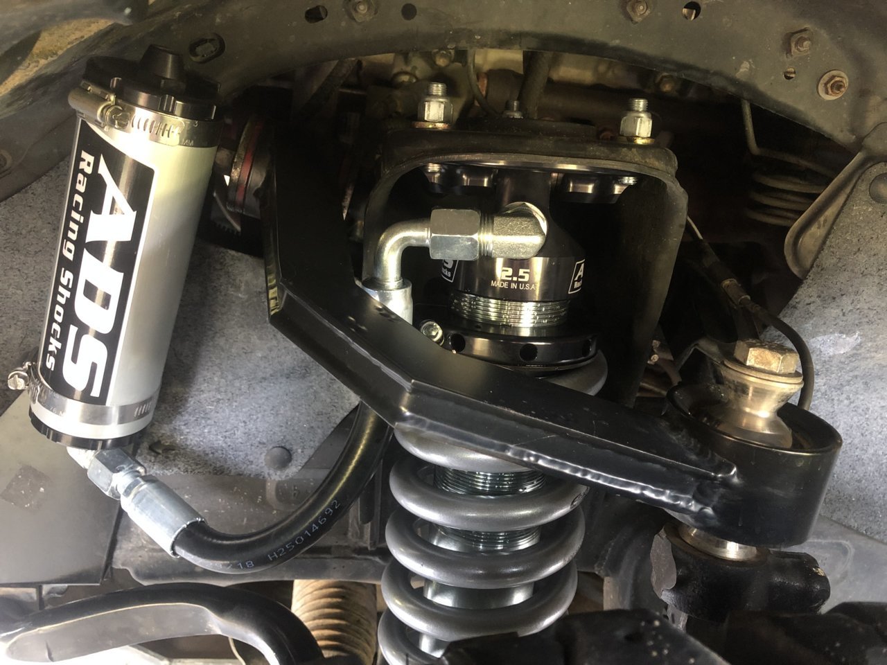

    5E5B8E02-B0AD-4811-BEE8-20074A316ABF.jpg 3ECAD8AC-644E-4514-9453-8E94396C8AEC.jpg So got them mounted and hoses and resi figured out. sway bar reinstalled with bracket against frame. Test drive was fine. Might come up a little bit on both sides but so far clears everything and much better cv angles. Not sure if i like The sway bar and might remove it later. Gotta grab a punch so i can Adjust them and might get an alignment but so far it tracks just like it did before.

    What UCA's are you running ?

    Dirt king boxed style. They have been quiet and maintenance free since i got them.
