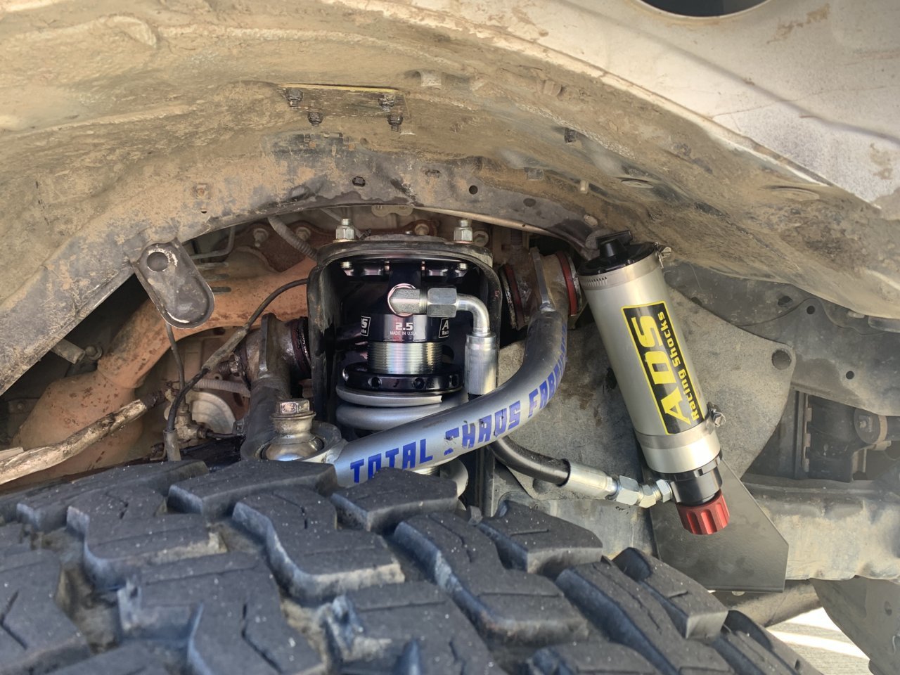

    Spent an hour at the shop last night and installed them
    And temp adjusted them at work today
    1 1/8 on the driver side
    Just under an inch on the passenger
    ready6delta and TACOVRD like this.

    Wow those new resi mounts are way different. Similar to King
    ready6delta likes this.
