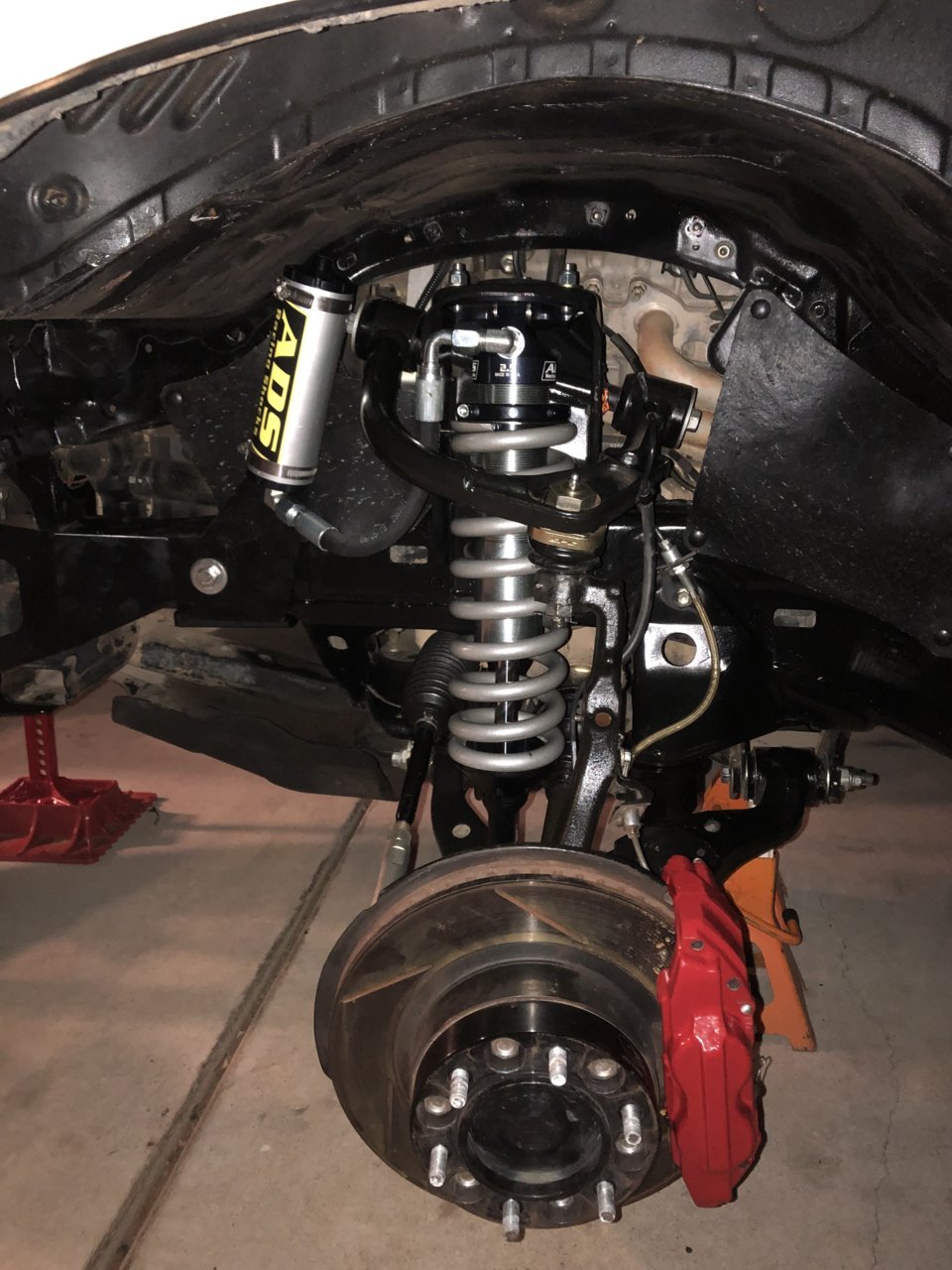

    Got the driver side suspension swapped out. The UCA bolt always makes for an interesting time...

    Just curious...do the front of your resis rub on that plastic and make a squeaky sound? (The part toward the front of the truck)

    Not sure yet. Just installed it today. If it does I’ll probably just trim the plastic.

    If it does you could always just take a utility blade or any sharp knife and cut away a small bit. Gets rid of the sound and doesn't affect anything with the slightest bit of importance.

    I think my problem is that I mounted the resi mount under the sway bar relocate bracket instead of against the frame...
