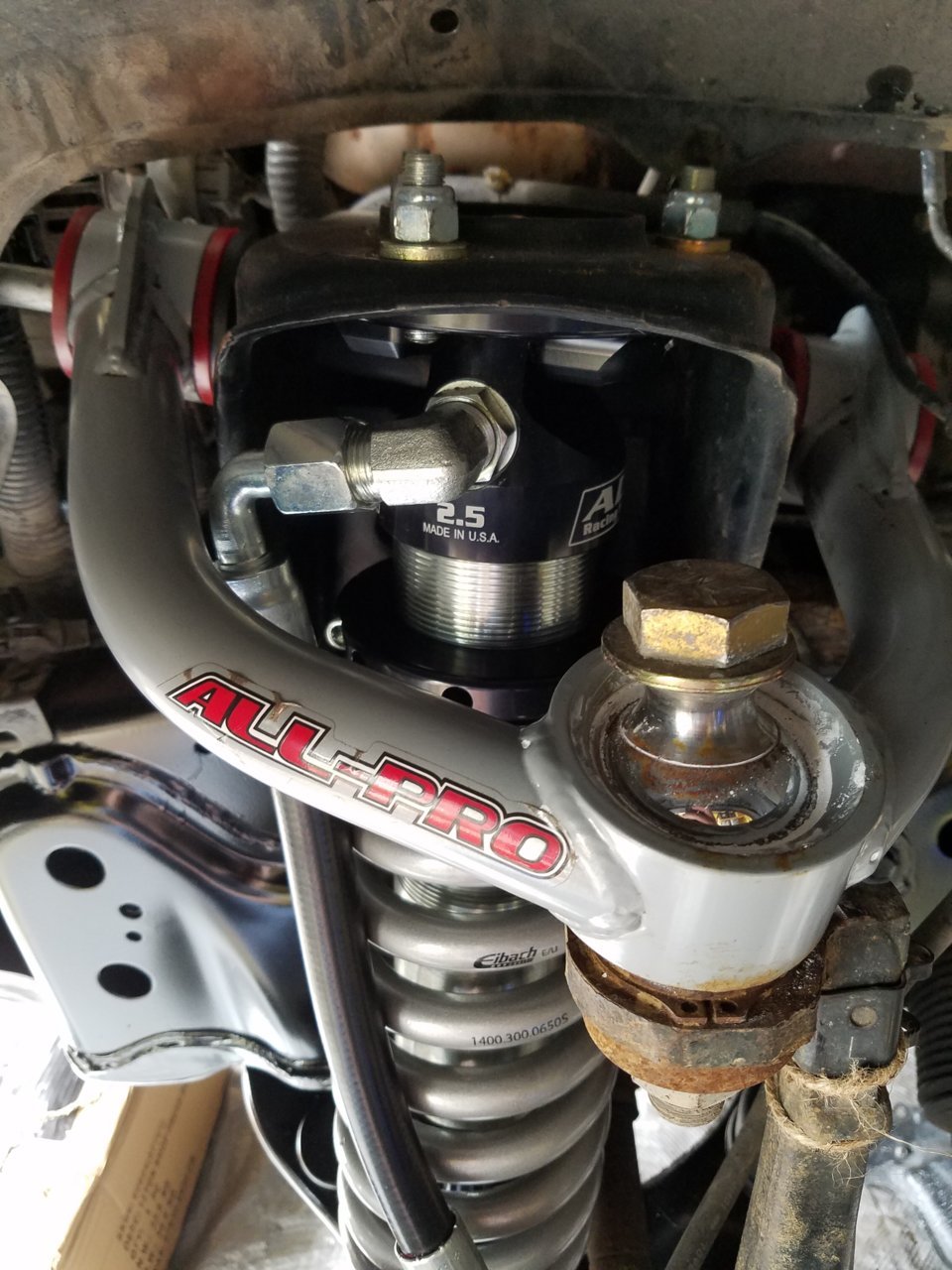

    On a 3rd gen 4Runner or your 3rd gen Tacoma? You understand that they have different setups, right?

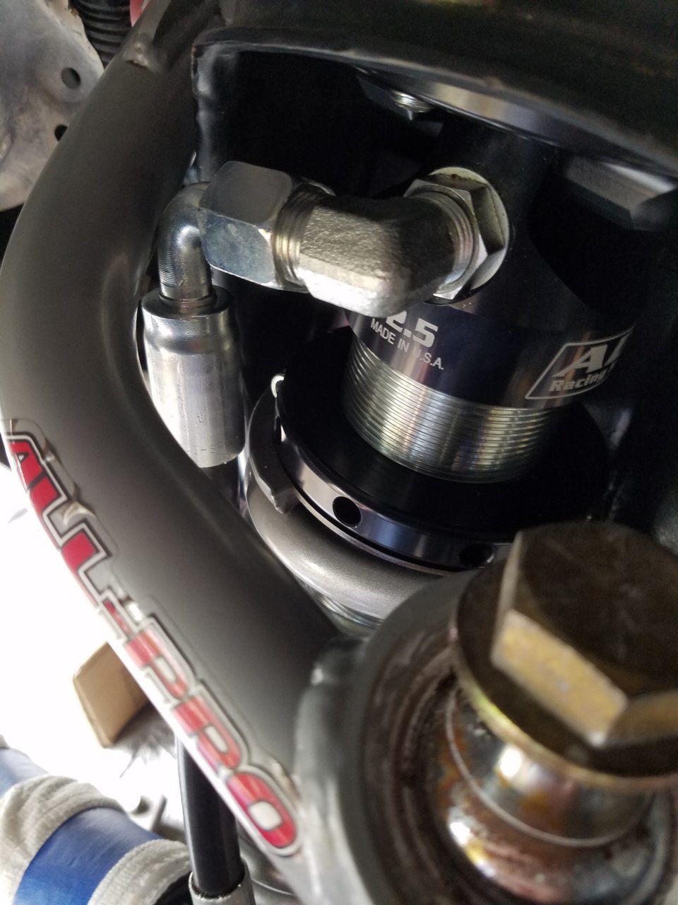

    I can't tell exactly from your pic, but looks like those may be 1st gen taco tophats, and not 3rd gen runner. They're clocked slightly different, otherwise identical.
    Can you take a pic straight on from the side?

    I can get a better picture than this if you need it. I ended up pulling them back off until I can figure out what I need to make them work.

    Yeah, those are 1st gen taco tophats. You need new tophats for your 3rd gen T4r. It will rotate it so the resi fitting is straight out.

    Boom, problem sorta solved.

    Well thats really good to know! Ill give ADS a call this week and see if they can send me the correct ones. Thank you so much for the info!
    Ya much cheaper than having to buy all new UCAs.
